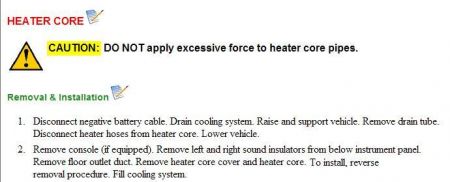

Heater problem
1997 Pontiac Grand Am 4 cyl Two Wheel Drive Manual
How do you get to the heater core
Wednesday, February 24th, 2010 AT 12:29 PM
BLUELIGHTNIN6
MECHANIC
16,542 POSTS
SPONSORED LINKS
+1
Wednesday, February 24th, 2010 AT 1:20 PM
