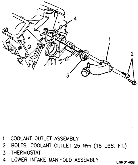

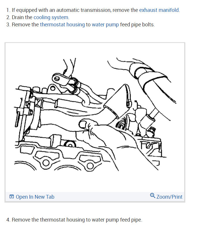

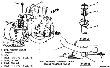

1996 Pontiac Grand Am SE 2.4L Quad 4: Im trying to find the location of the thermostat. Ive gotten a "bible" for the car but I covers a lot of different make and models of cars and so I got confused on the location. Also whats the proceedure on changing it?

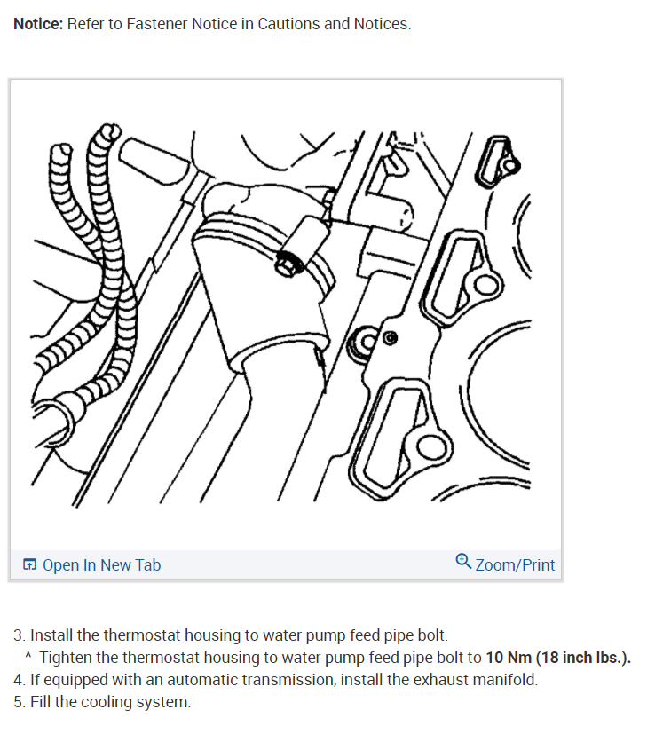

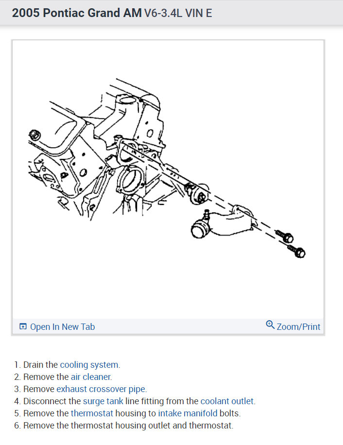

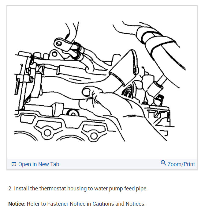

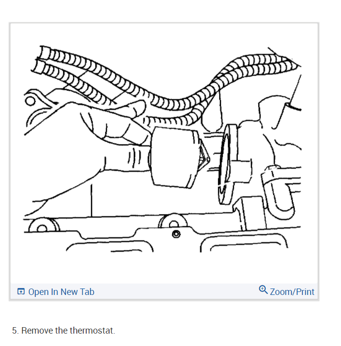

Here is a guide to help you step by step with instructions in the diagrams below to show you how on your car.

How do I change the thermostat on a 1995 pontiac grandam
Wednesday, December 9th, 2020 AT 11:29 AM (Merged)
  • 75,992 POSTS

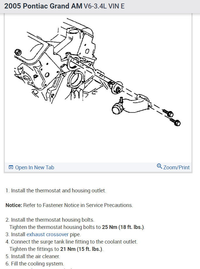

REMOVAL
1. Negative battery cable.
2. Drain and recover the coolant.
3. Air clearer assembly.
4. Surge tank line from coolant outlet.
5. Coolant outlet to inlet manifold attaching bolts.
6. Coolant outlet.
7. Thermostat.
Clean
*Inlet manifold mating surfaces.
*Coolant outlet mating surfaces.
INSTALLATION
1. Thermostat in inlet manifold.
2. Coolant outlet to inlet manifold.
3. Attaching bolts.
Tighten
*Tighten to 25 Nm (18 ft. Lbs.).
4. Air cleaner assembly.
5. Surge tank line to coolant outlet.
6. Engine coolant.
7. Negative battery cable.
Inspect
*Check for leaks.

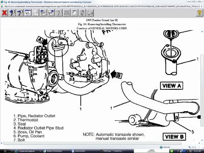

1995 Pontiac Grand Am 4 cyl Two Wheel Drive Automatic
where is the thermostat located
Wednesday, December 9th, 2020 AT 11:30 AM (Merged)
  • 75,992 POSTS
See diagram below:
https://www.2carpros.com/forum/automotive_pictures/12900_t_10.jpg

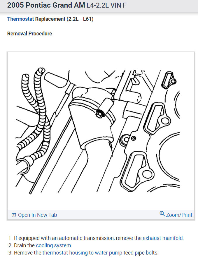

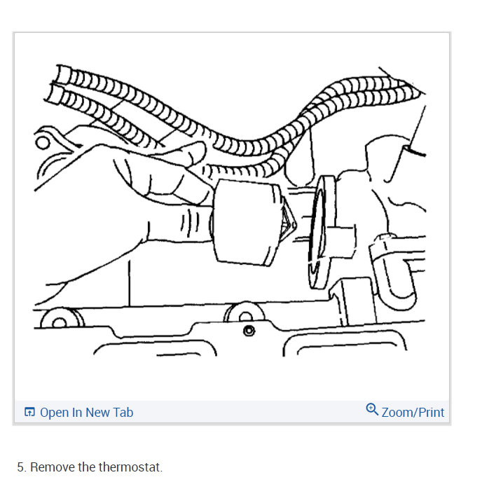

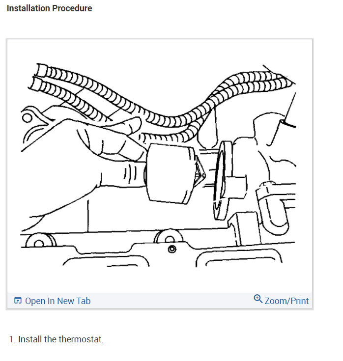

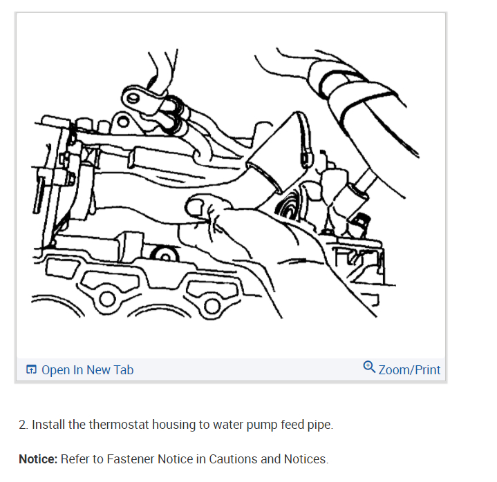

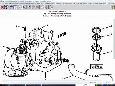

I have a 1995 Pontiac Grand Am SE with a 2.3L DOHC. I have been having problem with it occasionally overheating and want to replace the thermostat. I have checked several websites as to the wereabouts of the thermostat with no success! One website says that I have to remove the waterpump and another said to remove the exhaust manifold! I am totally frustrated and need to fix this problem. I have the mechanical capabilities to do it myself but I need the answer to this question. Any help will be greatly appreciated! Thanks!
MERLIN2021
  • 17,250 POSTS
Here's how and where...
https://www.2carpros.com/forum/automotive_pictures/62217_TStat4cyl_1.jpg
https://www.2carpros.com/forum/automotive_pictures/62217_TStat4cylb_1.jpg

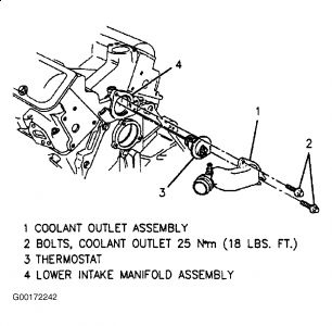

GOLDTOOF
  • 1994 PONTIAC GRAND AM
  • 6 CYL
  • 2WD
  • 158,000 MILES
How hard is it to replace the thermostat and thermostat housing on a 1994 pontiac grand am se/gt? Also if undertaking this job are there any specialty tools I will need or is there any unexpected problems that may arise that I should know about? I'm fairly good with cars but i've never done this its for a friends car and i've seen mixed things about how easy or hard it is and that special tools aren't or are needed. The repair shop wants 390 for labor but the parts are both under 20 bucks.
Wednesday, December 9th, 2020 AT 11:31 AM (Merged)
DOCFIXIT
  • 18,828 POSTS
Thermo needs no special tools just drain coolant remove air cleaner and surge tank hose.
https://www.2carpros.com/forum/automotive_pictures/198357_Graphic_447.jpg
as for the $390 labor need to report to BBB it's a $90 job
