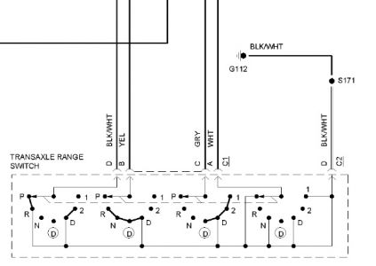

Hello again, sorry for just getting back I put a test light on the wires from the safety switch the only hot wire was a pink wire, what do you guy's think/ and happy belated birthday to your little princess.
Tuesday, October 5th, 2010 AT 8:27 PM
JDL
  • 16,098 POSTS
This is the diagram for the starter circuit. There maybe more wires at the neutral switch than the diagram shows. It shows only the starter circuit, that is the way these diagrams are. The yellow wire is hot with key in the crank position then the purple wire carries goes hot and carries voltage to the starter solenoid.
