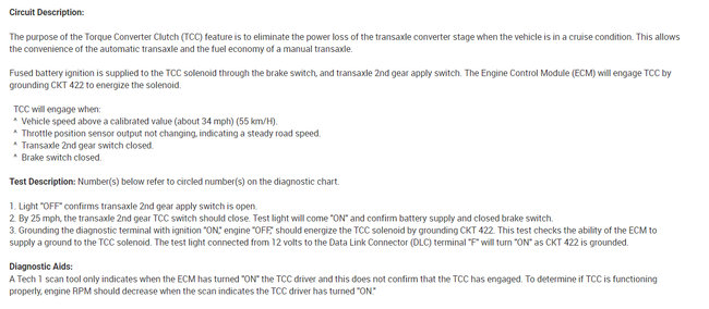

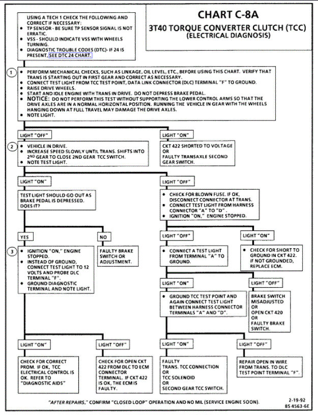

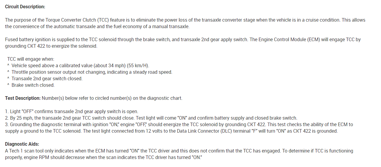

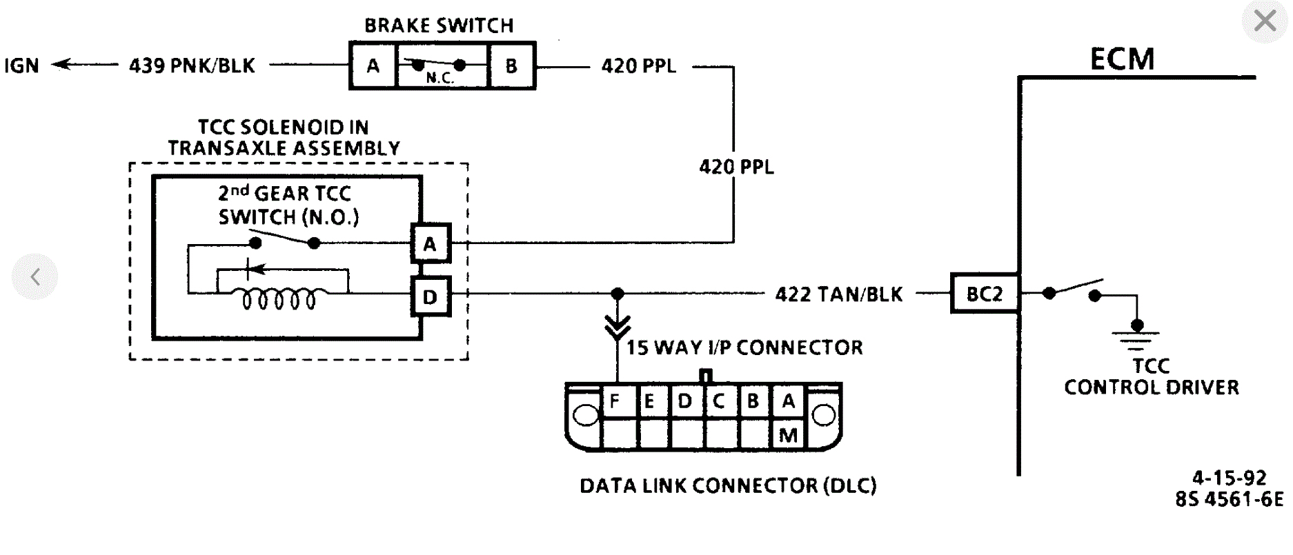

Since it is only happening after driving at highway speeds, I question if it is related to the converter clutch lockup solenoid. If it doesn't release, it would be like trying to stop a vehicle with a manual transmission without pressing the clutch.
Here is what I suggest. First, we need to check for diagnostic trouble codes which may lead us in the right direction. This vehicle has an OBD 1 system which doesn't require a scan tool to retrieve codes. All that is needed is a short jumper wire or even a paper clip. Follow the directions in the following link and let me know if and what codes are found.
https://www.2carpros.com/articles/buick-cadillac-chevy-gmc-oldsmobile-pontiac-gm-1983-1995-obd1-code-definitions-and-retrieval-method
Also, I attached the diagnostics to test the solenoid specific to your vehicle.
