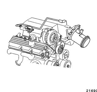

First, I would like to thank the tech "Cly" for answering my first question on where to find the MAF and MAP. I tried to give feedback but it did not let me put in a Five Star rating and then I couldn't get back in. QUESTION: On a 97 Firebird, 3.8L. V6, automatic, where do I find and how do I replace the "Evaporative Cannister Purge Solenoid?" A different tech told another person who had a problem that this part was not allowing vapors to be purged from the system. I have the same problem with pressure building in the gas tank. Vapors hiss out when I take the gas cap off. Thank you.

First off I'm glad I could help.... Ok for the location of that evap purge solenoid. You will find it right in front of the MAP sensor on the passanger side of the engine. I attatched a pic.
https://images.2carpros.com/forum/automotive_pictures/86485_21690_1.jpg
As for cleaning the Throttle body out I always use Carb Cleaner. It will not hurt anything in there. I would not do it on a hot engine as the carb cleaner is highly flamable. Sometimes I use a toothbrush and I hold the throttle plates open and clean off all the carbon from the plates and walls of the throttle body.(Do that with the motor off of course) Hope this helps Cly
