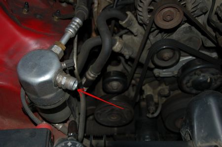

Like the one showed in the picture. Is it a special hose that can hold some pressure? Or can I use any hose? Thanks

Looks like the A/C High Pressure Line.

What kind of hose can I use? What kind of substitution will be OK? Since it is very expensive for the firebird part. Thanks

Look for an AC repair shop in your area they can make a hose or sell you one for about 1/2 the dealer.
