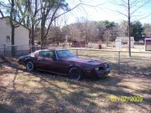

Sorry, it is a 78... off by 10 years. Still a nice car though and for only $900. It has a 305 and the engine still runs, but the trans is gone. Still want to put my drive train in it. I will conider the buy with possible parting out of my 95 to buy proper parts for the 78

Hi:
It's still a nice car. If the under carriage is as nice as the body looks, grab it and just have the trans fixed. I wasn't old enough to drive in 78, but I remember falling in love with these cars at a very young age.
Let me know how it works out for you.
