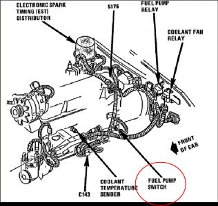

Hello - Simpimp From what I can see of your car.....nice looking and in good shape. Thanks for the info..... Let's see what we can do here...... First are you sure you are getting spark? Have you pulled a couple of plug wires and made sure you have a good hot blue spark? Next, I have attached a pic showing where the fuel/oil switch is. If this is defective it will not allow the car to start. Next, I have attached info on the fuel pressure. Sounds like you did a lot of work today...are you able to check the pressure?
https://images.2carpros.com/forum/automotive_pictures/248015_1_106.jpg
FUEL SYSTEM PRESSURE RELEASE 4 & 8 Cylinder Engines With engine Off, remove fuel pump fuse from fuse block. Start engine and allow to run until fuel supply is exhausted. Crank engine an additional 3 seconds to ensure fuel supply is exhausted. Install fuel pump fuse. On 4-112 and 4-121 overhead valve engines, install fuel pressure gauge between throttle body side of fuel filter at the rear of the car. On 4-151 engines, install fuel pressure gauge between TBI unit and steel fuel line. On V8 engines, install fuel gauge between front and rear TBI units steel fuel line. Start engine and observe fuel pressure. It should be 9 to 13 psi. Relieve fuel system pressure. Refer to steps 1 through 3 above. Remove fuel pressure gauge and reinstall fuel lines. Start engine and check for fuel leaks. FUEL SYSTEM PRESSURE TESTING Before servicing fuel system components, fuel system pressure must be released. To relieve pressure, proceed as follows: Remove fuel pump fuse from fuse block. Run engine until fuel remaining in lines is consumed. When engine shuts down, engage starter for approximately three seconds to relieve any remaining pressure. With ignition off, replace fuel pump fuse. Remove air cleaner and plug THERMAC vacuum port on throttle body unit. Remove fuel line between TBI unit and fuel filter or between front and rear TBI units on ``Crossfire'' injection systems. Use a suitable back-up wrench to hold flare nut on throttle body when removing line. Install fuel pressure gauge J-29658 or equivalent, between throttle body and filter or, on ``Crossfire'' systems, between front and rear TBI units. Check pressure reading with engine running. If fuel pressure is not between 9 and 13 psi, refer to ``Fuel System Diagnosis.'' De-pressurize fuel system, remove pressure gauge and reinstall fuel line. Start engine and check for fuel leaks. Remove plug from THERMAC vacuum port and install air cleaner.
