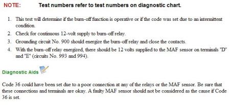

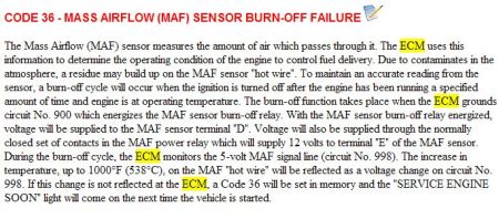

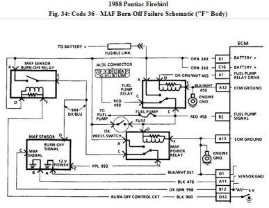

I wont have the chance to drop the tank till monday, I am now throwing an occasional code 32 and a code 36??? I know what 32 is-EGR, I can not find any info on a code 36 though. Someone also suggested that maybe the MAF is shot? Idk.
Apr 18, 2009 at 4:37 AM
JAMES W.
  • 2,394 POSTS

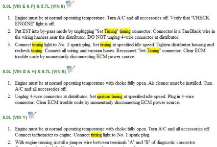

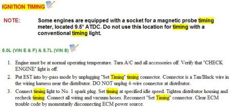

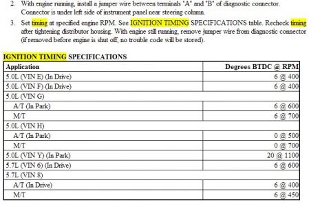

It could be a problem with the MAF, but thet're spendy, so we don't to blame it just yet. Take a look at the posted info and see what you think.
https://images.2carpros.com/forum/automotive_pictures/248092_firebird_1.jpg
https://images.2carpros.com/forum/automotive_pictures/248092_firebird_1_1.jpg
https://images.2carpros.com/forum/automotive_pictures/248092_firebird_2_1.jpg

It has been a frustrating day. We got the fuel pump pulled and the sock looks good, we replace the small bit of hose that connetected the pump to the line. That seemed to help the pressure a bit, we also adjusted the timing because it was off, set to about 3 or so. We set it to 6. Out of daylight and the car is even worse... I can barely run 65mph. Before I could at least hit 90, bit it would take a while.
Apr 19, 2009 at 12:24 PM
TRISTANB
  • 34 POSTS

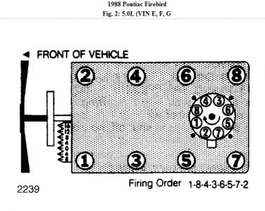

what is the timing supposed to be for this car? the badge isnt under the hood and I cant seem to find it online, the only thing I can find is people saying "usually 6" but with the way its running now that cant be right. I did make sure to unplug the auto advance in setting it and plugging it back in afterwards, it was a booger to start this morning and smoking a bit, looks like unburnt fuel?
Apr 20, 2009 at 4:55 AM
JAMES W.
  • 2,394 POSTS
How much slop do you have in your timing chain. Pontiacs are notorious for bad chains in this era. A retarded camshaft will do just what you describe.

so if the timing chain is worn and stretched it could have jumped a tooth or two and set the cam behind causing my symptoms? I'm guess is resetting the timing doesnt fix it then pull the cover and check the chain?
Apr 20, 2009 at 3:53 PM
JAMES W.
  • 2,394 POSTS
Usually, if a GMtiming chain gets so lose it can jump, it usually jumps so far, it won't even start let along run. But, the chain can be so worn that it retards the cam far enough to make them hard to get the spark timing set right.
You can check how much "slop" you have in the chain by turning the crankshaft back and forth. You'll be able to feel when you take up the slack and start to turn the cam. On a good chain, you should have very little free play in the crank movement.
