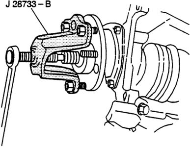

How to replace front wheel bearing assembly
Mar 5, 2009 at 6:01 AM
BLUELIGHTNIN6
  • 16,542 POSTS
REMOVAL: Remove or disconnect the following: NOTE Insert a drift punch through the caliper and into the rotor cooling fins to prevent the rotor from turning. Front wheel Halfshaft nut and washer Brake caliper Brake rotor Anti-Lock Brake System (ABS) speed sensor 3 hub/bearing assembly bolts Dust shield Hub/bearing assembly from the halfshaft, using a puller Hub/bearing assembly from the steering knuckle ((Use a puller such as J 28733-B to press the halfshaft from the hub assembly))
https://images.2carpros.com/forum/automotive_pictures/261618_0900c152802427d7_1.jpg
INSTALLATION: Install the hub/bearing assembly over the halfshaft splines. Be sure the splines engage smoothly. Apply a light coating of grease to the steering knuckle bore. Slide the hub assembly onto the halfshaft as far as possible. If the hub will not bottom out on the halfshaft, install the hub mounting bolts and use the halfshaft nut to draw the hub onto the halfshaft. Once the hub is flush with the steering knuckle, remove the mounting bolts and install the dust shield. Install or connect the following: Install the mounting bolts. Torque the bolts to 70 ft. lbs. (95 Nm). Place the transaxle in N. Install or connect the following: ABS front wheel speed sensor connector, and clip to the dust shield Brake rotor Caliper. Torque the halfshaft nut to 118 ft. lbs. (160 Nm) on models except Park Avenue. Install the front wheels. Torque the lug nuts to 100 ft. lbs. (140 Nm). Road test the vehicle. Thanks for using 2CarPros.com!
