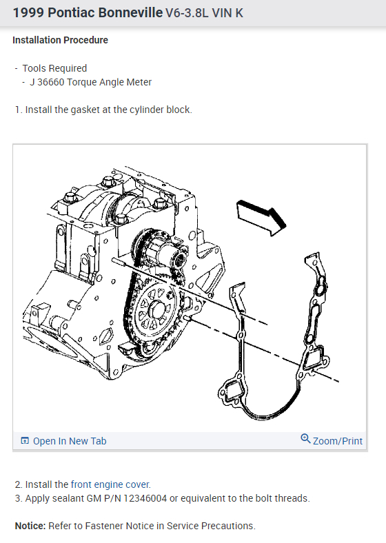

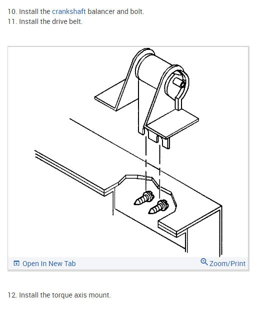

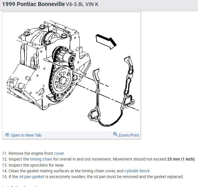

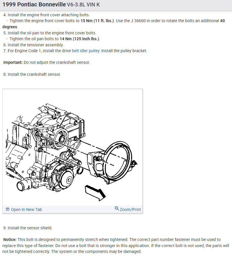

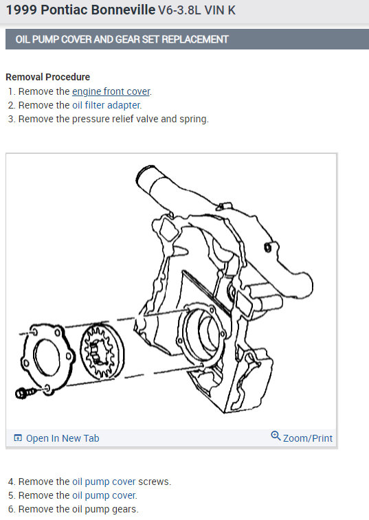

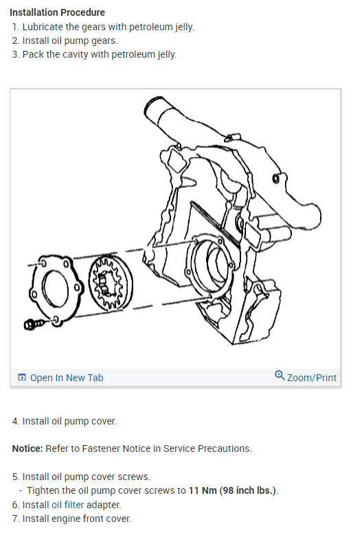

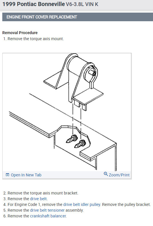

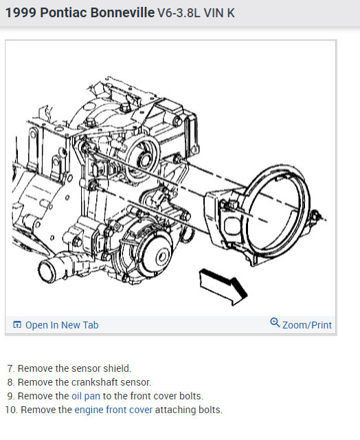

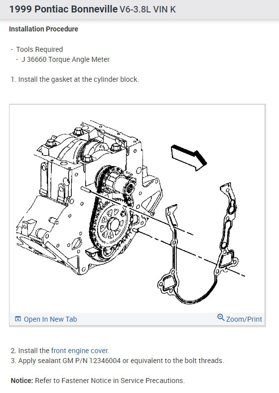

Can I get a picture of an oil pump kit and it's location?
Monday, April 26th, 2010 AT 4:41 PM
SQM
  • 6,383 POSTS
In order to replace the oil pump on this vehicle you will have to remove the engine front cove to get access. To do that you will have to remove the drive belt. Crankshaft pulley, belt tensioner assembly. Also the oil pan needs to be removed as well.
