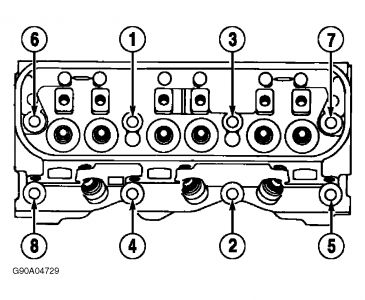

What is the torque sequence and specs for the the heads on a 95 Pontiac Bonneville 3.8 liter V6 motor without supercharger?

Torque in 3 steps
STEP 1 35 Ft. Lbs.
STEP 2 Additional 130 Degrees
STEP 3 (4 center bolts only) Additional 30 Degrees
