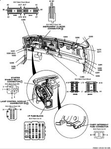

im trying to fix my 1994 pontiac bonneville because it wont start im pretty shure its the starter enable relay but i cant find it so if u could help me finding out whrere it is located i would greatly appreciate it.

1994 Pontiac Bonneville V6-3800 3.8L STARTER ENABLE RELAY System Locator: Theft Deterrent System
https://images.2carpros.com/forum/automotive_pictures/12900_s1_29.jpg
LH Side Of I/P, LH Side Of Steering Column
https://images.2carpros.com/forum/automotive_pictures/12900_s2_28.jpg
The Starter Enable Relay is located behind LH side of Instrument Panel (I/P), above I/P fuse block.
