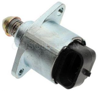

I have a 1993 Bonnevile with 150,000+ miles, 3800 engine. It started to stay between 2000 and 2500 rpm at idle, it only does this after the car has been driven for 15 to 20 miles. I checked the linkage, all good. Throttle is at the idle stop. Can you point me in the right direction on where to check next?

You may want to remove and clean the idle air control motor. Carbon build up does strange things like this. Are there any codes in the computer or a check engine light on?

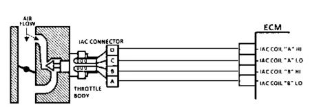

Right, at the throttle body more precisely. Getting codes would certainly help...
When the part is off, make sure the passageways are also clean. Get some good intake cleaner and spray it until it's clean. The pintle especially so it seals right.
https://www.2carpros.com/forum/automotive_pictures/30961_iac_3.jpg
https://www.2carpros.com/forum/automotive_pictures/30961_mitchel_12.jpg
https://www.2carpros.com/forum/automotive_pictures/30961_iac1_1.jpg
It wouldn't hurt to clean the throttle body and intake valves as well, but I doubt a relationship to your problem.
The egr valve may also have some carbon issues as well as it's passageways.
