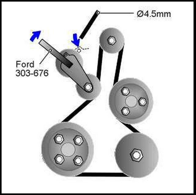

Hi colleagues, I have to change the Poly V belt of this car, can you send me the detailed steps? Thank you very much.

Your vehicle is a direct sister vehicle to the VW Sharan and Seat Alhambra. Fitted with the VAG group 1.9 PD diesel engine.
A good video:
https://youtu.be/hVCJjroPBGg
and
https://youtu.be/ex_ttYE4wAc
The belt layout is on image below.
Hope this helps.
Cheers, Boris
