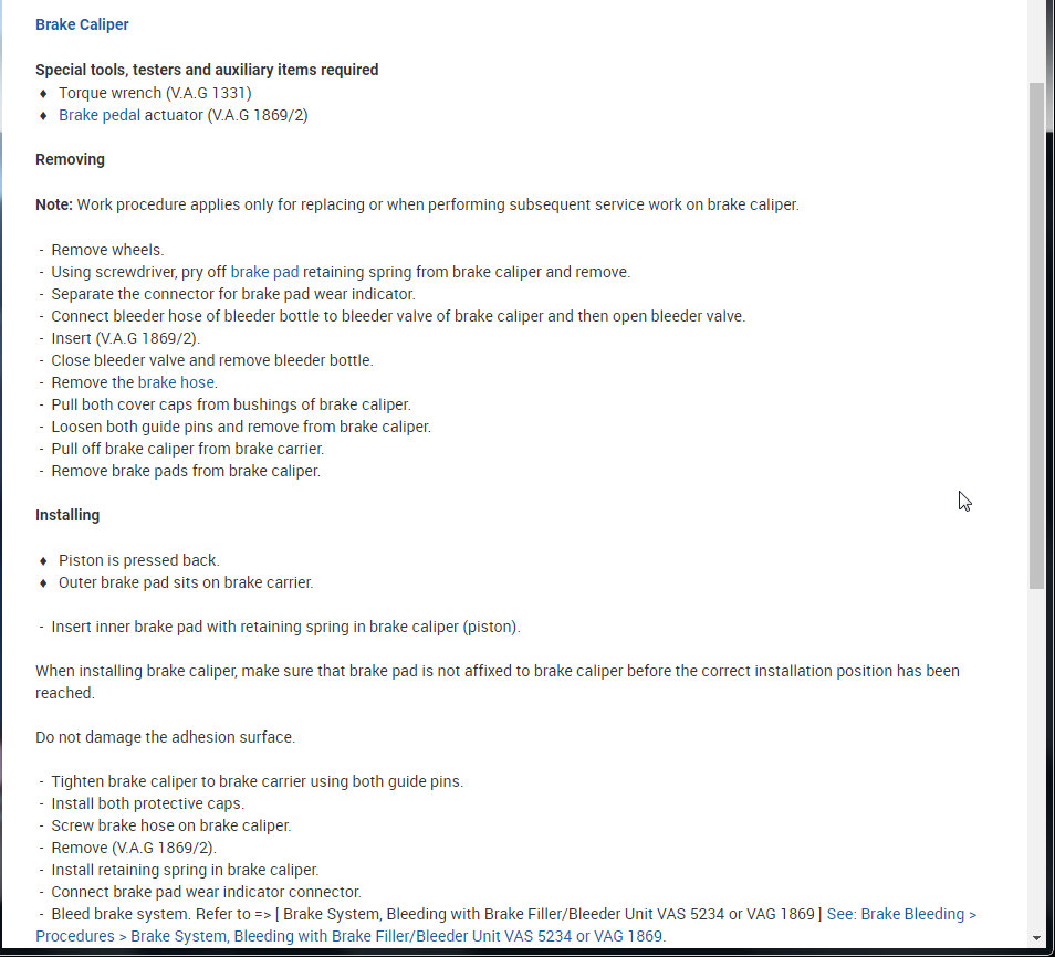

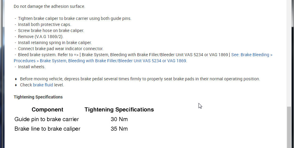

Here is some info on this process if you have to replace the calipers:
https://www.2carpros.com/articles/brake-caliper-replacement
Below is the process from the manual if you need this as well. Let us know what questions you have and we can go from there. Thanks
