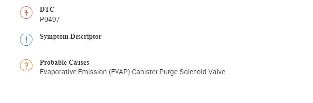

Good morning,
This code is for the canister purge valve. I attached the description and procedure for you at the bottom.
https://www.2carpros.com/articles/how-emission-control-systems-work
I see you replaced the valve. Do you have a scan tool that can see if the ECM is commanding the valve open?
As far as running rough, what have you done so far?
This DTC tests for proper intake manifold vacuum flow to the evaporative emission (EVAP) system. The control module opens the EVAP canister purge solenoid valve and closes the EVAP canister vent solenoid valve. The control module then monitors the fuel tank pressure (FTP) sensor to determine if a vacuum is being drawn on the EVAP system. If vacuum in the EVAP system is less than a predetermined value within a predetermined time, this DTC sets. The preceding table illustrates the relationship between the ON and OFF states, and the Open or Closed states of the EVAP canister purge and vent solenoid valves.

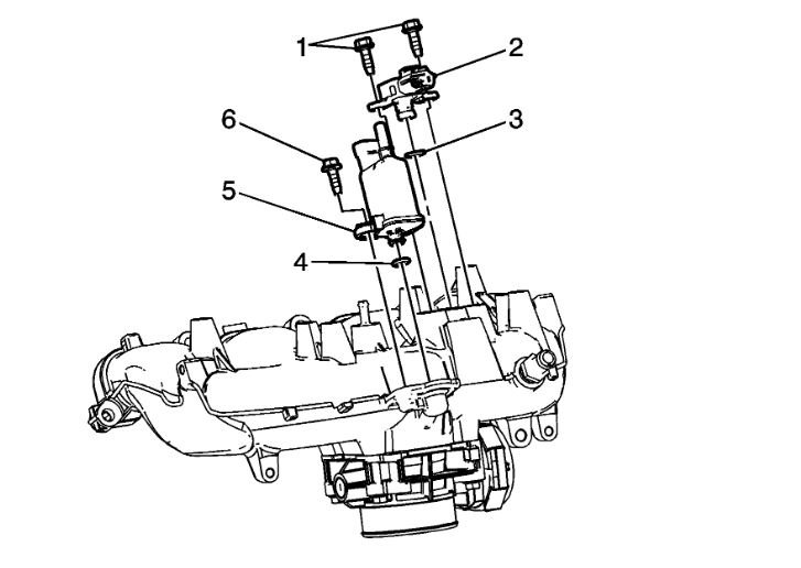

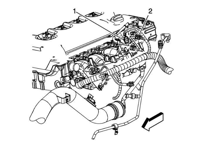

Repair Instructions
Perform the Diagnostic Repair Verification (See: A L L Diagnostic Trouble Codes ( DTC ) > Verification Tests) after completing the diagnostic procedure.
Evaporative Emission Canister Purge Solenoid Valve Replacement (See: Canister Purge Solenoid > Removal and Replacement > Evaporative Emission Canister Purge Solenoid Valve Replacement)

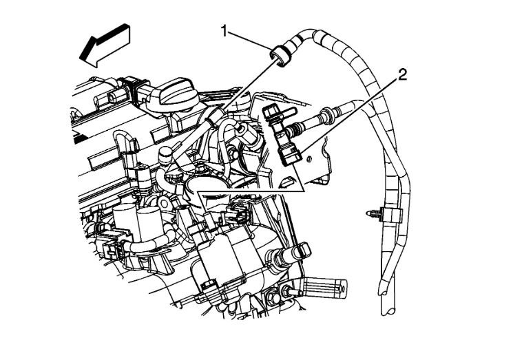

1. Disconnect the chassis evaporative emission (EVAP) line quick connect fitting (2) from the purge solenoid. Refer to Plastic Collar Quick Connect Fitting Service (See: Fuel Line Coupler > Removal and Replacement > Plastic Collar Quick Connect Fitting Service) .
2. Disconnect the engine wiring harness electrical connector (1) from the EVAP canister purge solenoid.
3. Remove the EVAP canister purge solenoid bolt (6).
4. Remove the EVAP canister purge solenoid (5).
5. Remove the EVAP canister purge solenoid O-ring seal (4), if necessary.
6. Inspect for carbon release in the EVAP canister purge solenoid ports. If there is any loose carbon, replace the EVAP canister and any components necessary to remove the carbon particles.
Installation Procedure
1. Install the EVAP canister purge solenoid O-ring seal (4) to the solenoid, if necessary.
2. Lubricate the O-ring seal with clean engine oil.
3. Install the EVAP canister purge solenoid to the intake manifold.
Notice: Refer to Fastener Notice (See: Vehicle > Vehicle Damage Warnings > Fastener Notice) .
4. Install the EVAP canister purge solenoid bolt.
Tighten the bolt to 10 N.m (89 lb in).
5. Connect the engine wiring harness electrical connector (1) to the EVAP canister purge solenoid.
6. Connect the chassis EVAP line quick connect fitting (2) to the purge solenoid. Refer to Plastic Collar Quick Connect Fitting Service (See: Fuel Line Coupler > Removal and Replacement > Plastic Collar Quick Connect Fitting Service) .
