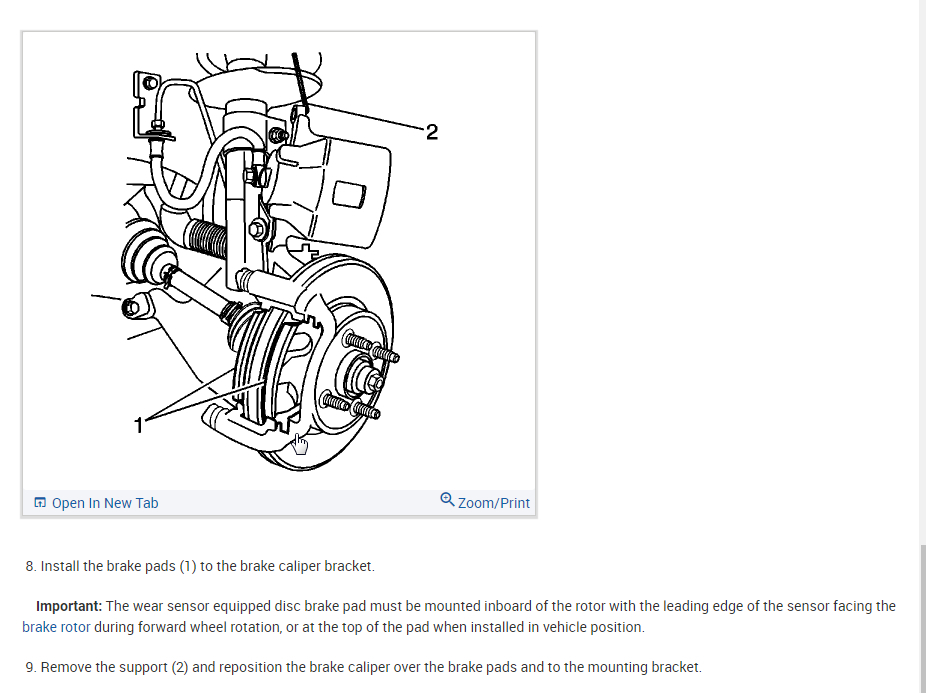

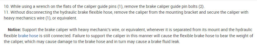

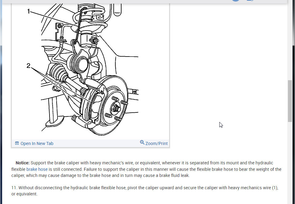

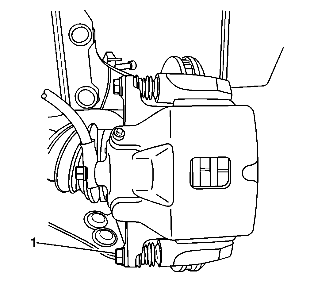

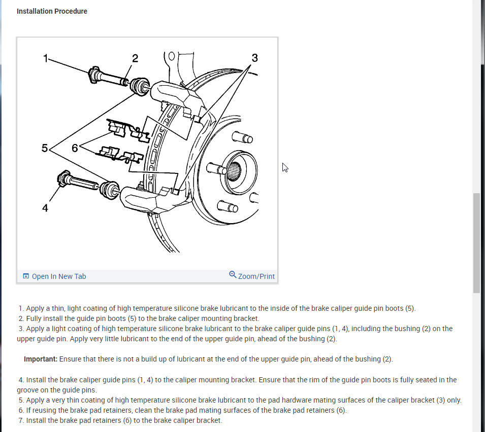

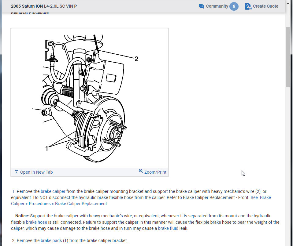

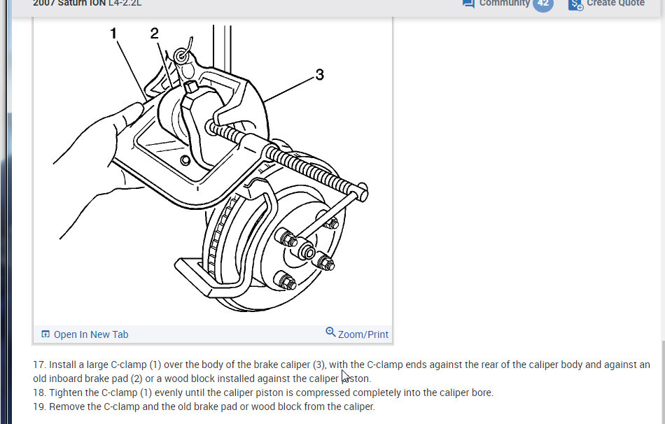

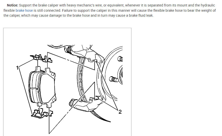

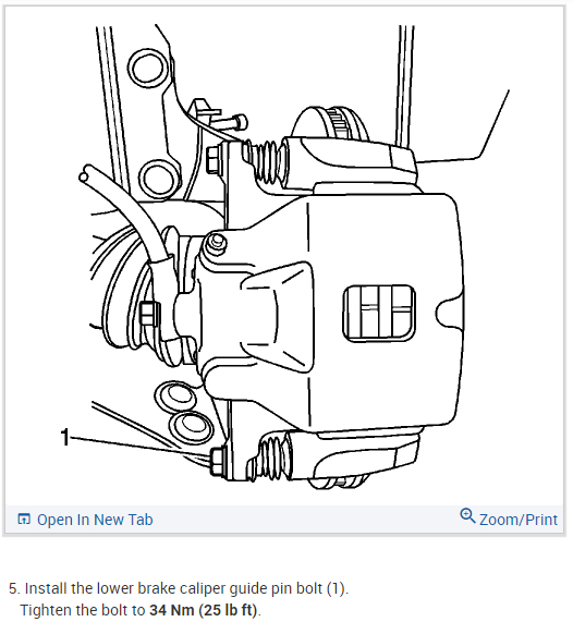

Bought replacement pads and rotors, removed 2 bolts and now I cannot get the old part off of car. Looks like it should slide, but won't move. Is there a release or something I need to do?
Jan 4, 2016 at 8:29 PM
Once the 2 caliper slide bolts are removed the caliper should lift off. Here is a guide that will help with this:
Lastly the process below is from the manual and that will help complete this repair.
Let us know if you have questions. Thanks

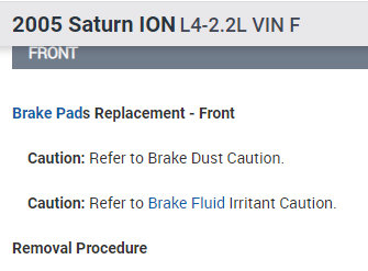

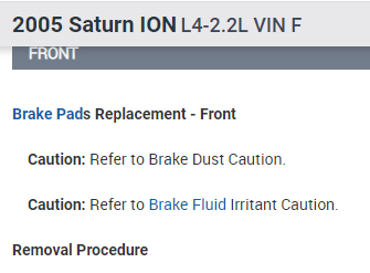

Here are the directions specific to your vehicle. The attached pics correlate with the directions.
2007 Saturn ION L4-2.0L SC
Front Disc Brake Pads Replacement
Vehicle Brakes and Traction Control Disc Brake System Brake Pad Service and Repair Removal and Replacement Front Disc Brake Pads Replacement
FRONT DISC BRAKE PADS REPLACEMENT
Caution: Refer to Brake Dust Caution in Cautions and Notices.
Caution: Refer to Brake Fluid Irritant Caution.
Removal Procedure

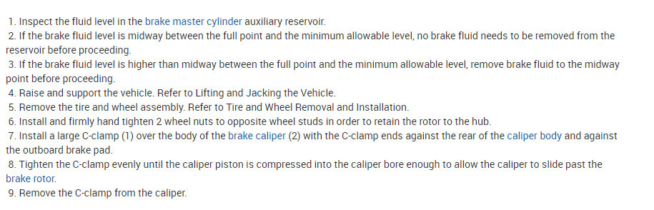

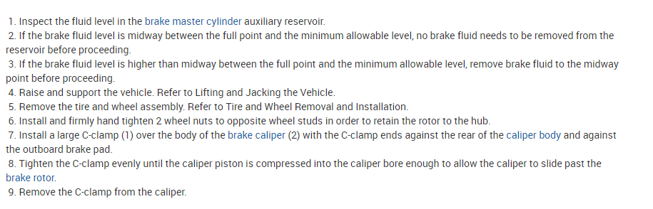

1. Inspect the fluid level in the brake master cylinder auxiliary reservoir.
2. If the brake fluid level is midway between the maximum-full point and the minimum allowable level, no brake fluid needs to be removed from the reservoir before proceeding.
3. If the brake fluid level is higher than midway between the maximum-full point and the minimum allowable level, remove brake fluid to the midway point before proceeding.
4. Raise and support the vehicle.
5. Remove the tire and wheel assembly.

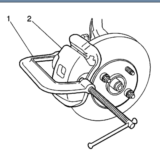

6. Install and firmly hand tighten 2 wheel nuts to opposite wheel studs in order to retain the rotor to the hub.

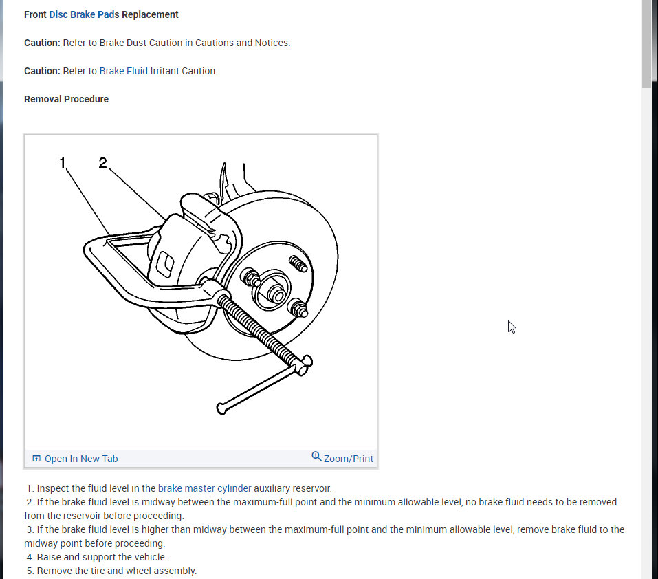

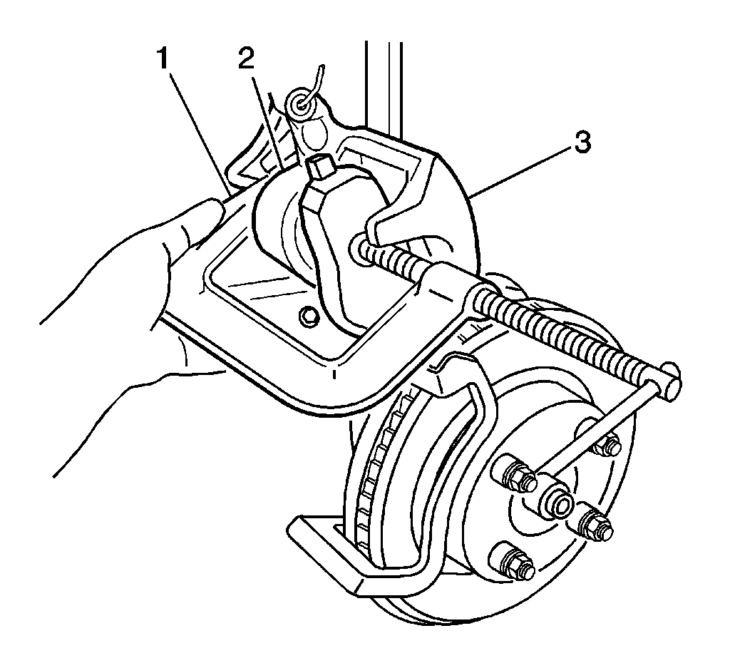

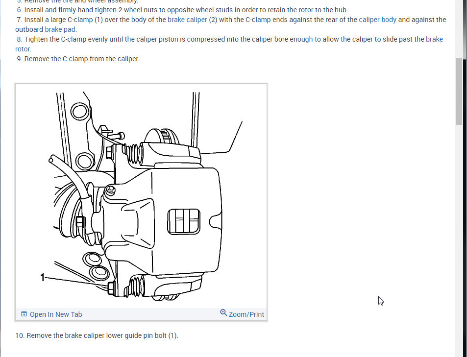

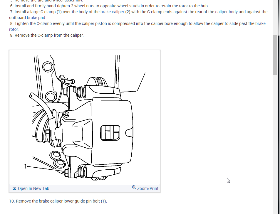

7. Install a large C-clamp (1) over the body of the brake caliper (2) with the C-clamp ends against the rear of the caliper body and against the outboard brake pad.
8. Tighten the C-clamp evenly until the caliper piston is compressed into the caliper bore enough to allow the caliper to slide past the brake rotor.
9. Remove the C-clamp from the caliper.

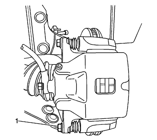

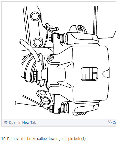

pic 2

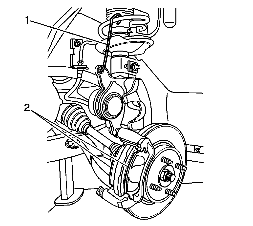

10. Remove the brake caliper lower guide pin bolt (1).

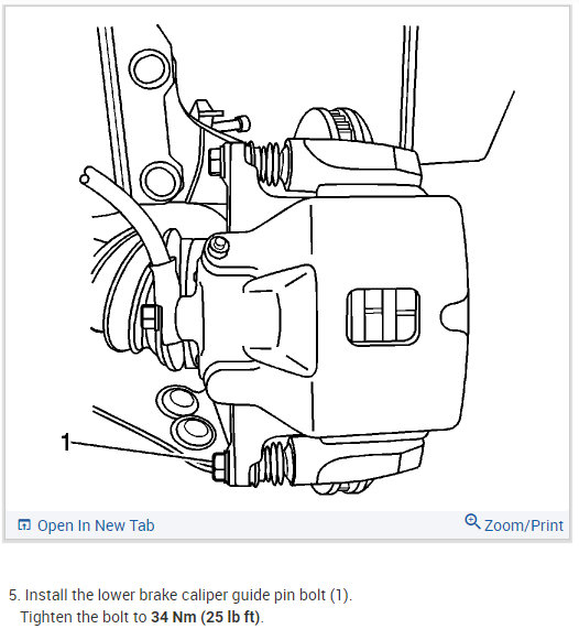

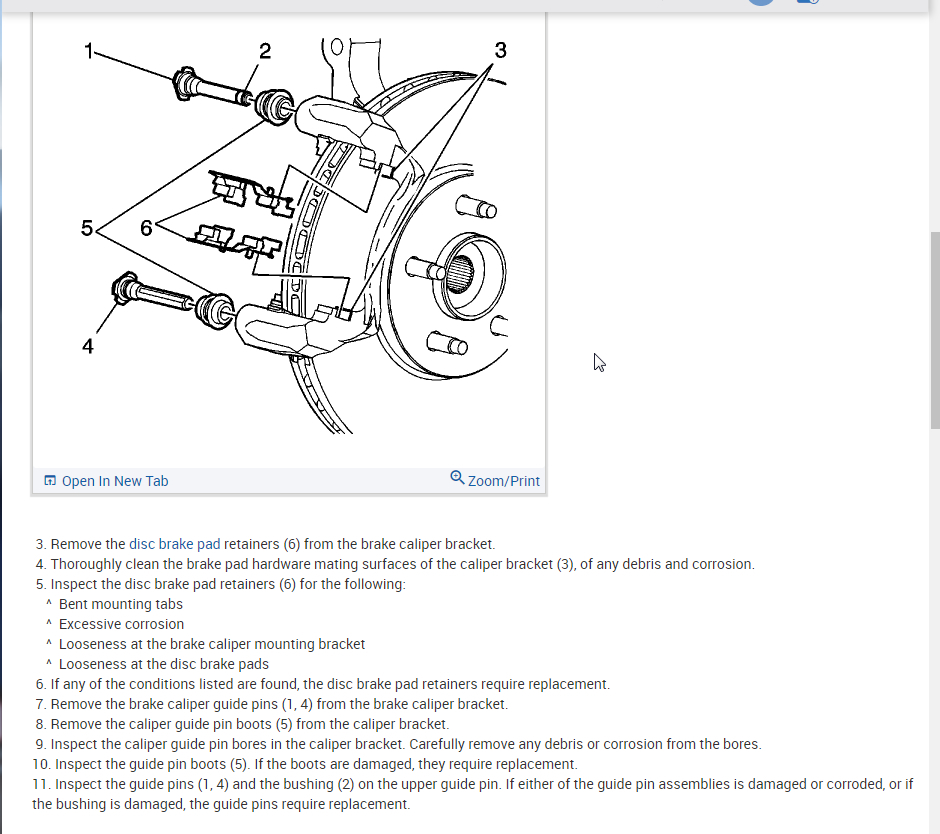

pic 3

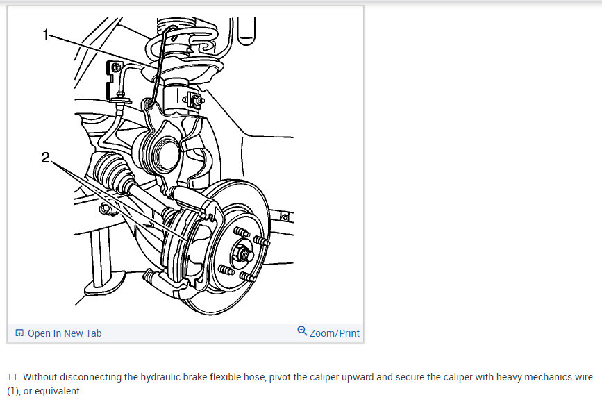

Notice: Support the brake caliper with heavy mechanic's wire, or equivalent, whenever it is separated from its mount and the hydraulic flexible brake hose is still connected. Failure to support the caliper in this manner will cause the flexible brake hose to bear the weight of the caliper, which may cause damage to the brake hose and in turn may cause a brake fluid leak.
11. Without disconnecting the hydraulic brake flexible hose, pivot the caliper upward and secure the caliper with heavy mechanics wire (1), or equivalent.
pic 4

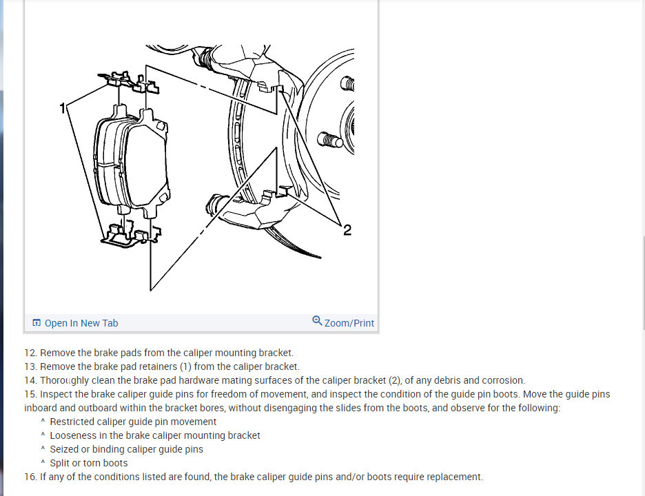

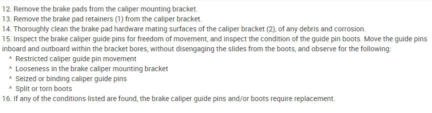

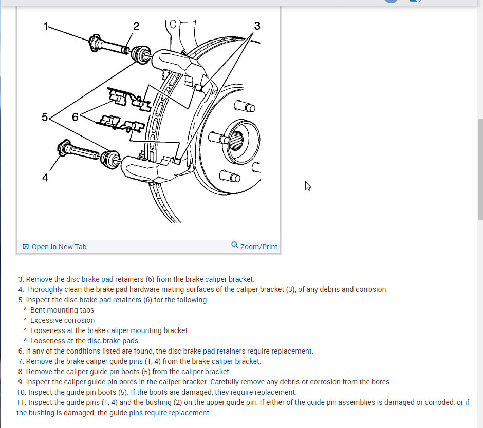

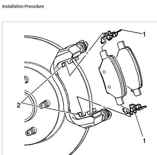

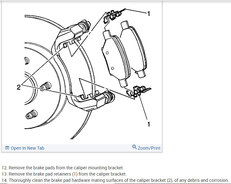

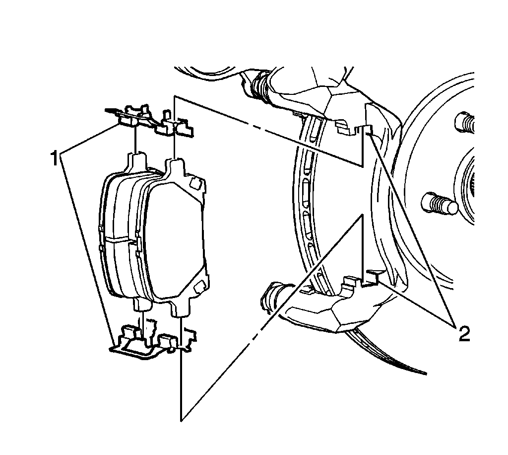

12. Remove the brake pads from the caliper mounting bracket.
13. Remove the brake pad retainers (1) from the caliper bracket.
14. Thoroughly clean the brake pad hardware mating surfaces of the caliper bracket (2), of any debris and corrosion.

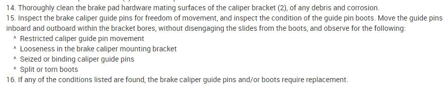

15. Inspect the brake caliper guide pins for freedom of movement, and inspect the condition of the guide pin boots. Move the guide pins inboard and outboard within the bracket bores, without disengaging the slides from the boots, and observe for the following:
^ Restricted caliper guide pin movement
^ Looseness in the brake caliper mounting bracket
^ Seized or binding caliper guide pins
^ Split or torn boots
16. If any of the conditions listed are found, the brake caliper guide pins and/or boots require replacement.

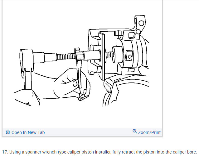

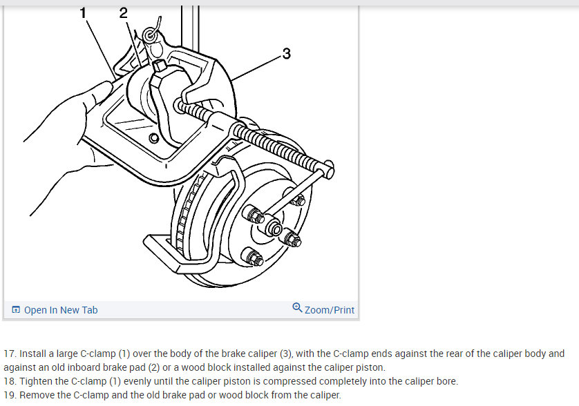

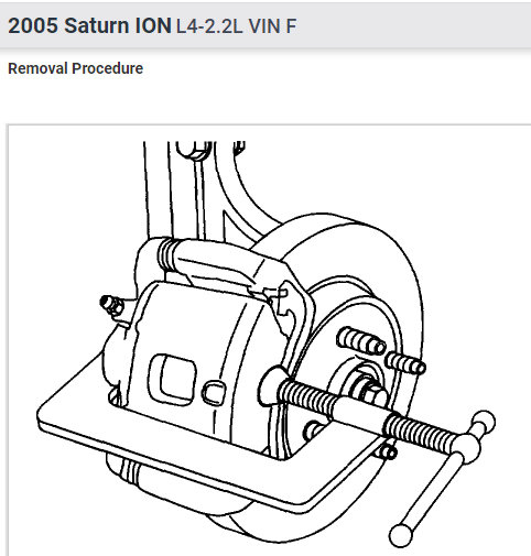

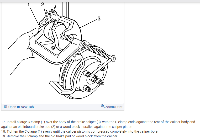

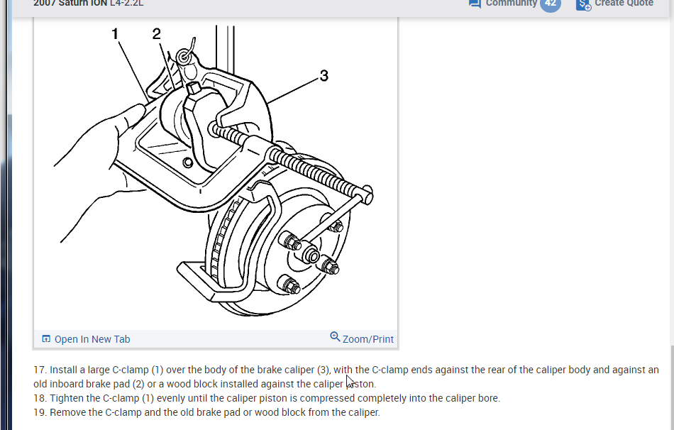

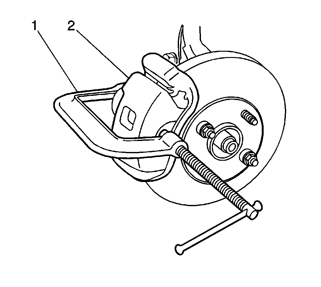

17. Install a large C-clamp (1) over the body of the brake caliper (3), with the C-clamp ends against the rear of the caliper body and against an old inboard brake pad (2) or a wood block installed against the caliper piston.
18. Tighten the C-clamp (1) evenly until the caliper piston is compressed completely into the caliper bore.
19. Remove the C-clamp and the old brake pad or wood block from the caliper.

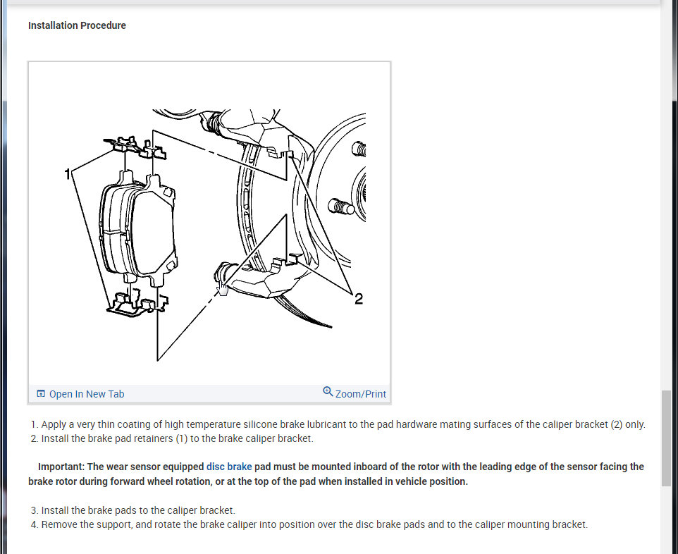

Installation Procedure
pic 6

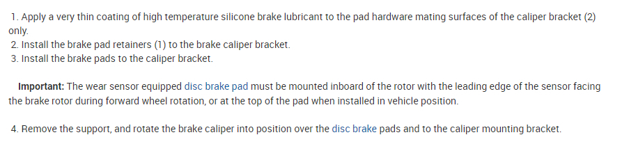

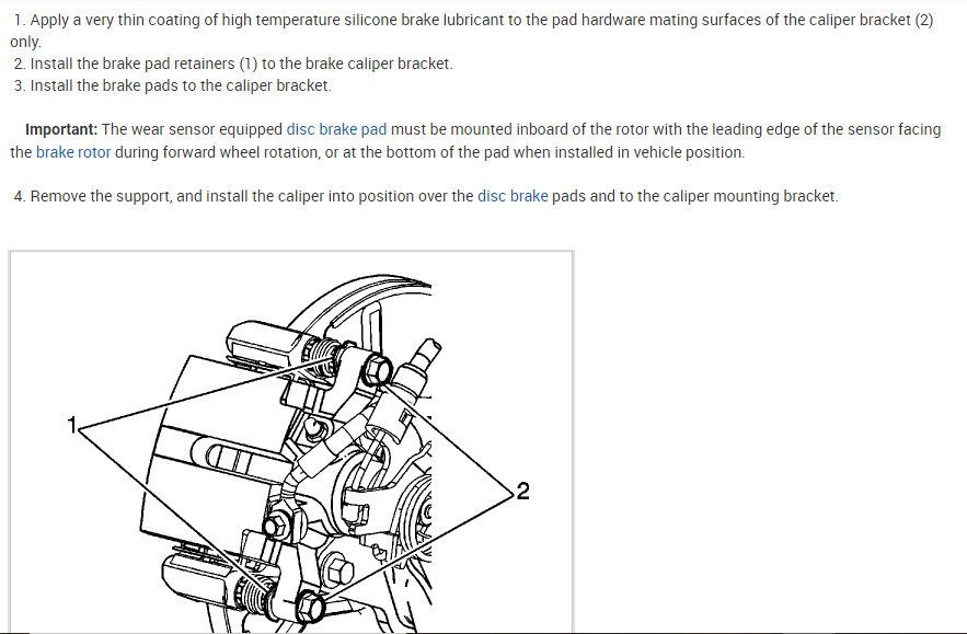

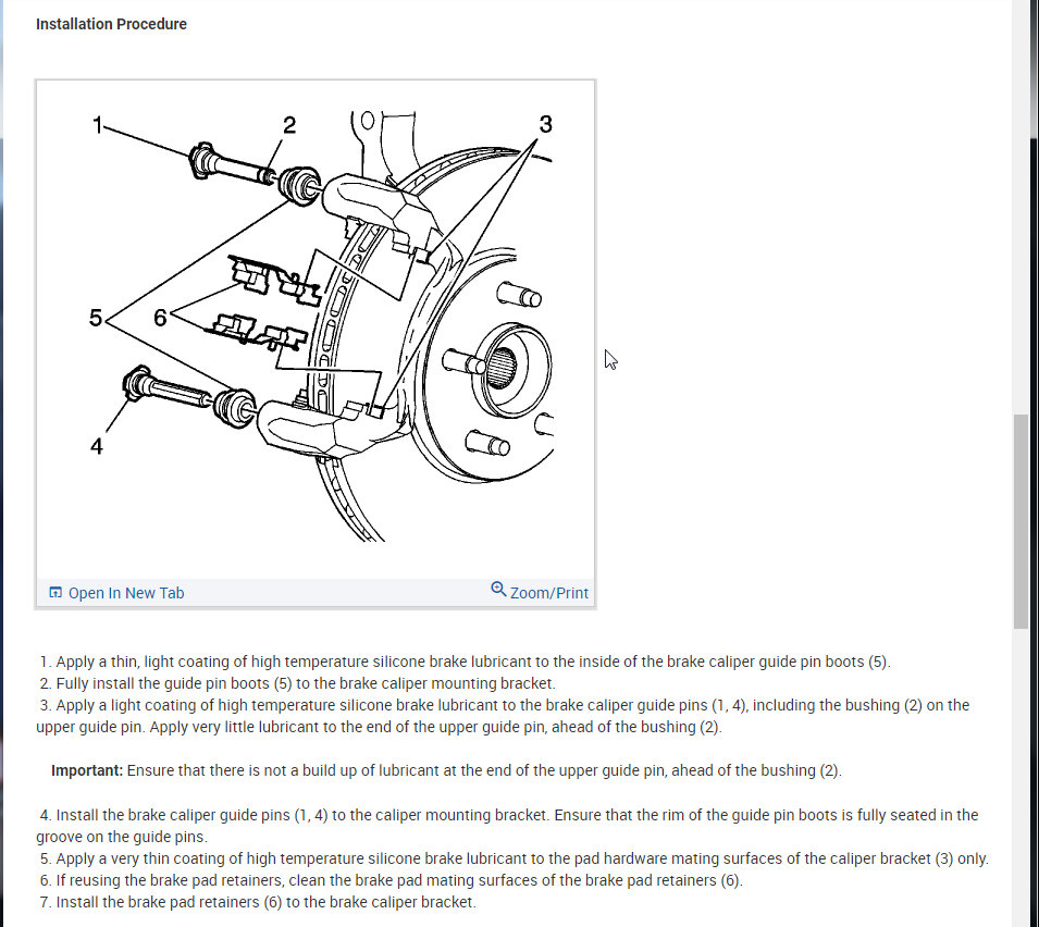

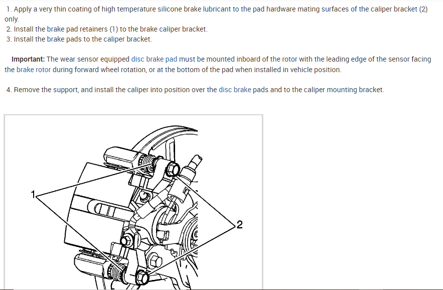

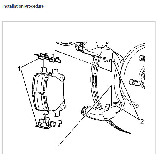

1. Apply a very thin coating of high temperature silicone brake lubricant to the pad hardware mating surfaces of the caliper bracket (2) only.
2. Install the brake pad retainers (1) to the brake caliper bracket.
Important: The wear sensor equipped disc brake pad must be mounted inboard of the rotor with the leading edge of the sensor facing the brake rotor during forward wheel rotation, or at the top of the pad when installed in vehicle position.
3. Install the brake pads to the caliper bracket.

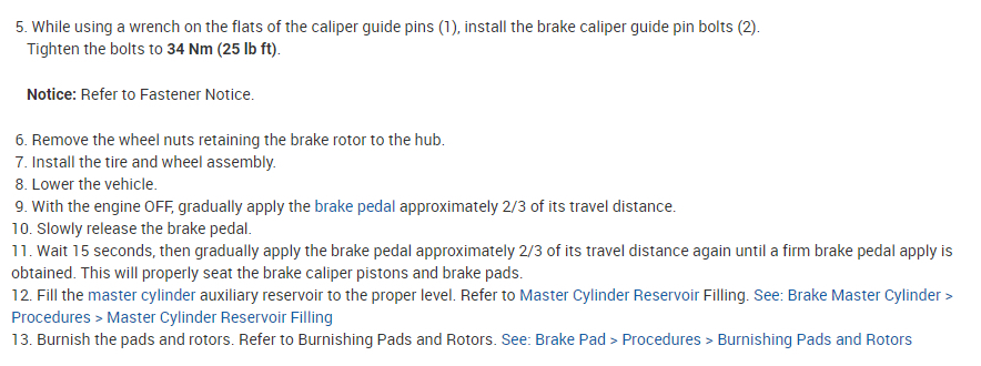

4. Remove the support, and rotate the brake caliper into position over the disc brake pads and to the caliper mounting bracket.
pic 7
Notice: Refer to Fastener Notice.

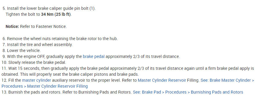

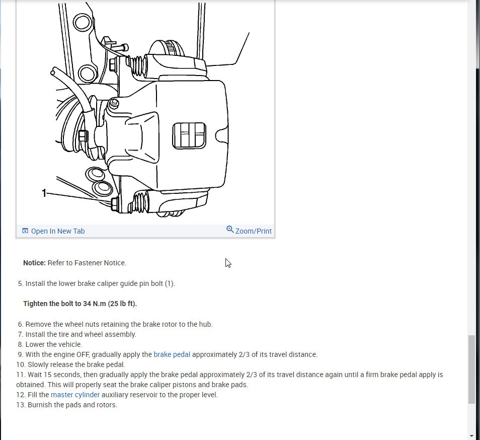

5. Install the lower brake caliper guide pin bolt (1).
Tighten the bolt to 34 N.m (25 lb ft).
6. Remove the wheel nuts retaining the brake rotor to the hub.
7. Install the tire and wheel assembly.
8. Lower the vehicle.
9. With the engine OFF, gradually apply the brake pedal approximately 2/3 of its travel distance.
10. Slowly release the brake pedal.
11. Wait 15 seconds, then gradually apply the brake pedal approximately 2/3 of its travel distance again until a firm brake pedal apply is obtained. This will properly seat the brake caliper pistons and brake pads.
12. Fill the master cylinder auxiliary reservoir to the proper level.
13. Burnish the pads and rotors.

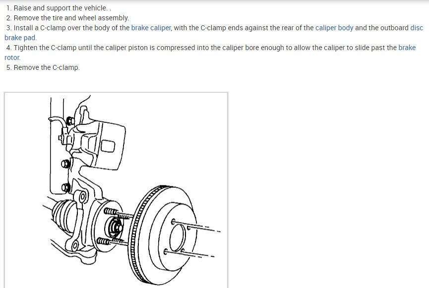

1. Raise and support the vehicle.
2. Remove the tire and wheel assembly.

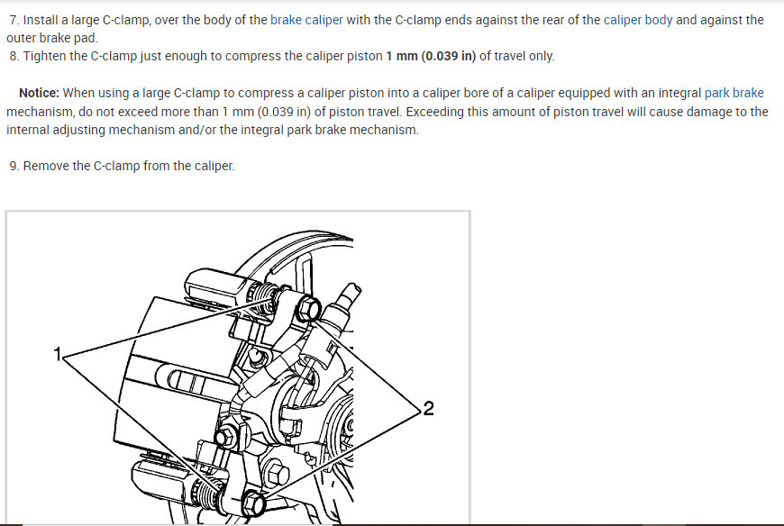

3. Install a C-clamp over the body of the brake caliper, with the C-clamp ends against the rear of the caliper body and the outboard disc brake pad.
4. Tighten the C-clamp until the caliper piston is compressed into the caliper bore enough to allow the caliper to slide past the brake rotor.
5. Remove the C-clamp.

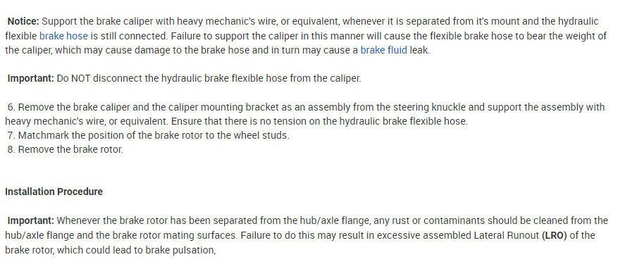

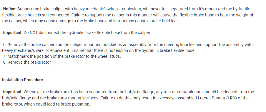

Important: Do NOT disconnect the hydraulic brake flexible hose from the caliper.

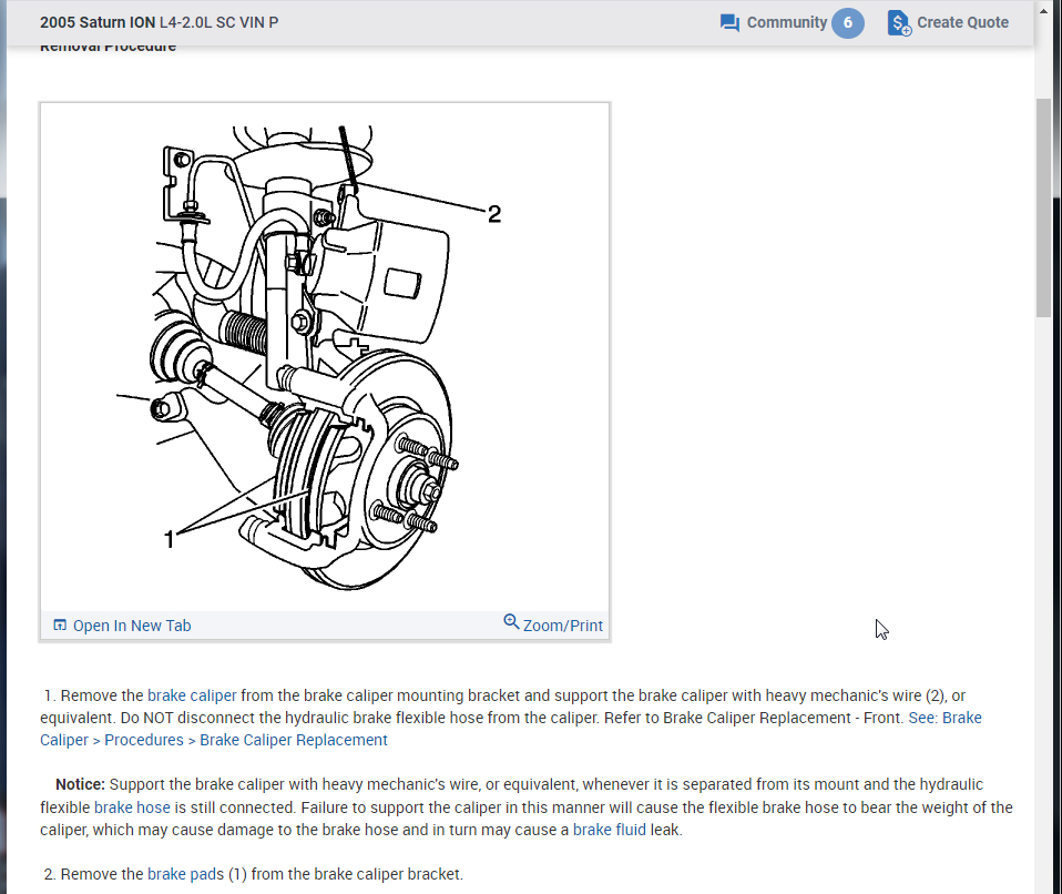

6. Remove the brake caliper and the caliper mounting bracket as an assembly from the steering knuckle and support the assembly with heavy mechanic's wire, or equivalent. Ensure that there is no tension on the hydraulic brake flexible hose.
7. Matchmark the position of the brake rotor to the wheel studs.
8. Remove the brake rotor.
pic 10

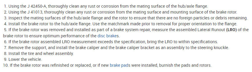

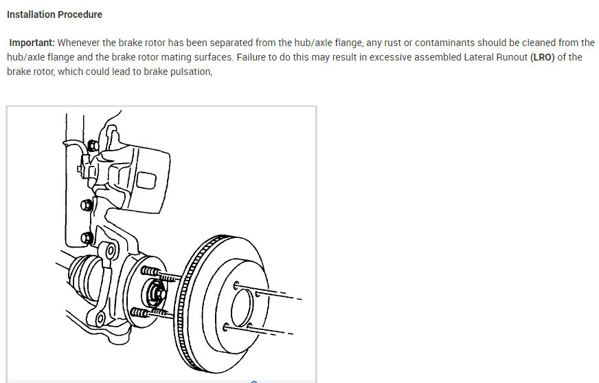

Important: Whenever the brake rotor has been separated from the hub/axle flange, any rust or contaminants should be cleaned from the hub/axle flange and the brake rotor mating surfaces. Failure to do this may result in excessive assembled lateral runout (LRO) of the brake rotor, which could lead to brake pulsation.
1. Using the J42450-A, thoroughly clean any rust or corrosion from the mating surface of the hub/axle flange.
2. Using the J41013, thoroughly clean any rust or corrosion from the mating surface and mounting surface of the brake rotor.
3. Inspect the mating surfaces of the hub/axle flange and the rotor to ensure that there are no foreign particles or debris remaining.
4. Install the brake rotor to the hub/axle flange. Use the matchmark made prior to removal for proper orientation to the flange.
5. If the brake rotor was removed and installed as part of a brake system repair, measure the assembled lateral runout (LRO) of the brake rotor to ensure optimum performance of the disc brakes.
6. If the brake rotor assembled LRO measurement exceeds the specification, bring the LRO to within specifications.
7. Remove the support, and install the brake caliper and the brake caliper bracket as an assembly to the steering knuckle.
8. Install the tire and wheel assembly.
9. Lower the vehicle.
10. If the brake rotor was refinished or replaced, or if new brake pads were installed, burnish the pads and rotors.

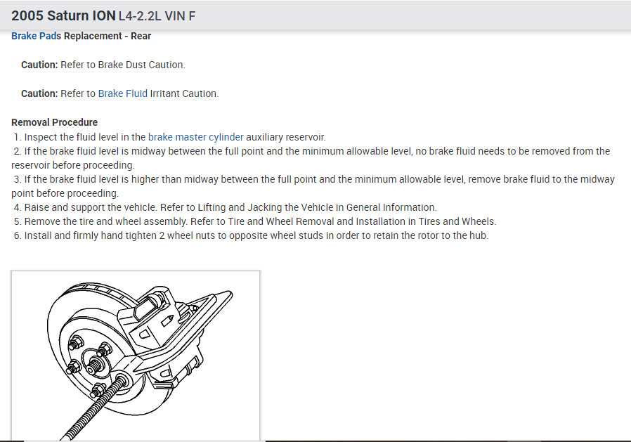

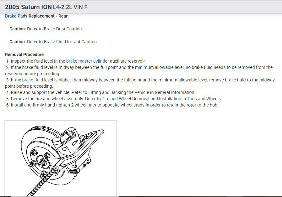

If my brake warning light comes on does it mean the brakes need to be replaced?
Feb 12, 2021 at 1:46 AM (Merged)
The brake light coming on means the fluid in the master cylinder is low which could be due to a leak or the brakes are low and need to be replaced.
Here are some guides that will help with this:
https://www.2carpros.com/articles/how-to-replace-rear-brake-pads-and-rotors
Below you will find the process from the manual on how to replace the brakes on this vehicle.
Let us know if you have other questions. Thanks

Having the brake light come on could possibly mean it has came on for having a low brake fluid level in the brake master cylinder due to having excessive brake pad wear. Here are tutorials for you to view on how to change front brake pads and rotors and rear brakes pads and rotors:
I've attached picture steps below on how to change the front brake pads and brake rotors on your as well as the rear brake pads and rotors for your vehicle. Hope this helps and thanks for using 2CarPros.
