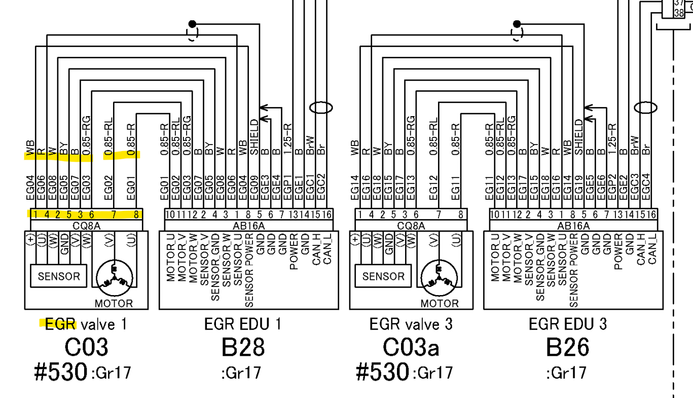

I got loss of power from my fuso and did a scan on it, got code po404 for EGR range/performance. does anyone here have a factory manual for the repair process of that code or a wiring diagram/pin-put for the EGR valve?

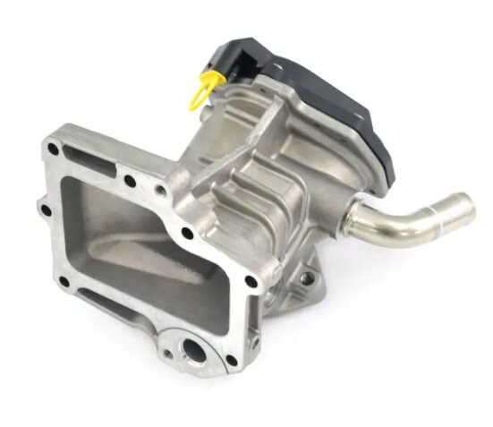

Hello, what sub model is the Fuso? FE125, fe145, fe180, fg140, etc.? I do not see any 3.0liters listed. We actually don't have any information listed on this vehicle here in the US. But if you have a loss of power and an EGR code. It sounds like the EGR valve is stuck open. Try unbolting the EGR valve and make sure there is no carbon build up holding the pintle open. I will try to find a picture of the valve for this vehicle, but that that's where you should start. Even a small piece of carbon can hold the valve open, allowing exhaust gases into the intake manifold all the time when it's only supposed to open under heavy throttle.
This is a picture of the valve; I hope this is the correct one. The code criteria state the ECM (engine computer) is reading an improper voltage through the valve. So, this may be a faulty valve.
This type of valve uses stepper motors to control it. A stepper motor has 2 sets of windings internal and 4 wires, 2 wires control each winding to move the valve in or out as needed.
If this is the valve you have on your vehicle, it should be a 4-pin plug on the valve, if so, you can check the resistance across the 2 windings with the valve unplugged to check if one of the stepper motors windings has lower or higher resistance than the other. Unfortunately, since this vehicle is not sold here in the US, we have limited to no information on it.

Yes, that's the exact same valve on the engine, it's a 4P10 Euro5 model engine I think with six wires, two twisted together like a CAN wire and four maybe for the valve or something else.
I would like to know those wires assignment and know how to test on them don't want a kind of try and error job

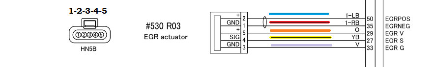

Okay, well it's not listed here on All Data so I'm looking some other places for European model vehicles. Are you sure it's not an 8 wire EGR valve, I came across some diagrams that are showing 3 wires for the motor inside and another 5 wires for an internal sensor. I'll post what I found so far. Let me know if any of those wire colors match up to what you have.

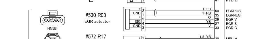

I haven't found any other diagrams so far, does the turbo have to come off to get to the EGR valve? The service manuals for these vans are over 2,000 pages. Some of the setups I'm seeing have EGR coolers with built in sensors, and multiple EGR valves. The EGR valves also have temperature sensors as well. I'll post a diagram if I can find a 6-wire valve.
I found a five wire EGR valve, which looks like it might have two wires for the valve together, possibly twisted. and the other three wires look like a position sensor, where pin 5 is a positive voltage with pin 4 being the signal and pin 3 being the ground so that pin 5 id think that would be a 5-volt reference. And the other positive wire (pin2) is most likely going to be a 12-v feed (EGR pos) and pin 1 (EGR neg) for valve movement.

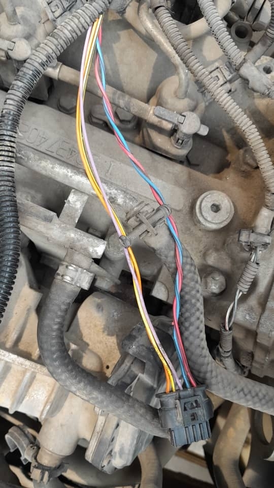

Finally my friend took a picture of it. This is the valve wire harness. It's a 5-wire connector with 2 twisted wires like I told you earlier.

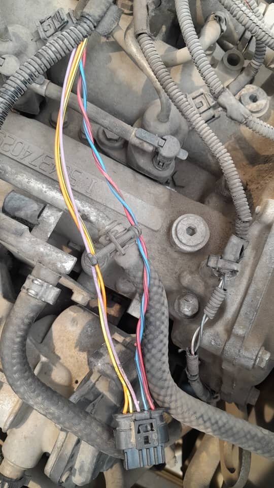

PROSPER DAVIDSON
  • 16 POSTS
Finally my friend took a picture of it this is the valve wire harness it's a 5 wire connector with 2 twisted wires like I told you earlier

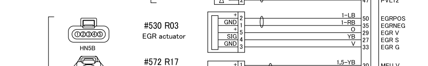

This diagram has the same 5 wire EGR valve. Same wire colors. So, on the 2 twisted wires, the blue wire with the black stripe should be the positive wire for the EGR valve (pin 2), being a positive wire, and i'll assume this is a 12-volt system. That should have battery power on it with the key On. The red wire with the black stripe is the negative for the valve (pin 1). The valve is probably a ground side switched. Does that tube on the valve go to a vacuum line running to the Intake manifold?
The other 3 pins are for the EGR valve position sensor, which is just like a potentiometer. Pin 3 is Ground (violet wire), pin 4 is Signal to ECM (yellow with black stripe), and pin 5 is going to be some Reference voltage (orange wire). I don't know this system, so it can be 5volt, I've seen some 8-volt references before. But with the key On, and your meter negative lead hooked to battery negative, you can check to see what voltage you get on pins 2 and 5.
But this diagram has the exact wire colors in the correct places. Hope this helps. It was very difficult to find any information on this van. As I said, the service manual is over 2,000 pages.

I got to the truck today and did some tests on those wires. I found 12v on pin 2, pin 1 got a kind of P.W signal to control valve not a ground. when unplugged from valve test pin 1 to ground with my meter got 5v. pin 3 ground, pin 5 has 5v reference pin 4 valve position sensor all wires tests good no short circuit.
I did a kind of play by cutting off pin 1 circuit and ran a scan just to see what code I would get, I got a circuit low code together with the current po404 I then removed the valve and tested with a 12v and ground, valve opens and closes just fine. I monitor it with a scanner as I test with 12v and ground it moves from 0% to 100% just to see if the position sensor is reading actual positions. all these done I still get po404 code. could this be a valve issue or ECM faulty?

I monitored the position sensor on a road test. It goes from 20,40,60, to 100% in some cases 0% depending on the ECM demand. One bad thing about this code is that I can't erase it to road test and get a freeze frame that might lead me somewhere. the 12v supply I think it's good because I cut off the pw circuit which is pin 1 and grounded it motor moves fine.
I checked the resistance on the motor I got 0.0-0.1 I don't know what the actual resistance should be. I'm thinking maybe the motor is overloading the pw circuit control line. This makes the ECM to set this code at key ON even without driving to see if it happens under some certain condition. Key ON engine off I tested pin 2 to ground got 12v pin 1 to ground got 11v then pin 1 to pin 2 got 1.6v or thereabouts what does this mean is this a kind of voltage drop or resistance too high kind of? This Fuso is making me pull my hair, I will send the truck out to work and see what the driver's complain would be this time because I did a whole lot yesterday just to put the truck back to work. I think a pw circuit has a very high sense of resistance in a circuit load, which could make it feel like this is having a performance issue even at key on and code can't be erased.

That resistance sounds super low, at 0.1ohms you would be getting 120amps of current flow through the motor, there is probably a current sensing circuit inside the ECM and is coding that valve right at key on during some possible self-test, but that definitely sounds too low. When the valve is not active, having no ground you're reading the supply voltage through the motors coil, the ECM is intentionally shutting down the circuit to protect itself from such high current flow, hopefully it didn't damage the ECM driver for the valve.
