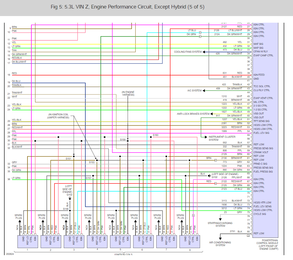

p0332/p0327 codes
17,000 MILES • 5.3L • V8 • 2WD • AUTOMATIC
RAYBORN 62

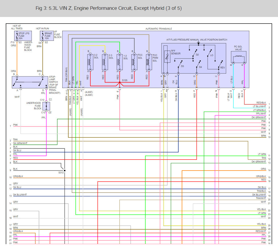

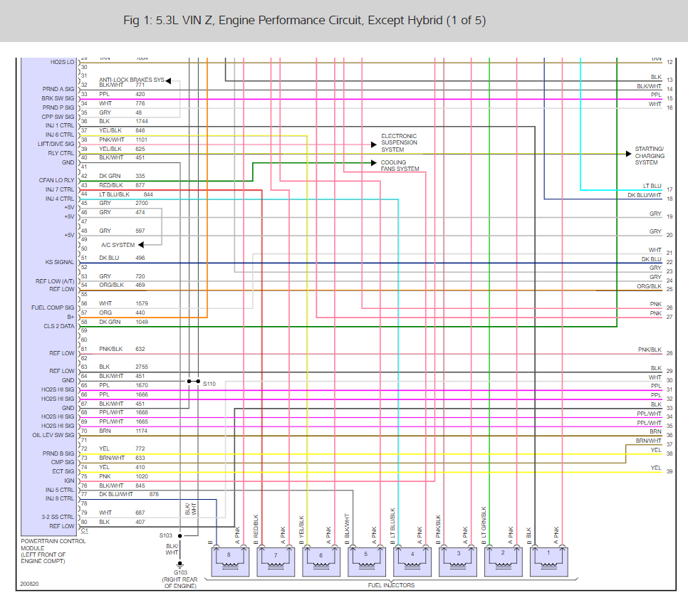

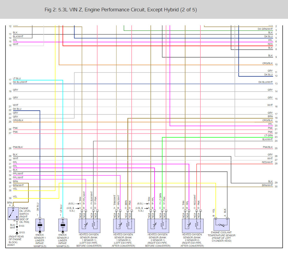

I have change the knock sensors out and harness. the same codes keep popping up.
Oct 19, 2017 at 12:11 AM
  • 55,766 POSTS

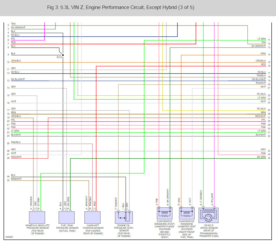

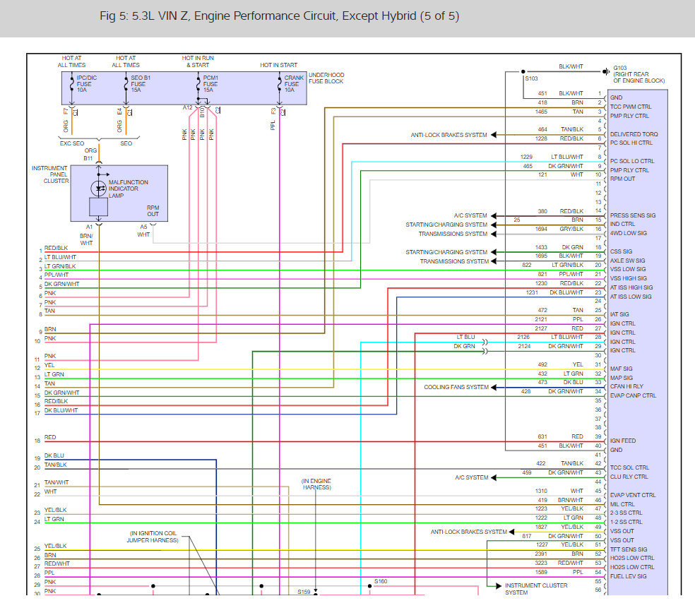

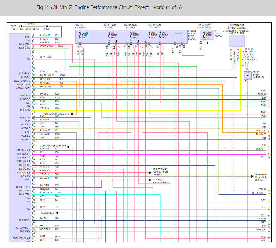

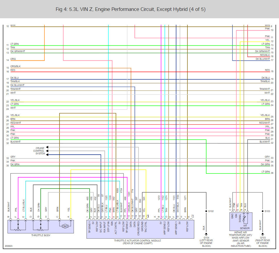

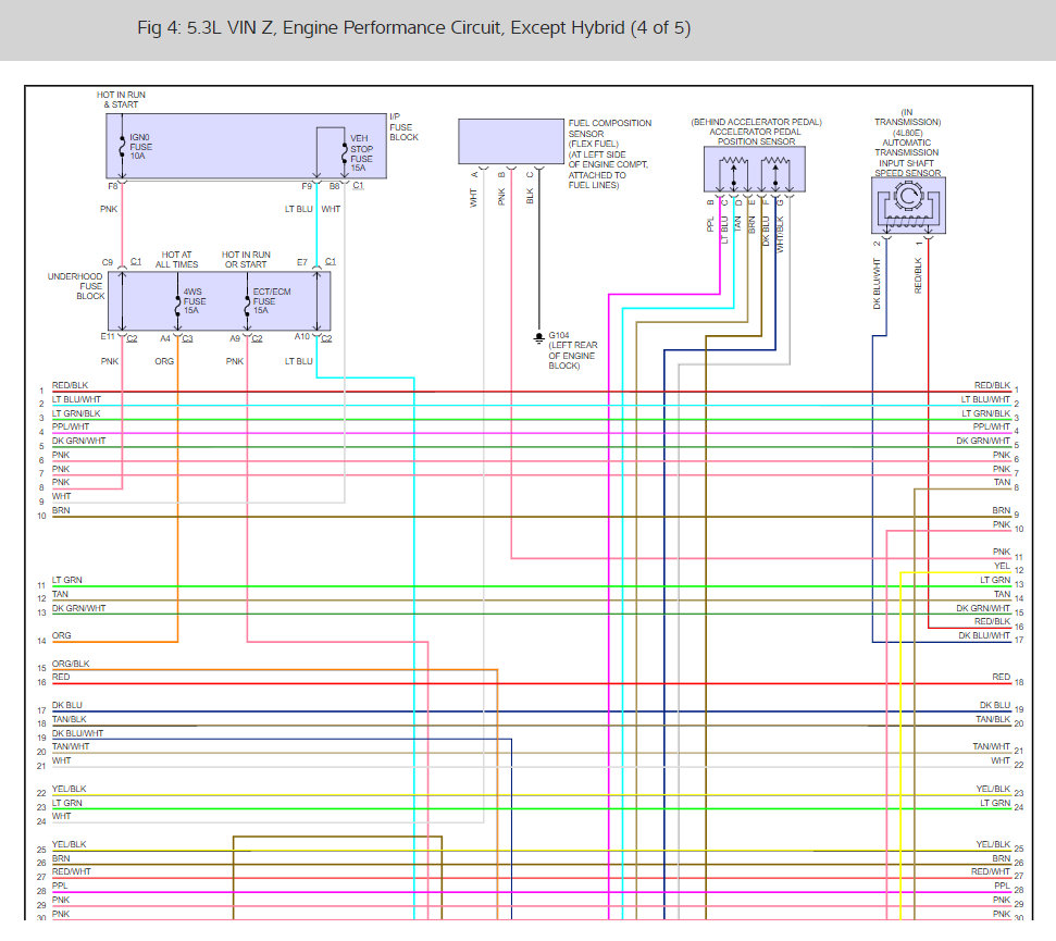

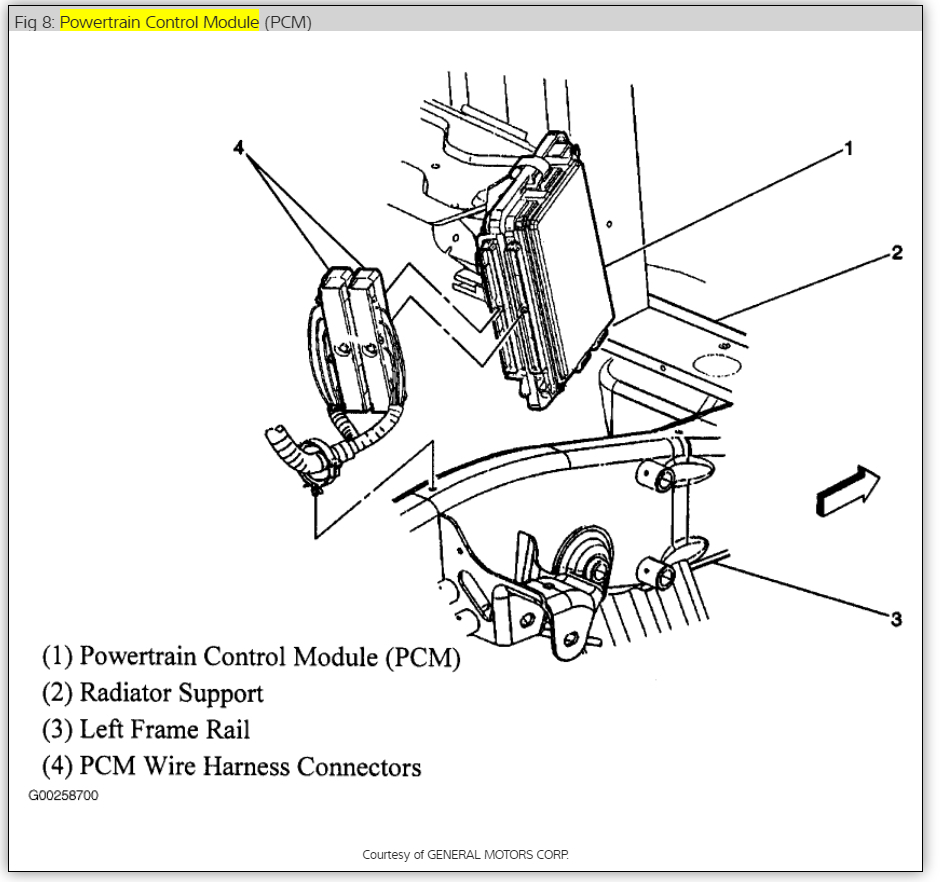

This sounds like it can be one of two problems, either you have a connection/wiring issue or the ECM is bad and needs to be replaced. The PCM will need to be programmed by a shop.
Here is a guide so you can double check the wiring.
There looks like there is 2 sensors did you replace them both?
