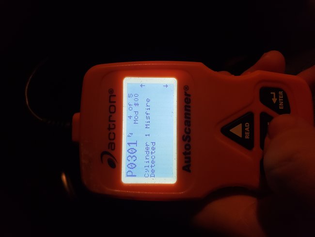

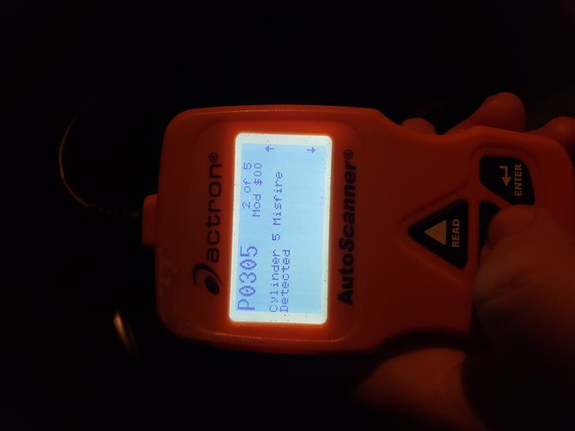

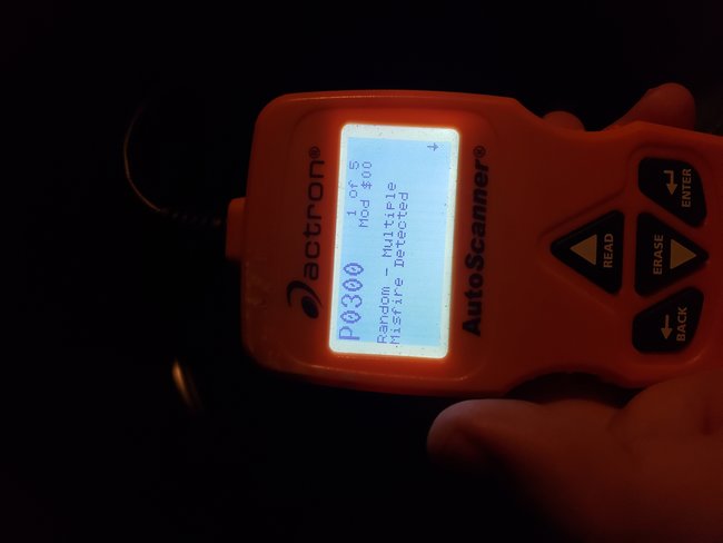

Codes Po300,po301,po305
2012 VOLKSWAGEN BEETLE
95,846 MILES • 2.5L • 5 CYL • 2WD • AUTOMATIC
CORY2427
  • 293 POSTS
It is saying random multiple misfire and cylinder 1 and 5 misfire, but it runs like it always has. doesn't seem anything is wrong. hard to start sometimes. replaced plugs on it bout 500 miles ago. just worried because engine light on.
Oct 1, 2019 at 6:18 AM
STEVE W.
  • 15,345 POSTS
Welcome to 2CarPros. P0300 is random misfire and is likely the result of the other two misfire codes. What did you use for spark plugs? OEM or? There are a lot of fake plugs on the market these days and they can fail rather rapidly. What I would do is swap the plugs to other cylinders and see if the misfire follows them. So put plug no.1 in 2 and no. 5 in 4 and see what it does. If the misfires move then I would source a new set of OEM plugs and install them. Misfires can rapidly destroy the converter because of the raw fuel from those cylinders. If you swap them and the misfires stay in the same places then I would swap the coils in the same way and check the wiring for the coils. The connectors are known to loosen and then you need to replace the connector ends.
But moving the parts first is a quick way to test them without spending money.
Oct 1, 2019 at 1:44 PM

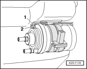

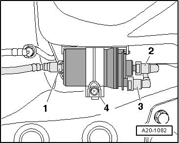

Fuel filter could be cause? Where is it at on these models?
Oct 2, 2019 at 7:01 AM
STEVE W.
  • 15,345 POSTS
Not as likely as an electrical issue. That's the issue with an intermittent, it could be anything but no way to tell if it only acts up once in a long while. However if the filter hasn't been changed it isn't a bad idea. To change it you need to pull the fuel pump fuse and let the engine shut down as the pressure drops. Then locate the filter back by the fuel tank. The bracket bolt gets removed and the lines get disconnected. Then the new one is installed.
Oct 2, 2019 at 7:54 AM
CORY2427
  • 293 POSTS
So I went to change the fuel regulator and noticed it said 4.0 bar. the new one I got is identical but is 6.6 bar. what’s difference or will it hurt it using it?
Oct 4, 2019 at 3:08 PM
STEVE W.
  • 15,345 POSTS
The OEM spec is 4 BAR. The higher pressure shouldn't be used as it will change the fuel flow through the injectors.
