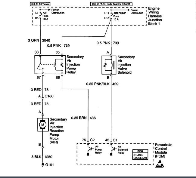

Changed EGR valve and purge valve, gas cap and vacuum line. still getting code po410 for small leak. any ideas? Also how can i reset engine light? Air pump is working i can hear it running. smell gas when starting car.
Oct 21, 2019 at 11:02 AM
Good afternoon,
I posted the description below.
Even if it is working, the passages could be clogged with carbon which is a common issue.
CIRCUIT DESCRIPTION
An AIR pump is used on this vehicle to lower tail pipe emissions on start-up. The PCM grounds the AIR pump relay control circuit, which energizes the AIR pump. The PCM also grounds the AIR solenoid valve, which allows vacuum to AIR solenoid valves. The PCM enables both control circuits when AIR system operation is desired. When the AIR system is active, the AIR pump forces fresh air into the exhaust stream in order to accelerate catalyst operation. When the AIR system is inactive, the AIR solenoid valves prevent air flow in either direction. DTC P0412 applies to the AIR solenoid control circuit. DTC P0418 applies to the AIR pump relay control circuit. DTC P0410 sets if an air flow problem is detected.

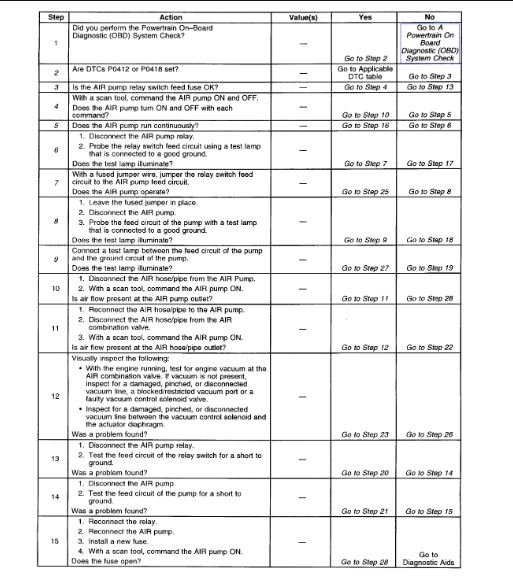

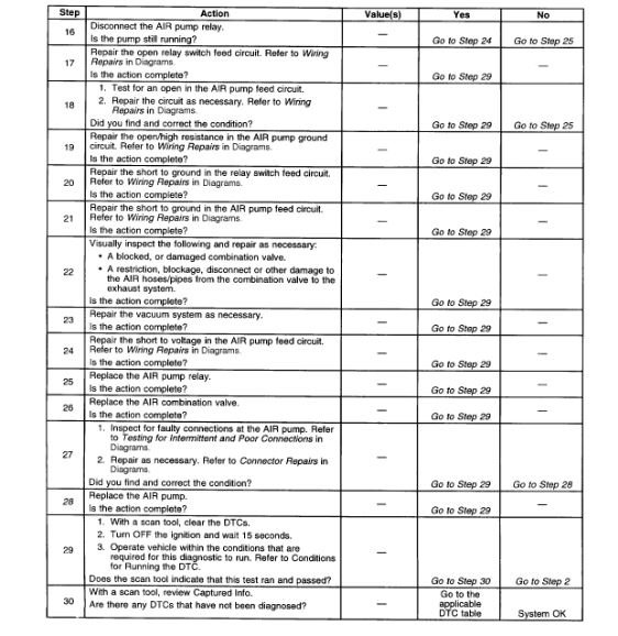

TEST DESCRIPTION
The numbers below refer to the step numbers on the diagnostic table.
2. DTC P0412 AIR Solenoid Valve Control Circuit and P0418 AIR Pump Relay Control Circuit should be diagnosed first if either are set.
3. Begins testing for a short to ground in the AIR pump feed circuit.
4. Listen for a running motor. Command both the ON and OFF states. Repeat the commands as necessary.
5. Begins testing for a short to voltage in the pump feed circuit.
6. Tests for voltage at the AIR pump relay switch feed circuit.
7. Bypasses the relay.
8. Tests for voltage on the AIR pump feed circuit.
9. Tests for an open on the pump ground circuit.
28. The AIR Pump is not designed to run continuously. If the pump needs to be replaced, inspect for conditions that may cause continuous pump operation.
