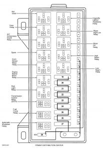

I have a 99 voyager that a fuse or a relay went out in but I don't which it is how can I find out what it is?

The dash lights are not working and it won't turn over

There is a fuse/relay box under the hood. It should be marked as to what the fuses and relays are for and position.
What happen for you to think it is a fuse or relay.
The 6th one down on the left is the Starter Relay. To check relay take a look at the numbers on it then look at the other relays with same shape and match numbers, then just swap relays. If vehicle starts replace relay, Mark relay so you remember which one you swapped.

Thats just it they are not labeled an any way.

Do you have the Owners Manual? If so look under Fuses/Relays.
I not sure how it will work but you may be able to save pic then with a graphics program resize so you can possibly read it.
I will see if I can P.M you the full size pic.
