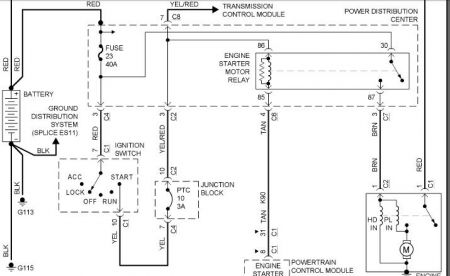

WHEN I TURN THE IGNITION KEY VAN DOESN'T START. GUAGES DON'T MOVE EITHER.

Hello, battery has a full charge, connections ok? If your saying the starter won't even crank, check the circuits at the starter relay in the power distribution center, under the hood. Might be a problem with ignition switch, can't tell, yet?

https://www.2carpros.com/forum/automotive_pictures/170934_voyager_starter_1.jpg
You can unplug the relay, use a teslite. Terminal 30 is hot all the time, terminal 86 goes hot with the key in the crank position. You can also check the fuse and breaker in the diagram.
