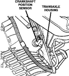

MASTERTECHTIM
  • 4,750 POSTS
Change the crankshaft position sensor
https://www.2carpros.com/forum/automotive_pictures/139033_2carpros_1.jpg
Saturday, May 17th, 2008 AT 8:41 AM
OBXAUTOMEDIC
  • 3,711 POSTS
OK, So just because the check or service engine light doesn't come on doesn't mean you don't have a sensor going bad.
I replaced the Crank Shaft Position Sensor and guess what it runs and runs and runs and runs. No Stalling.
You learn something new every day in the Business.
Vehicle Fixed!
