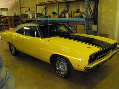

The car was restored 2 years ago and the wiring, light fixtures and everthing else is new. The car looks better than factory. But the guy I bought it from never had to use the headlights. So it's a problem from the build. The car has not even seen rain. I have not checked the bulbs yet. Could they have put a single filiment bulb in the left side, if so would this cause the same scenario? Did you get the car pic?

No, I didn't get the pic, but I would love to see it. A far as the light, anything is possible. It could be the wrong light, a ground problem, switch. Start easy. Make sure the lights are correct and good.
Let me know what you find, and I look forward to seeing the picture. (And take it from experience, never sell it!)

Thanks for your time.I will check out the bulbs when it gets better weather and let you know what I find later. Is it possible to contact you, say a couple of months or so down the line?I live across and south of St.Louis on the Illinois side. The weather sucks this time of year. I'm going to try to send you a pic again.Let me know if you get it.Phill

WOW! That thing is beautiful. It makes me want one again. Now, in my 40's everyone will say I'm going through the mid life thing, but nothing compares to a car like that. I have been saving for a sports car. I'm a little tired of driving a dakota with 225K on it, but I need it to plow my driveway and the damn thing always runs, so it's hard to get rid of. Regardless, I've been looking for a Porsche 944, but you just changed my mind. It's time to look for an old Superbee or something like yours. A buddy of mine has an original 426 hemi (needs rebuilt) from a hemi cuda. It needs a home and I need to find it one.
