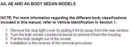

1989 Plymouth Reliant 4 cyl Two Wheel Drive Automatic
My daughter's boyfriend has a 1989 Plymouth Reliant and has to replace the bulb in the central brake light (in the rear window). How would that be done (in simplest terms so I can explain it over the phone.)

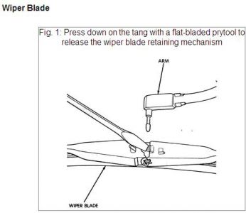

And if you can guide me so I can guide him/them on replacing a windshield wiper, that would be a bonus. Apparently it differs from how mine work. ;)

Hello, i came across this info.
https://images.2carpros.com/forum/automotive_pictures/170934_reliant_2.jpg
https://images.2carpros.com/forum/automotive_pictures/170934_wiper_1.jpg
