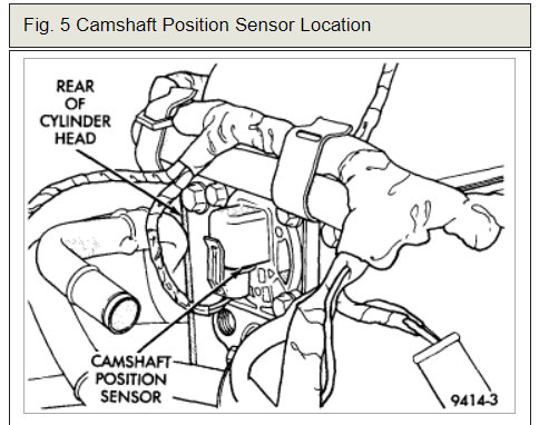

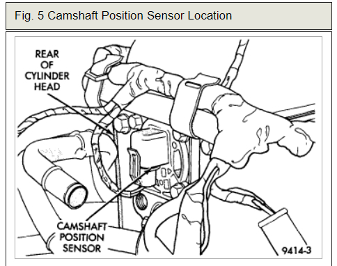

This is a camshaft sensor communication problem which can be solved by replacing the sensor in most cases. Here is a guide to help you see what you are in for when doing the job.
https://www.2carpros.com/articles/camshaft-angle-sensor-replacement

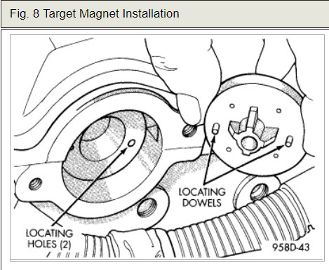

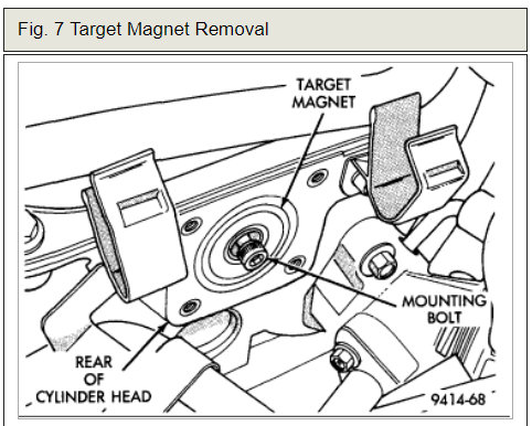

Here are some diagrams to show you ho the repair will be on your car.
Install target magnet in end of camshaft. Tighten mounting screw to 3 Nm (30 in lb) torque.
Install camshaft position sensor. Tighten sensor mounting screws to 9 Nm (80 in lb) torque.

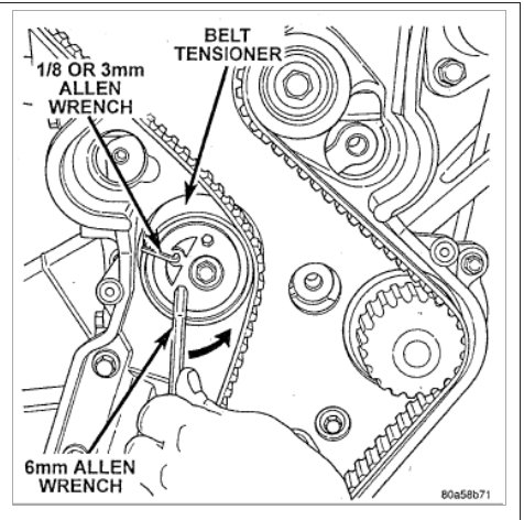

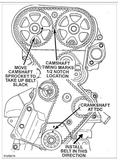

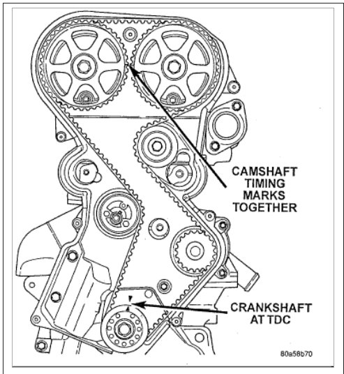

  • 54,861 POSTS

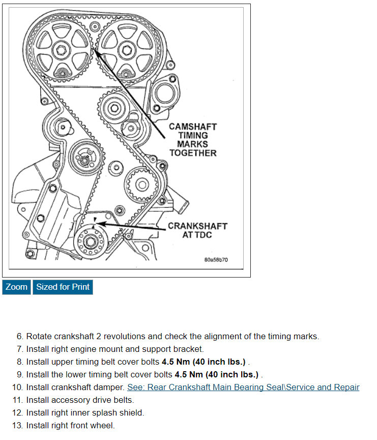

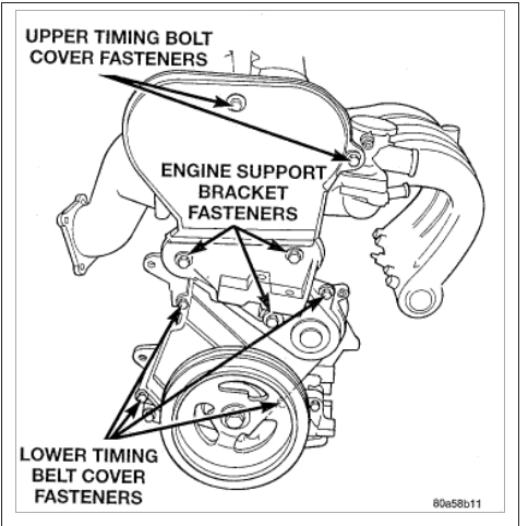

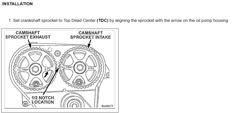

Thank you makes my job easier. This sounds like you have a timing belt tensioner that has gone bad which can cause the camshaft to be out of time intermittently which will cause the code. Please check the timing belt and tensioner here are diagrams and a guide to help you see whats going on.
https://www.2carpros.com/diagrams/plymouth/breeze/1998.
