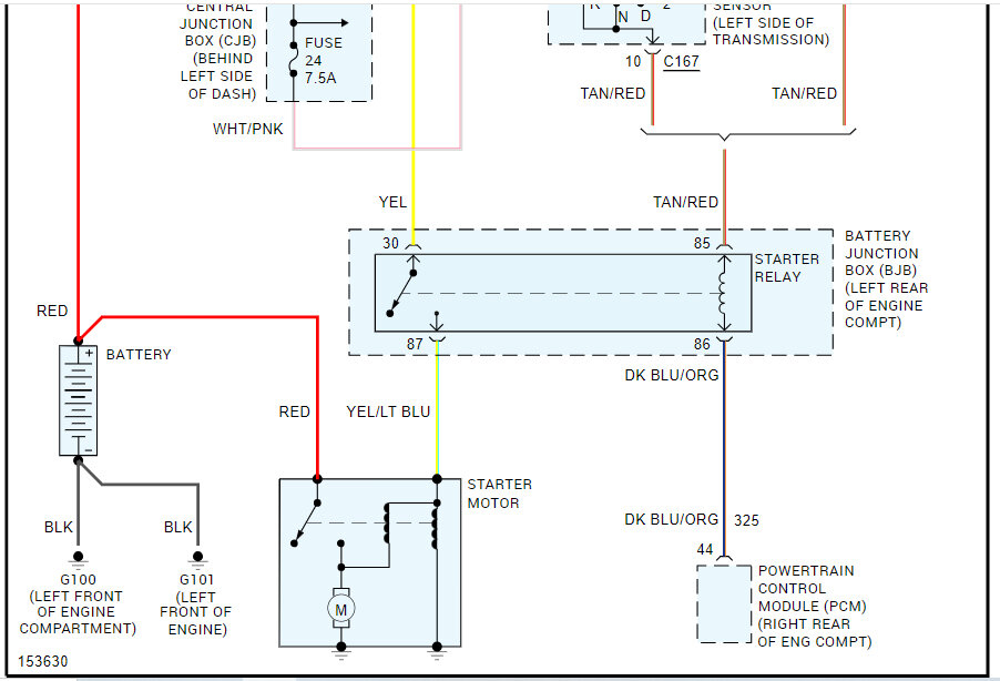

My truck was running good just had the check engine light on and oil pressure gauge bouncing. AutoZone suggested changing the fuel filter and oil sending unit, but before I got it done while driving it and it just shut off. Now when I try to start it, it doesn't do anything except for the dash lights come on. I took a wire and went to the starter straight to the battery with the key on and the engine turned over. What should I try next?

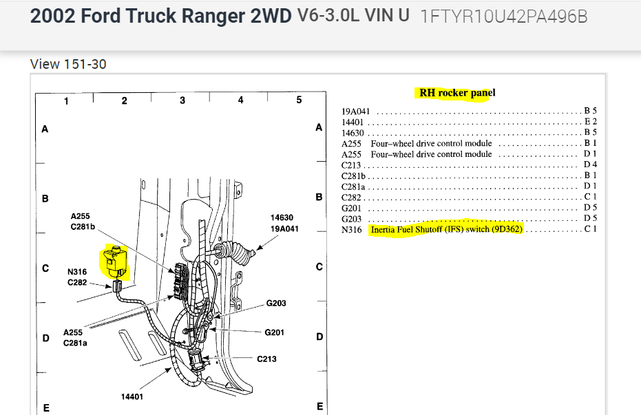

The vehicle identification number is 1ftyr10u42pa496b. Before it quit running when I turned the key on, I could hear the fuel pump running but now nothing, just my dash lights come on. I don't remember the code that AutoZone gave me.

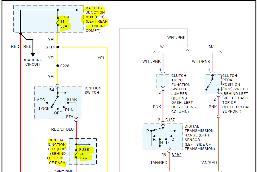

Does the starter engage? If not, I need you to first check the fuses and the relay shown in the wiring schematic below. In addition to checking fuses, make sure there is power to and from them.
If the fuses are good, move to the starter relay. Remove it and switch it with a different one in the relay box having the same part number.
Here is a link that explains how to test the relay and its circuit:
If that tests good, at the starter motor there will be a yellow wire with a blue tracer. Have a helper turn the key to the start position while you check if there is power to that wire.
If the starter is functional and the fuel pump is non-functional, locate the inertia switch on the passenger side kick panel and press the reset button to see if then you hear the pump prime. The last pic below shows the location.
