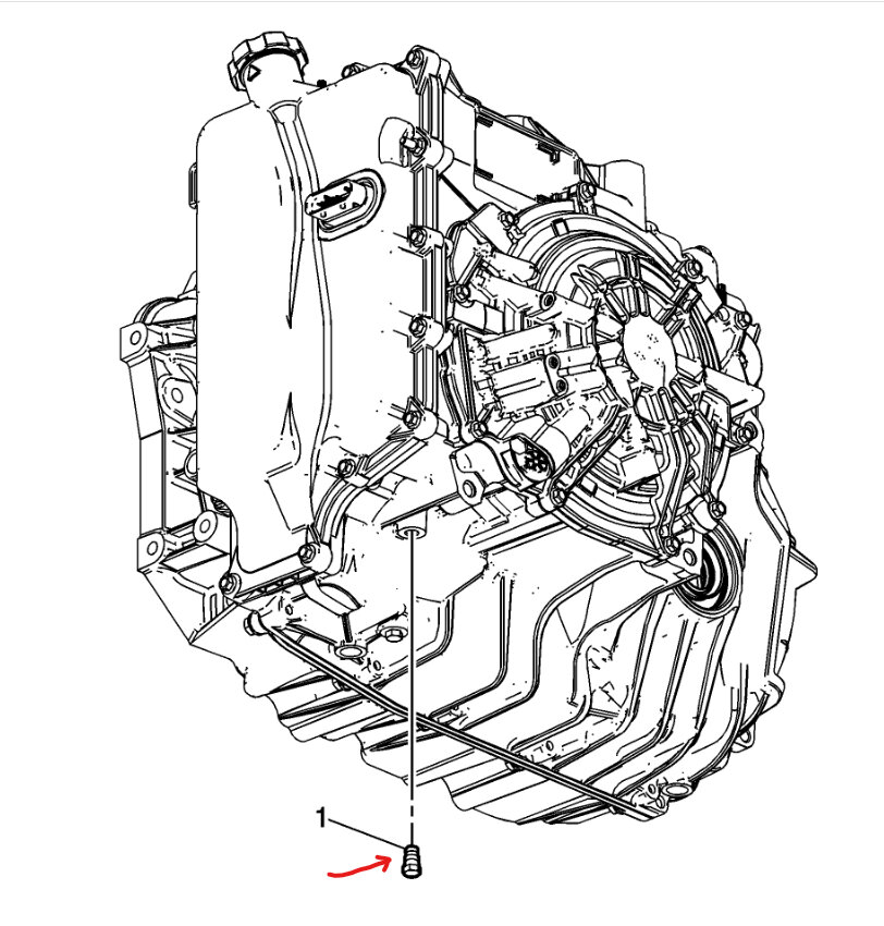

Addressing the P0963 code, by checking the solenoid?
2013 GMC ACADIA
130,000 MILES • 3.6L • 6 CYL • 4WD • AUTOMATIC

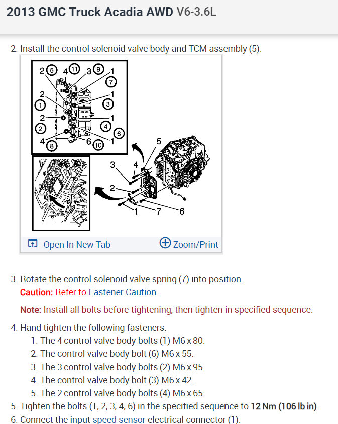

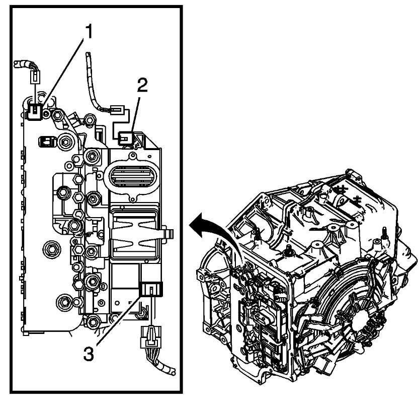

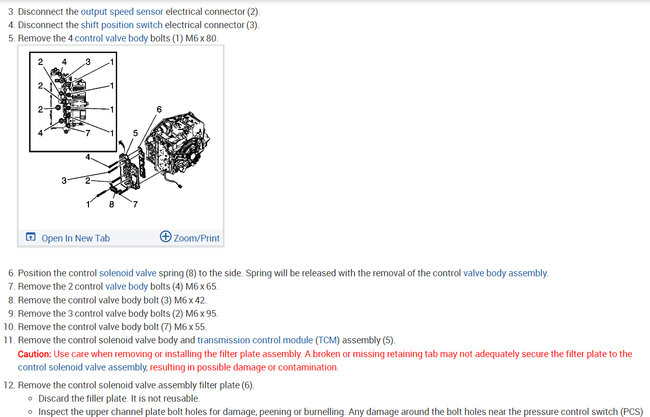

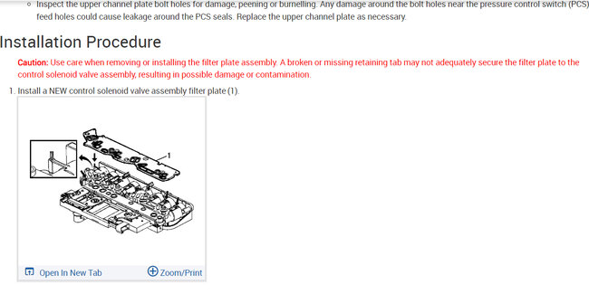

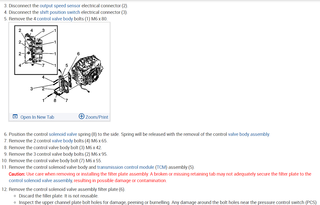

Addressing the P0963 code, by checking the solenoid, wiring and connectors is crucial restoring proper pressure and preventing further transmission damage given the symptoms of slipping and not shifting into 3rd or 4th gear after flushing, changing solenoid, is it possible the issue is with the hydraulic pressure that is tied directly to this fault code.
Oct 10, 2024 at 10:27 AM
  • 55,381 POSTS
That is correct, it will have this code if the fluid pump has failed.
The P0963 code on your 2013 GMC Acadia indicates an issue with the Transmission Pressure Control Solenoid "A" Control Circuit High.
It is time for a rebuild, if you want to pull it yourself, I can give you instructions.

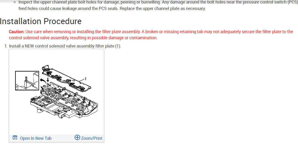

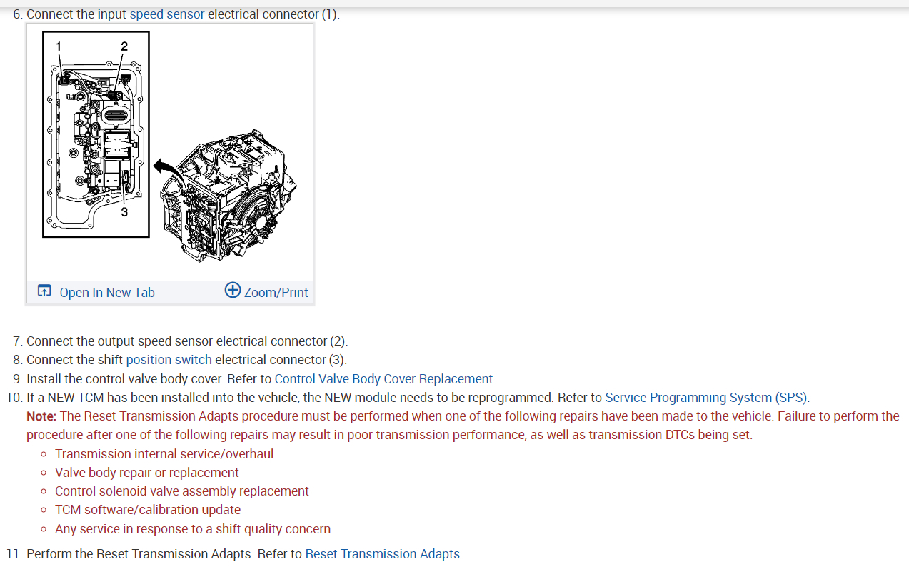

It will not have a pump code until the pump is completely gone, it is just weak which causes the code, but I would still try changing the solenoid first unless you have a transmission pressure gauge that you can take a reading from?
For a 2013 GMC Acadia, the normal transmission fluid pressure at idle should typically range from 58 to 62 PSI. Under load or at higher RPMs, the pressure can increase up to 150 to 250 PSI.
Here is where the gauge plugs into. Check out the images (below). Please let us know what happens.
Oct 11, 2024 at 2:58 AM
