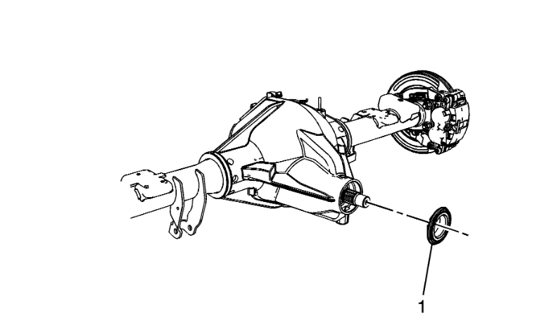

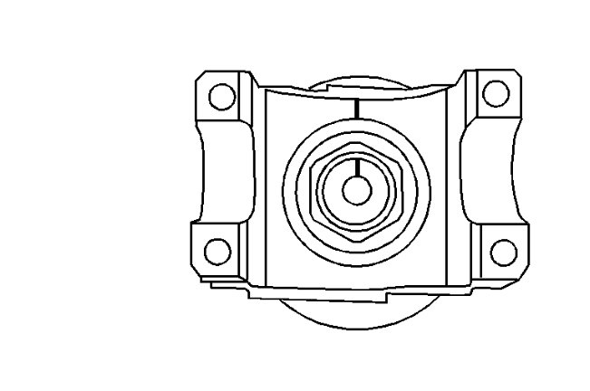

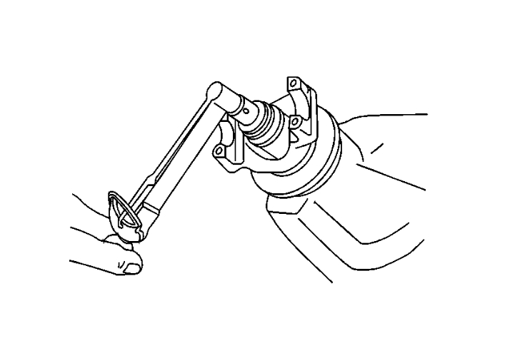

I replace my leaky pinion seal. I used RTV around new seal and splines. I took pictures before removing yoke with marks I made. I noticed when putting on nut marks were gone due to penetrating oil. I use impact gun to get it close to picture of threads. What should I do? Thanks.

First, RTV is a bad idea. Nothing is needed when installing the seal. The RTV will skin over into the fluid and can damage the bearings.
Second, you should have replace the crush sleeve behind the outer bearing. That just pulls off easily and the collar is right there.
Third, the nut needs to be replaced. One time use and throw it away.

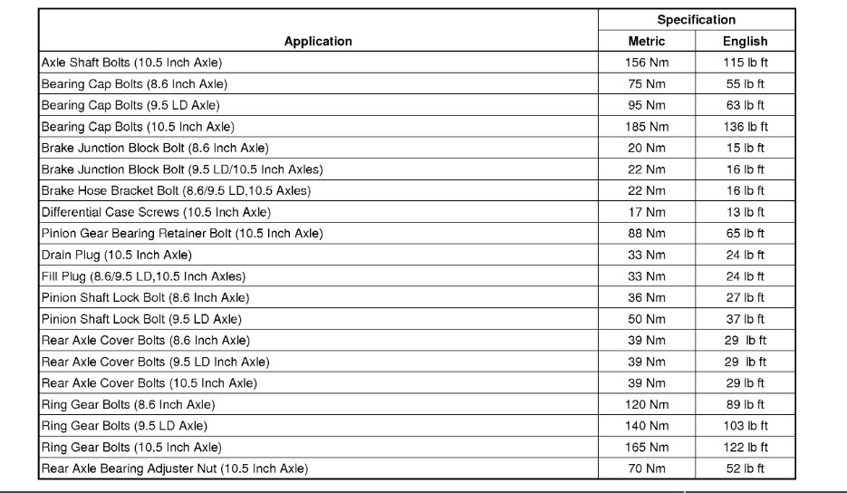

Fourth, you need to torque the nut to a specific ft lb

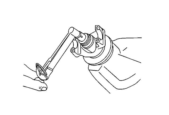

6. Using an inch-pound torque wrench, measure the amount of torque required to rotate the pinion.

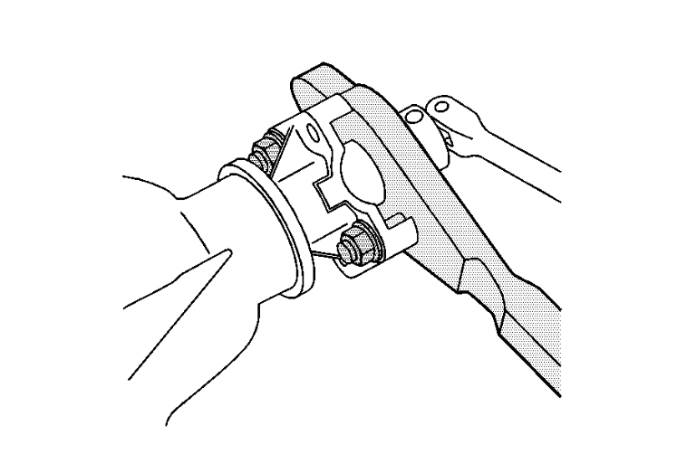

7. Place an alignment mark between the pinion and the pinion yoke.
8. Using the J 8614-01 - holder/remover and holding it, remove the pinion nut.

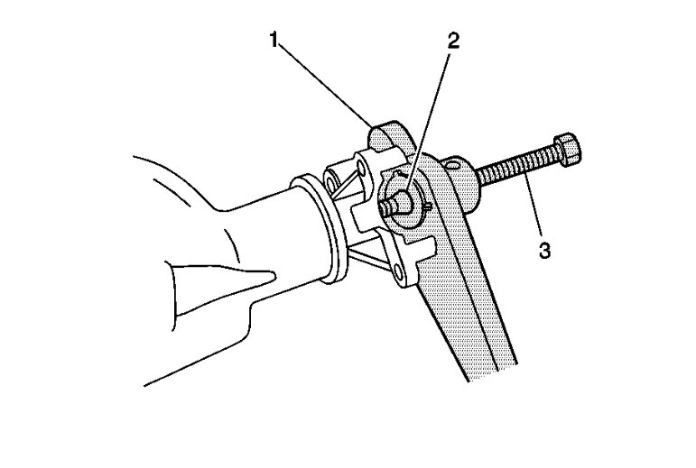

Note: Rotate the J 8614-3 clockwise to remove the yoke.
10. Using the J 8614-2 (2) and the J 8614-3 (3), remove the pinion yoke.
11. Using a suitable tool, remove the drive pinion seal (1).
Installation Procedure
1. Using the J 44414 - installer , install a new pinion oil seal.
2. Apply sealant to the splines of the pinion yoke. Refer to Adhesives, Fluids, Lubricants, and Sealers See: Differential Assembly > Fluid Types.
Caution: Refer to Pinion Flange/Yoke Installation Caution See: Differential Assembly > Vehicle Damage Warnings > Pinion Flange/Yoke Installation Caution.
Note: Align the reference marks and install the drive pinion yoke.
3. Using a soft faced hammer, install the drive flange (1) onto the pinion shaft until a few treads show through the drive flange (1).
4. Install the washer (2) and the nut (3).
Note: If the rotating torque is exceeded, the pinion will have to be removed and a new collapsible spacer installed.
5. Using and holding the J 8614-01 - holder/remover , tighten the pinion nut until the pinion end play is just taken up. Rotate the pinion while tightening the nut to seat the bearing.
Note: Compare this measurement with the rotating torque prior to removing the drive flange.
6. Using an inch-pound torque wrench, tighten the nut in small increments, as needed, until the rotating torque is 0.40-0.57 Nm (3- 5 lb in) greater than the rotating torque recorded during removal.
Note: Recheck the rotating torque and adjust if necessary.
7. Once the specified torque is obtained, rotate the pinion several times to ensure the bearings have seated.
