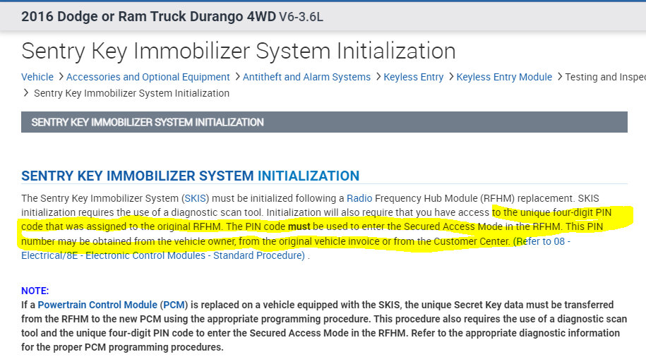

I'm sorry, but that is something we don't have access to. It should be listed on the original vehicle invoice when the car was sold to the first owner, or it needs to be done via a dealership.
Again, sorry about that.
See pic below.

no issue. thank you for your quick replay.
but i thing there is a method to know the RFH pin code from VIN of the car.

Chances are you can get it from the VIN, but a dealer would need to do it for you. I don't have access to anything like that. They keep it under lock and key. LOL
Again, I'm sorry I couldn't get that for you. If you have the original owner's manual, it may be written in there.
