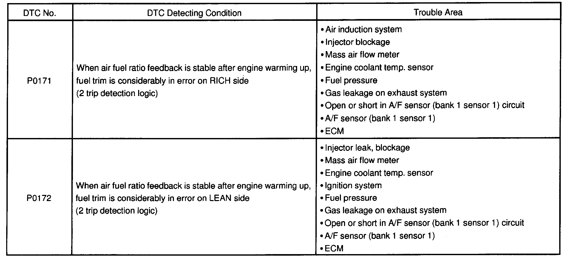

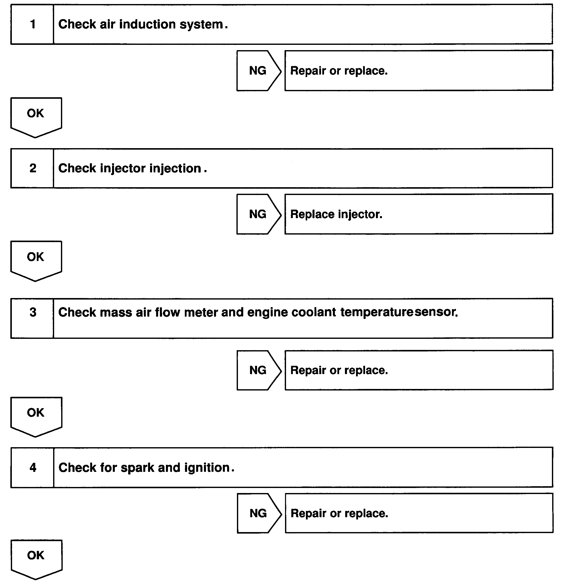

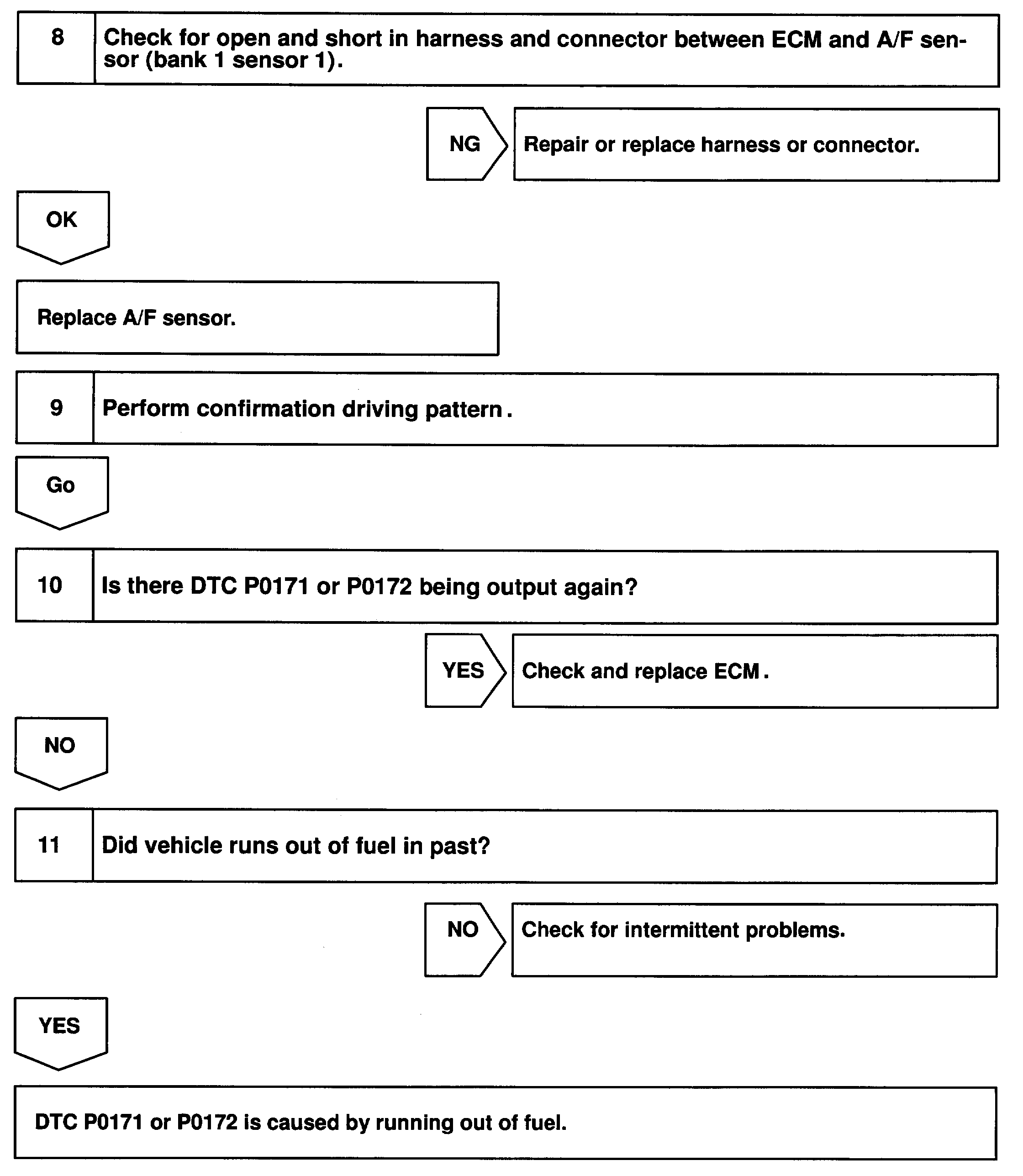

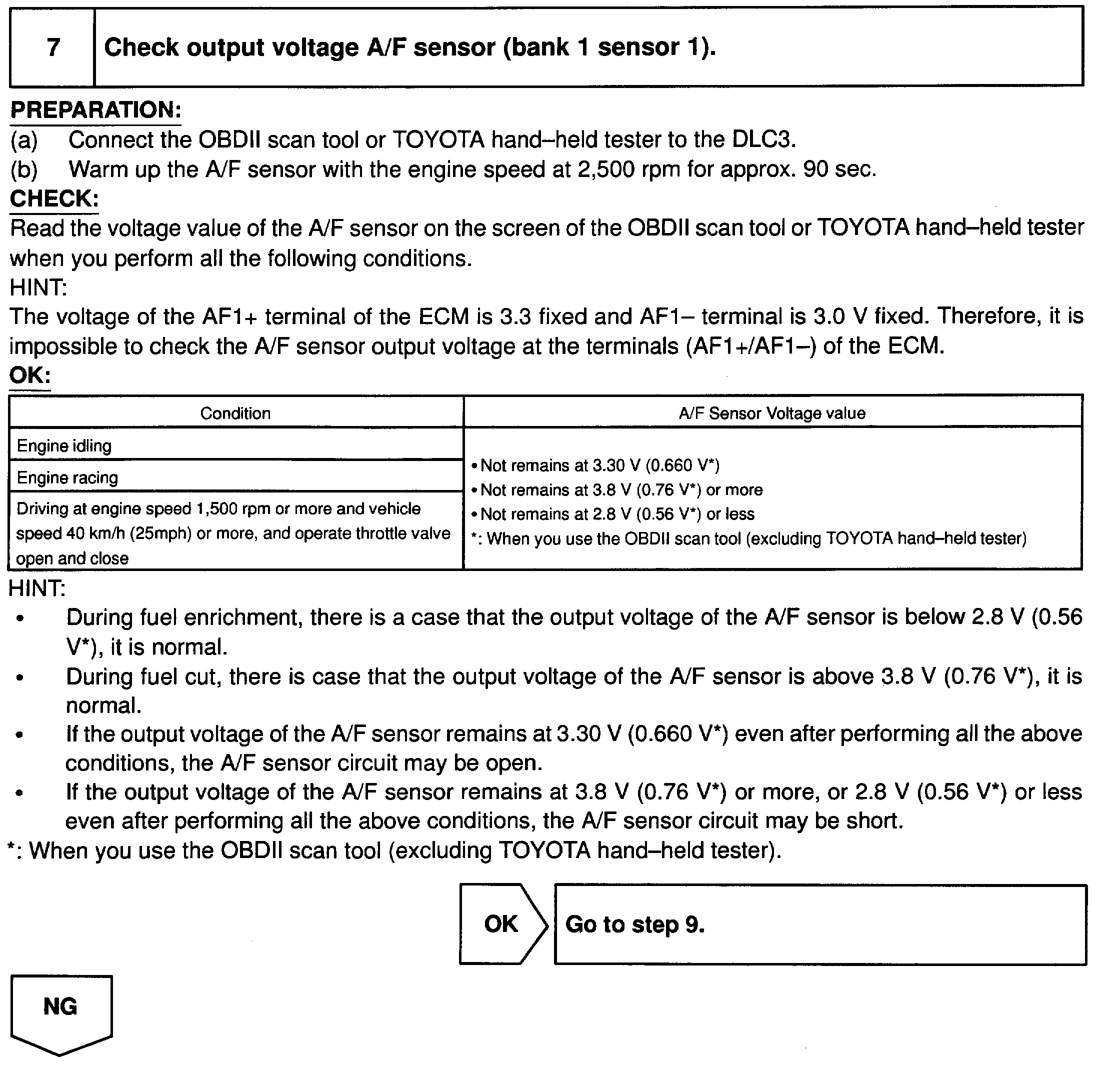

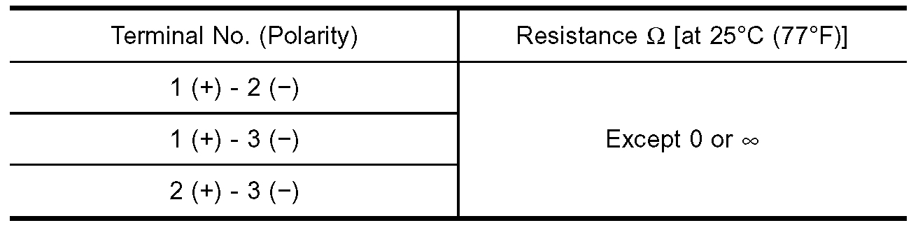

Here is the diagnostic flow chart for the code. The attached pictures correlate with the directions.
_____________________
2001 Toyota Truck 4 Runner SR5 4WD V6-3.4L (5VZ-FE)
Troubleshooting
Vehicle ALL Diagnostic Trouble Codes ( DTC ) Testing and Inspection P Code Charts P0171 Troubleshooting
TROUBLESHOOTING
CIRCUIT DESCRIPTION
DTC Detecting Condition
pic 1
Steps 1 - 4
pic 2

- The A/F sensor (bank 1 sensor 1) output voltage and the short-term fuel trim value can be read using the OBD II scan tool or TOYOTA hand-held tester.
- The ECM controls the voltage of the AF1 - and AF1 - terminals of the ECM to the fixed voltage. Therefore, it is impossible to confirm the A/F sensor output voltage without OBD II scan tool or TOYOTA hand-held tester.
- OBD II scan tool (excluding TOYOTA hand-held tester) displays the one fifth of the A/F sensor output voltage which is displayed on the TOYOTA hand-held tester.

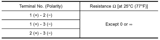

Wiring Diagram
pic 3

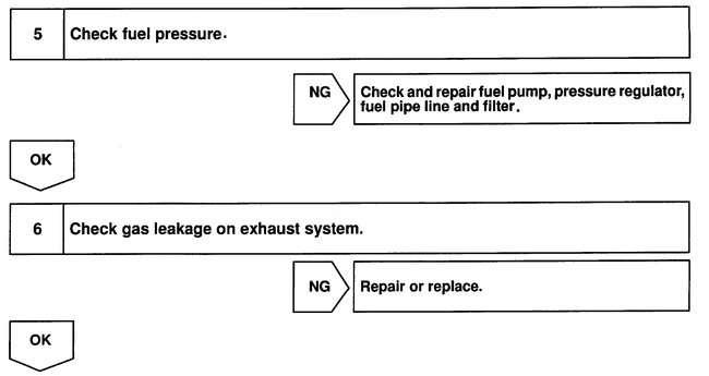

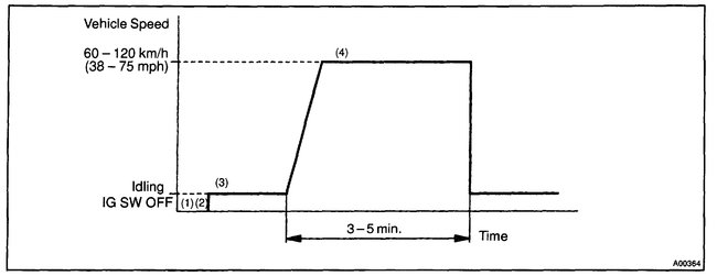

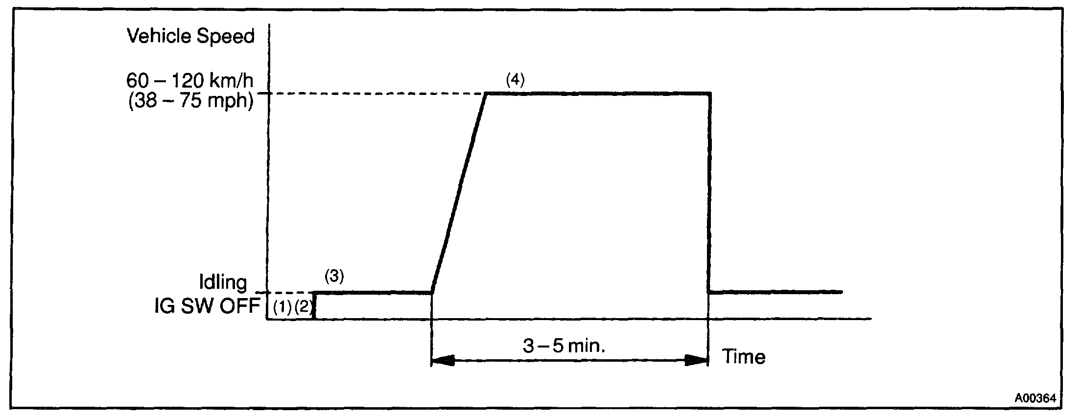

CONFIRMATION DRIVING PATTERN
pic 4
1. Connect the TOYOTA hand-held tester to the DLC3.
2. Switch the TOYOTA hand-held tester from the normal mode to the check mode.
3. Start the engine and warm it up with all the accessory switches OFF.
4. Drive the vehicle at 60 - 120 km/h (38 - 75 mph) and the engine speed at 1,600 - 3,200 rpm for 3 - 5 min.
HINT: If a malfunction exists, the MIL will light up during step (4).
NOTE:
- If the conditions in this test are not strictly followed, detection of the malfunction will not be possible.
- If you do not have a TOYOTA hand-held tester, turn the ignition switch OFF after performing steps (3) and (4), then perform steps (3) and (4) again.

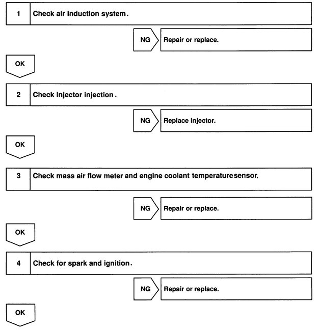

Steps 5 - 6
pic 5
Step 7
pic 6
Steps 8 - 11
pic 7
