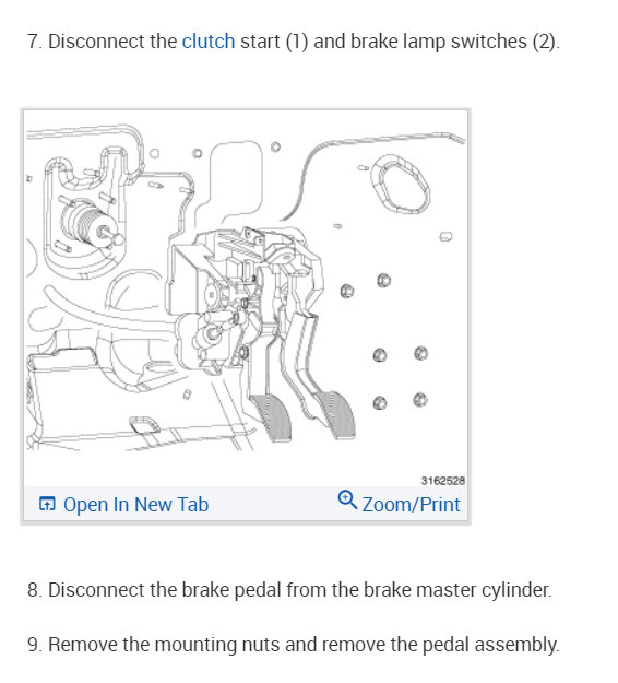

  • 55,399 POSTS
Here is a picture of one the clutch master is attached at the clutch pedal. Check out the diagrams (below). Please let us know what you find. Can you take a picture of yours please that way we can be on the same page?

  • 8 POSTS
Excuse me Ken for being late in reply, actually I was figuring it out during this time but I couldn't. my car has not clutch master or a pump for clutch, actually it uses a clutch wire instead of.
Now what can possible go wrong with my gear 1?
