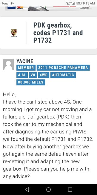

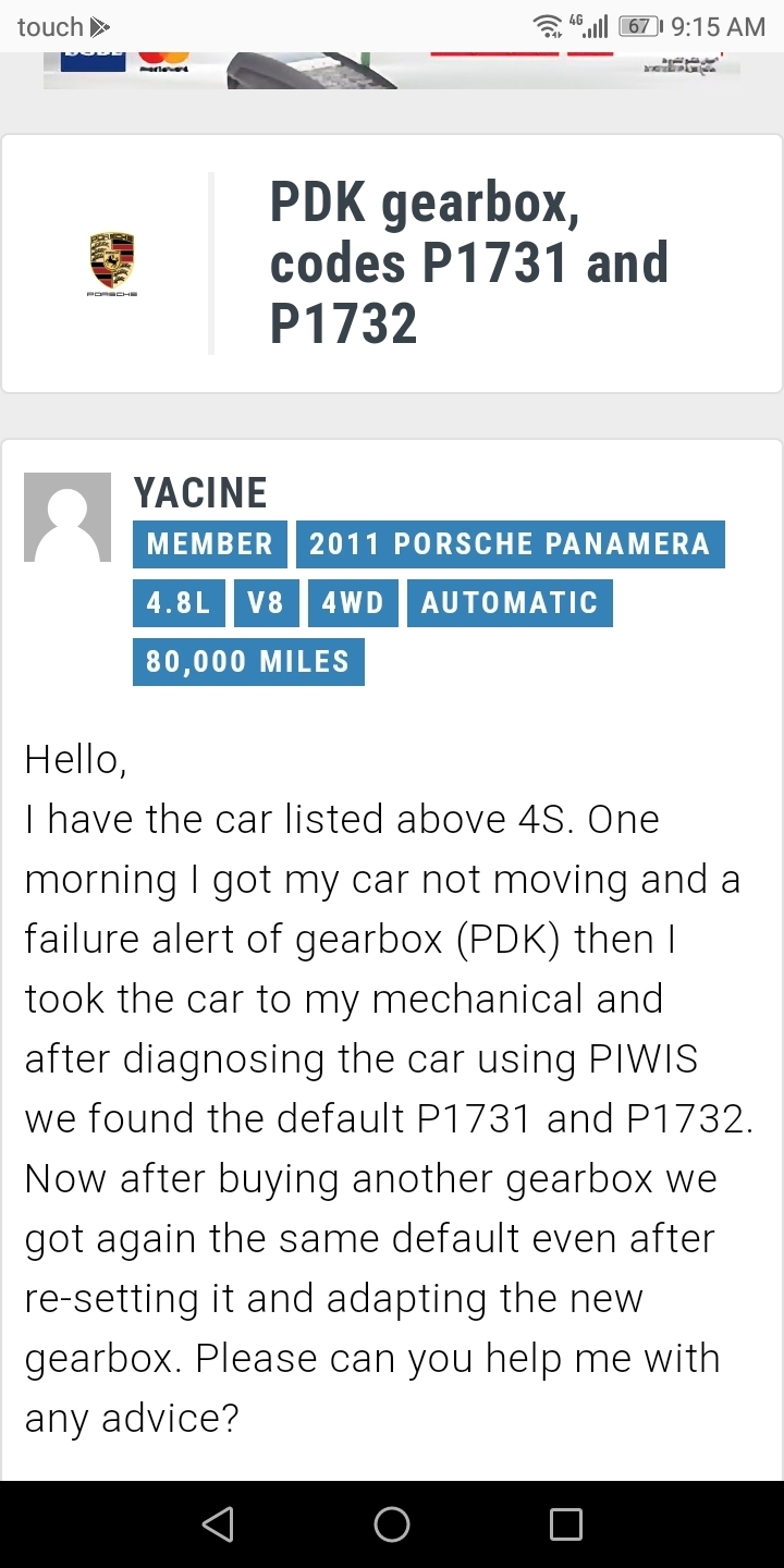

This screen shot the I send is from your forum it is like my issue after replacing transmission and cu he got fault code p0846 pressure sensor 2short to b+ and mine is p0843 pressure sensor 1. not mentioned at the end what was his solution I wanted to know please.

I was unaware of the P181A. That is the opposite end of the spectrum as far as pressure. When that code is set with P0843, the problem is usually related to sensor grounding and not a short to B+. Are you sure the ground is equally as good?
I'm sorry. Not being there to see what exactly is happening and how things are being checked makes it difficult. I hope you understand.
Everything I have checked indicates when both codes are present, there is a ground problem.

  • 110,194 POSTS
Hi:
I'm sorry but there was no resolve to that problem listed. If the tech found one, he never posted it. I checked for you.
