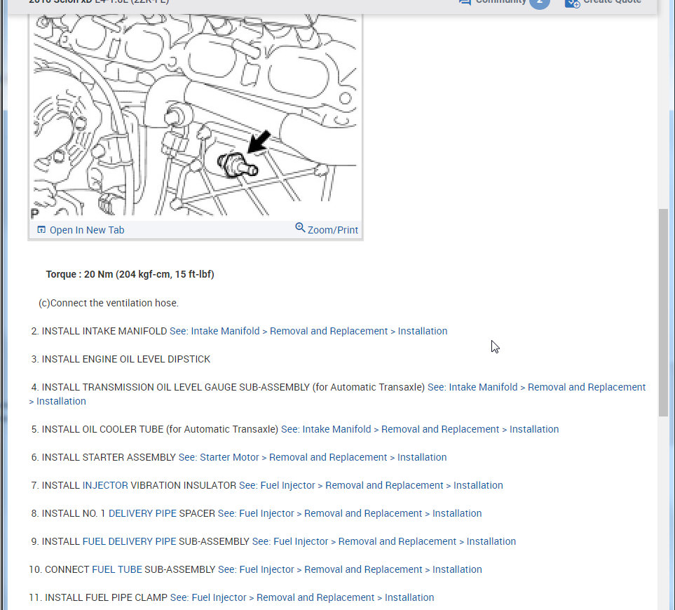

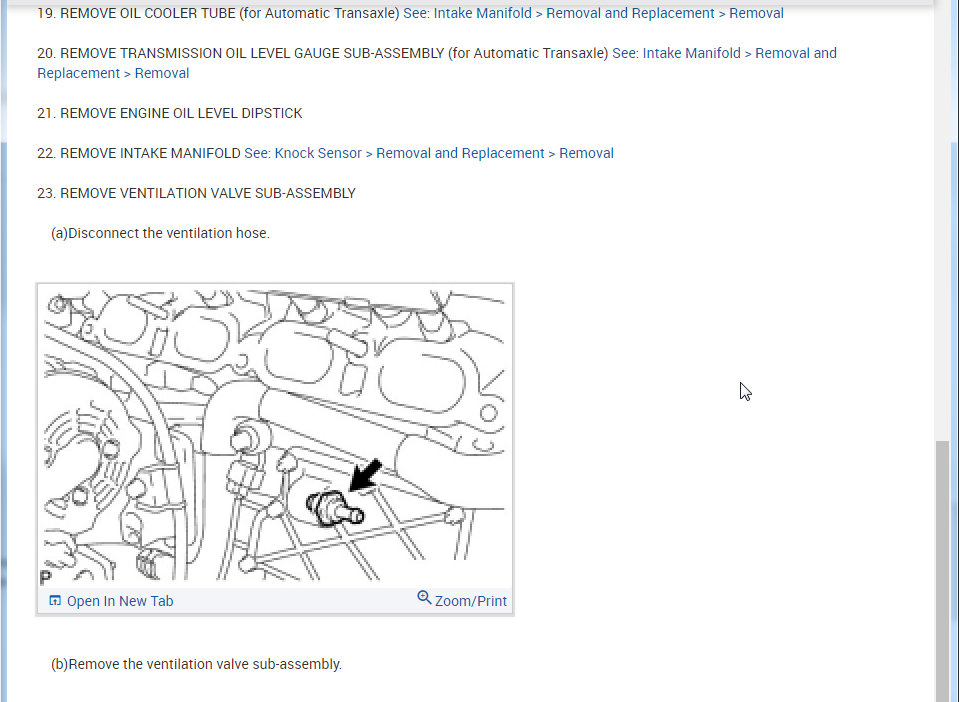

Where is it locate and how often we need to do the replacement?
Wednesday, October 28th, 2020 AT 2:42 AM
3 Replies

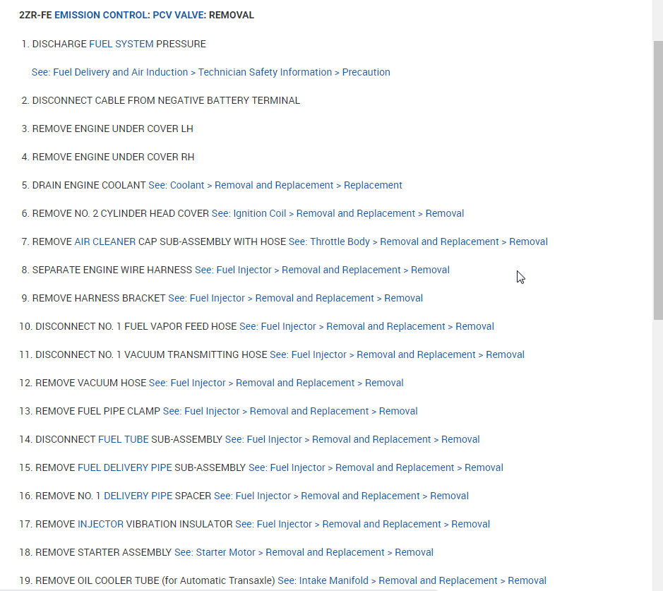

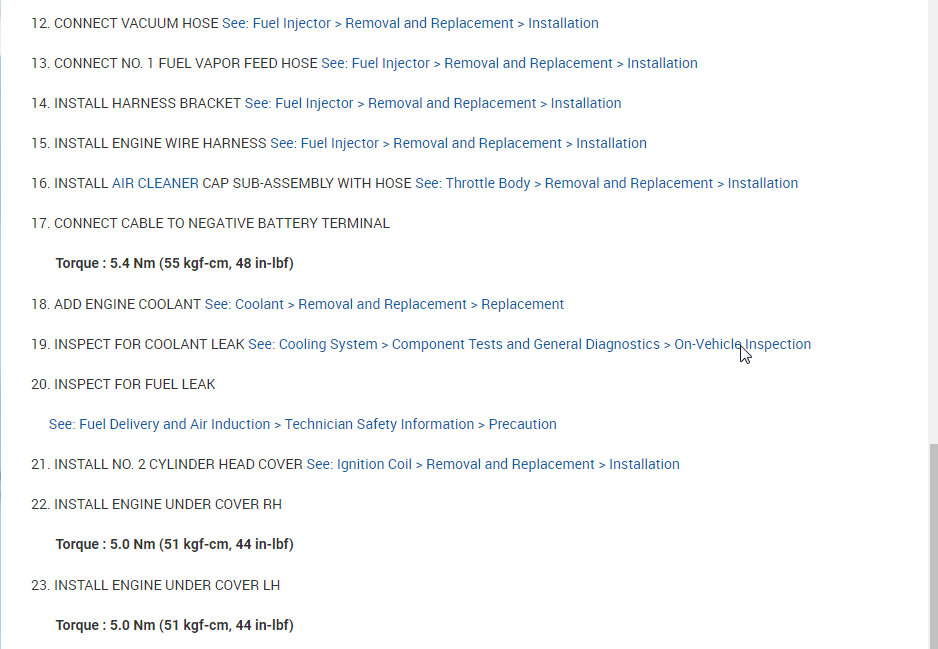

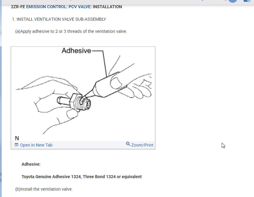

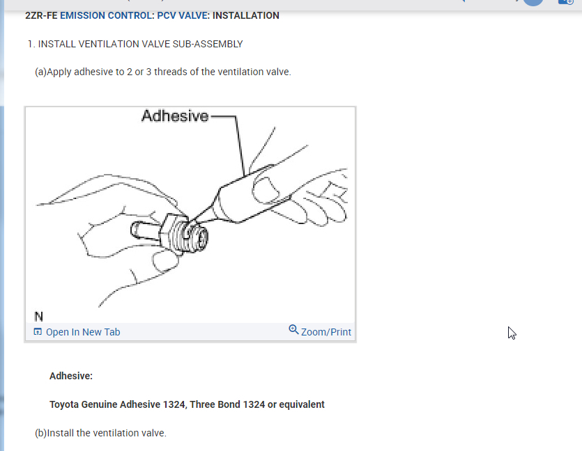

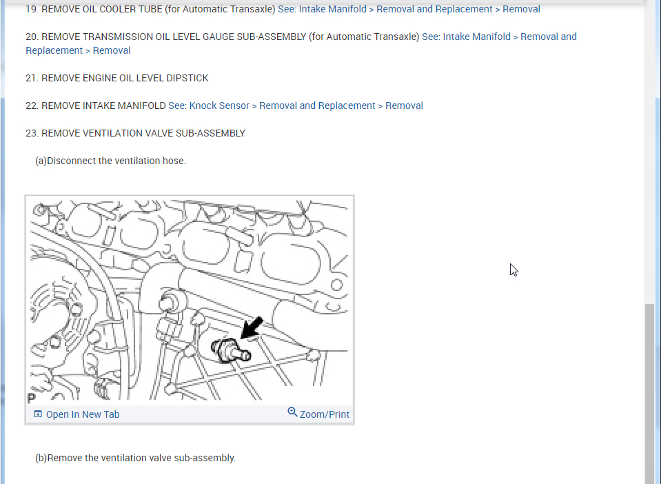

I attached the info from the manual on the PCV. Let us know if you need more info. Thanks

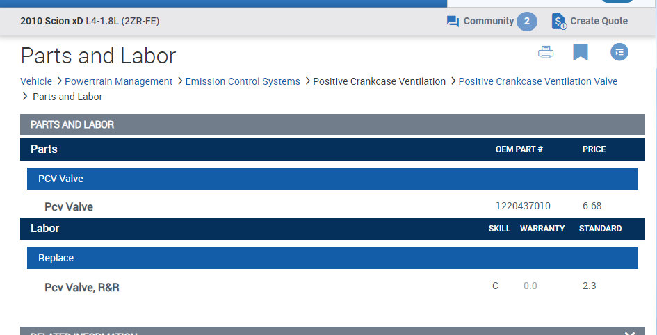

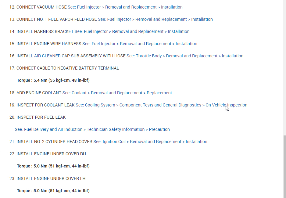

FYI the last attachment shows the part number and labor time to give you an idea of how involved it is. This shows 2.3 hours to replace it so it is not the easiest to replace.
Wednesday, October 28th, 2020 AT 12:45 PM
