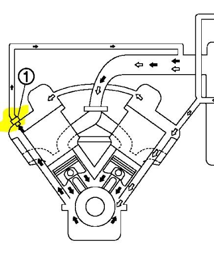

where is the PCV valve location on driver side? I only found the PCV valve on the passenger side. There should be on on each side.

There is only one. I attached a pic of the system for you to see how it works. There is only one crankcase to vent, so it is done with just the one valve.
