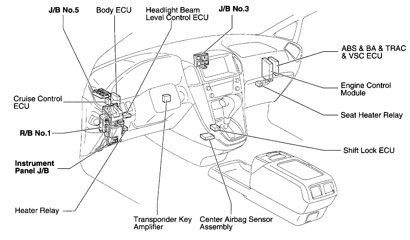

The PCM and BCM work together with the immobilizer, I would run a CAN scan which is easy to do to see what codes come up before replacing anything. You can get a CAN scanner (Controller Area Network) which will work on most cars from Amazon.
https://youtu.be/u-4syLc-ifQ
Here is how to replace the PCM and BCM in case you need it, you can get a preprogrammed unit by searching Google or Ebay. Check out the images (below). Please let us know how it goes

Yes, it should, the PCM and BCM work together with the immobilizer. Can I ask if you have checked the fuses? Please check them with the systems on.
This guide can help:
Please let me know what happens.

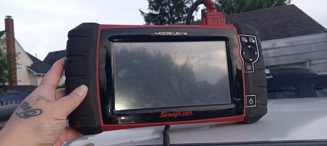

The fuses are good. We just started the car with the scanner plugged in and it stays running until we unplug it. Will a bad ECU do that? This is the scanner he has.

DAWNHOOVER
  • 30 POSTS
I found the problem, one of my ground wires was not bolted to anything. Hooked it up and she started right up, no more check engine light or trac off light. She runs like a new car. Should last me a while it's 23 years old but she's in great shape and only has 130,000 miles. Thank you so much for your help...
