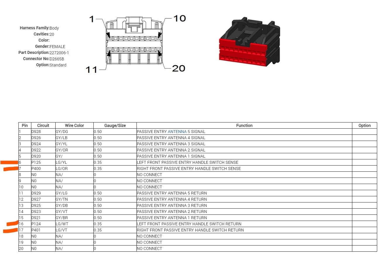

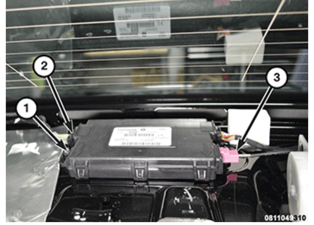

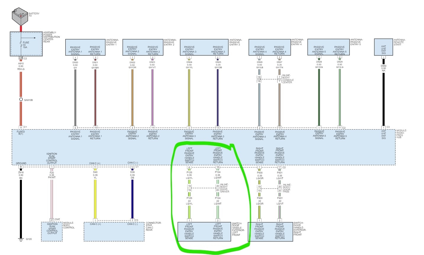

Does your scan tool allow you to look at the radio frequency hub to see the lock inputs? This issue wouldn't set a code. However, this does sound like the wiring itself is damaged. It has to run from the handle through the door and through the body to the RFH. The OE scan tool has an option in the hub menu to test the wiring to the handles. Without that you would need to go to the hub located under the rear package shelf trim. Remove the red C2 connector and unpin and reverse the wires for the left and right handles. If the left side works using the right-side input, then you know the issue is either the wiring or the handle you have is bad. I suspect it's the wiring though. Possibly it broke in the section between the door and body and the damage finally broke it there.

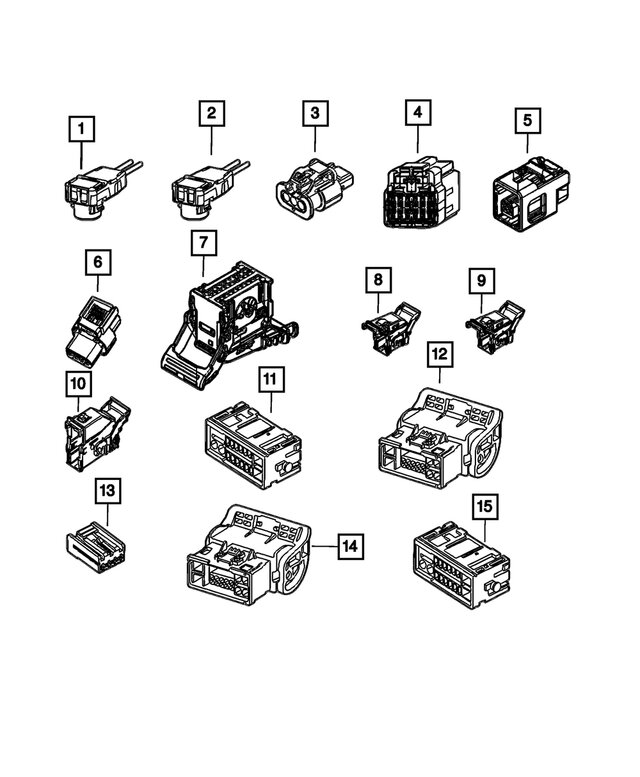

I have a blue driver ob2 scanner, I am going to do some research and see if there's a radio frequency hub with that scanner because I don't know what that would look like. I had bought piece #5 for the handle and that's what got installed also.
Jul 23, 2023 at 5:16 AM
STEVE W.
  • 15,344 POSTS
Okay, that is the connector, I suspect it is the actual wires themselves, not the connector. Not sure if that tool reads that item or not. Alpha OBD has it listed but only for the pro version.
