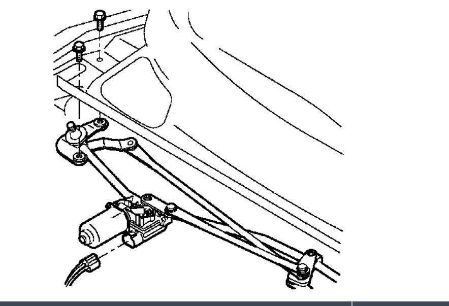

Is there a easier way to get to the bolts than removing the whole windshield wiper assembly?
May 21, 2020 at 4:21 AM
Good morning,
No, there is not. This is one of the times you want the guy that designed this to actually perform this procedure. It is a very poor design for anyone who needs to do this.

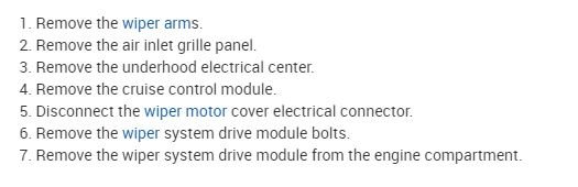

1. Remove wiper module.

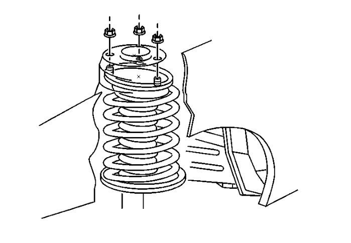

2. Remove the upper strut mounting nuts.

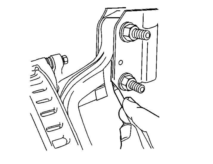

5. Scribe the strut to the steering knuckle.

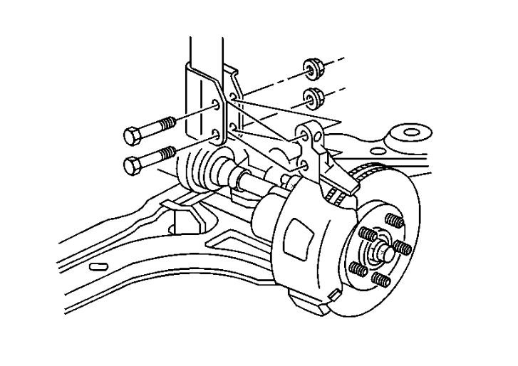

6. Remove the strut lower mounting bolts and nuts.
7. Remove the strut.

2. Install the strut upper nuts.
Tighten the strut upper nuts to 30 Nm (22 ft. lbs.).

4. Install the strut lower bolts and nuts. Hand tighten only.
