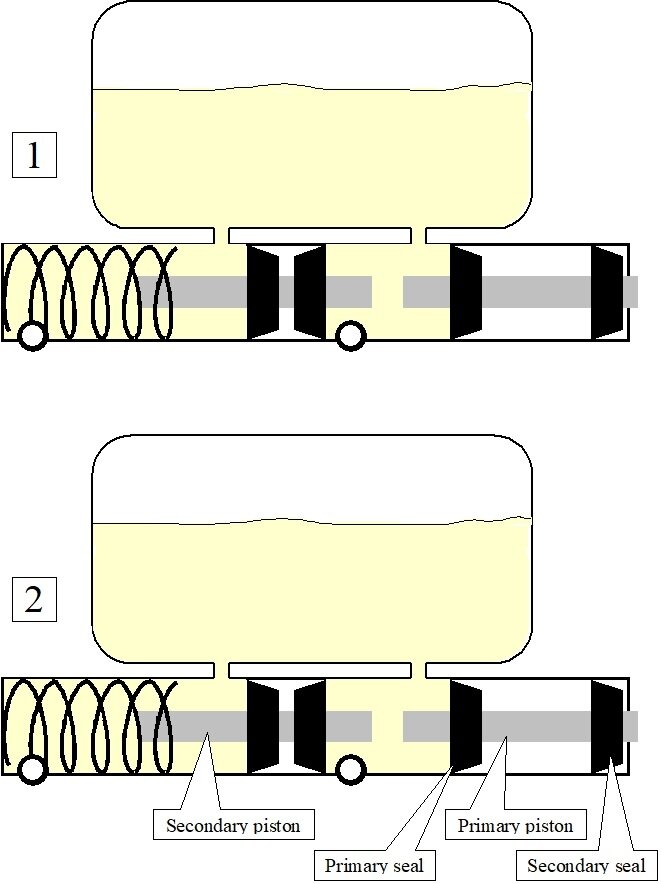

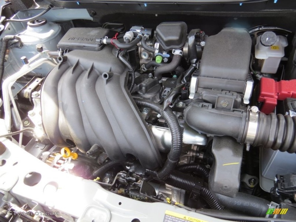

Hello ladies and gentlemen, I was wondering what a brake master cylinder is made of, in the photo below I can see the brake fluid reservoir located behind the positive battery terminal and right next to the air filter housing or air filter cover, underneath the brake fluid reservoir I see a metal thing with lines connected to it, is that the brake master cylinder and what is it made up of? I heard it's made up of a piston but does that piston look the same as an engine piston? does it have a piston pin, piston pin circlips, connecting rod? also if the brake fluid inside the plastic reservoir, if the brake fluid oxidizes or deteriorates will that compromise braking operation or safety? I see in the internet photo of another 2014 Nissan Versa SV engine that its battery is covered with a very long plastic cover on it and all around it, our battery doesn't have this cover and does that mean that it might fall off from the battery tray in the engine compartment? below is my internet photo of the 2014 Nissan Versa SV engine that I took from the bing images search website so you can reference it, thank you in advance for your information, Alex Stathas

There's actually two pistons in all brake master cylinders. You can get a start by looking at this article:

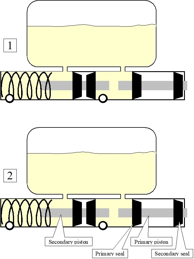

You didn't know what you were in for when you asked how a master cylinder works.
The first drawing shows the dual master cylinder at rest. Dual systems have been required since the late 1960s. If a leak develops in one half of the hydraulic system, You'll still have the other half that works, but with reduced stopping power.
The important parts are listed in the second drawing. The primary piston is the one pushed on by the brake pedal through a push rod and / or power booster assembly. The primary and the secondary pistons each have a primary and a secondary rubber lip seal.

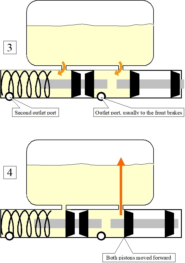

The pistons are still at rest in the third drawing. The orange arrows show where brake fluid runs into the cylinder bore through a pair of "replenishing" ports. They're also called the "return" ports where the brake fluid returning from the wheels flows back up into the reservoir. If a bleeder screw at a wheel is opened, gravity can draw brake fluid down through the replenishing port, through the chamber ahead of the primary piston, then out the port and down to the wheel. Gravity-bleeding is the best way to bleed brakes, but it takes the most time.

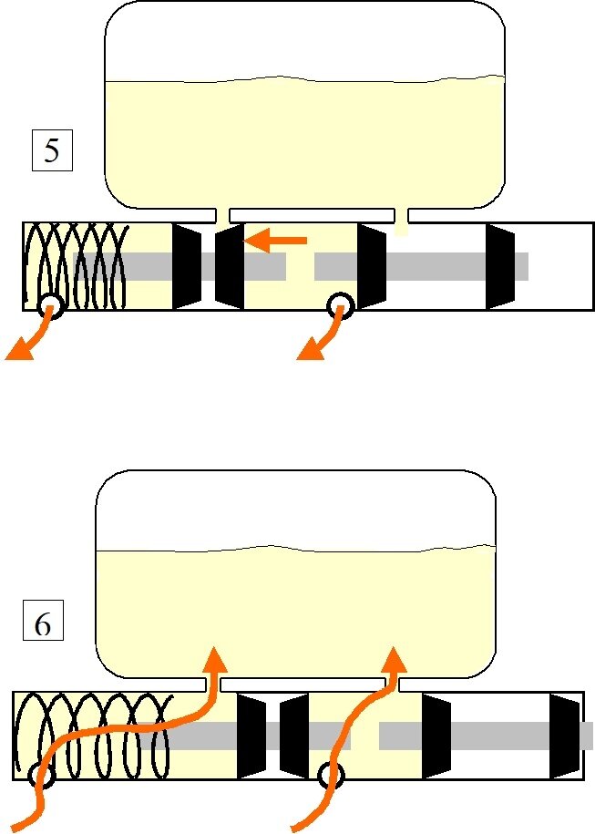

The excitement starts in the fourth drawing. The primary piston has moved forward about 1/4" That equates to roughly the first one inch of brake pedal travel. The brake fluid looks for the easiest place to go. That is up through that replenishing port into the reservoir. This produces a potential clue when diagnosing the system. If you watch in the reservoir with the cap removed, you will usually see the spurt of fluid jump up when a helper presses hard and fast on the brake pedal. When you don't see that spurt of fluid, it is possible the primary lip seal is torn. It will leak internally, meaning the fluid can bypass that seal and not become pressurized. There will already be fluid between the primary and secondary seals. The secondary seal prevents fluid from being lost to the power booster or from running out in front of it.
In the fifth drawing, the brake pedal has been pushed a total of roughly two inches. The primary seal on the primary piston has moved just past the replenishing port. At this point the brake fluid is trapped and can't go back up into the reservoir. As the pedal and piston continue to move, pressure builds forcing the fluid to go two places. The first is out the port to one pair of wheels. The second is it pushes the secondary piston forward by pushing on its primary seal. As that piston moves, its secondary seal has also moved past its replenishing port, so that fluid is trapped and now is pressurized and will get pushed down to its two wheels. There is no mechanical connection between the primary piston's secondary seal and the secondary piston's primary seal. Brake fluid is all there is to push on the secondary piston.

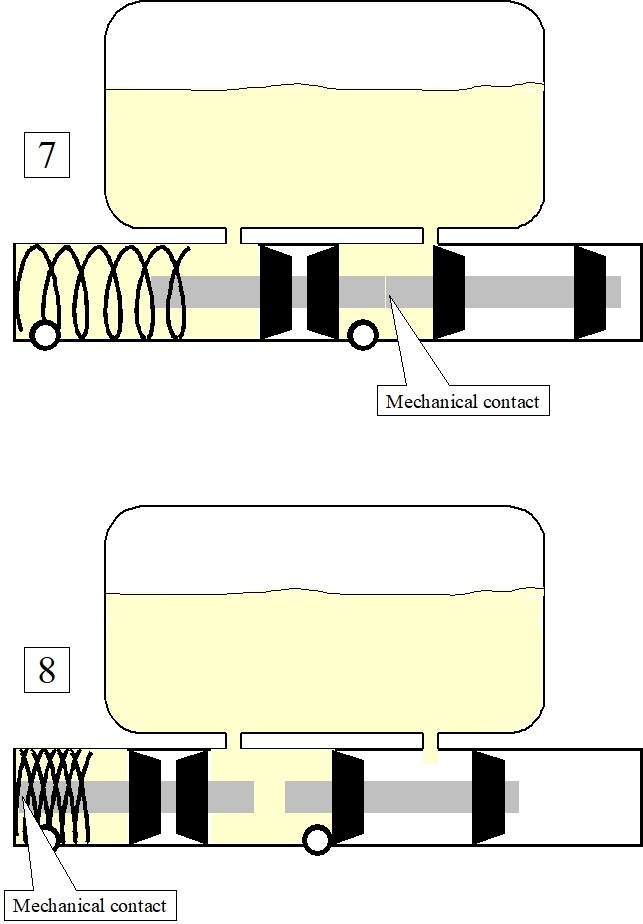

Defects

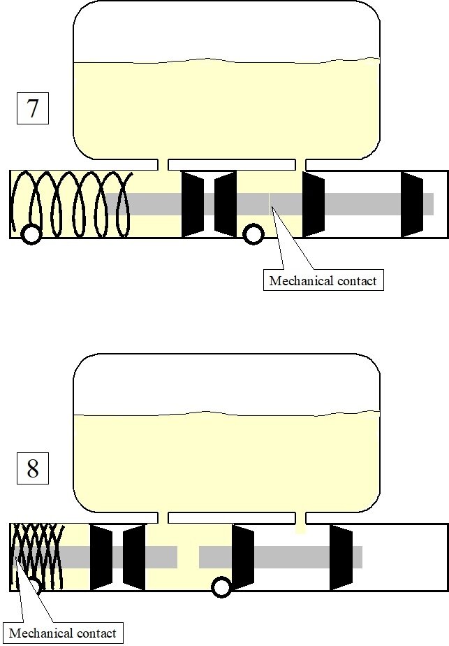

In the seventh drawing, a major leak has developed such as a ruptured flexible hose or a rusted steel line. No pressure can develop with that leak so the brakes for those two wheels don't apply. Brake fluid is lost from that leak, and it can't push the secondary piston forward. The brake pedal will move a lot further than normal, then the primary piston will make a mechanical contact with the secondary piston, and move it to apply that half of the brakes. That mechanical contact is a backup design that allows some stopping power when a leak occurs. This also works when an internal leak develops inside the master cylinder.
If a leak develops in the secondary circuit, there's no pressure built up in the front section, (left side in the eighth drawing). That piston moves so easily, no fluid pressure can build up in the primary chamber either. Here again, the brake pedal will move much further than normal, but as the brake fluid in between pushes the secondary piston as far as possible, it runs into the end of the bore, inside the spring, then can't go any further. Now any further pedal movement will build fluid pressure in the primary circuit.

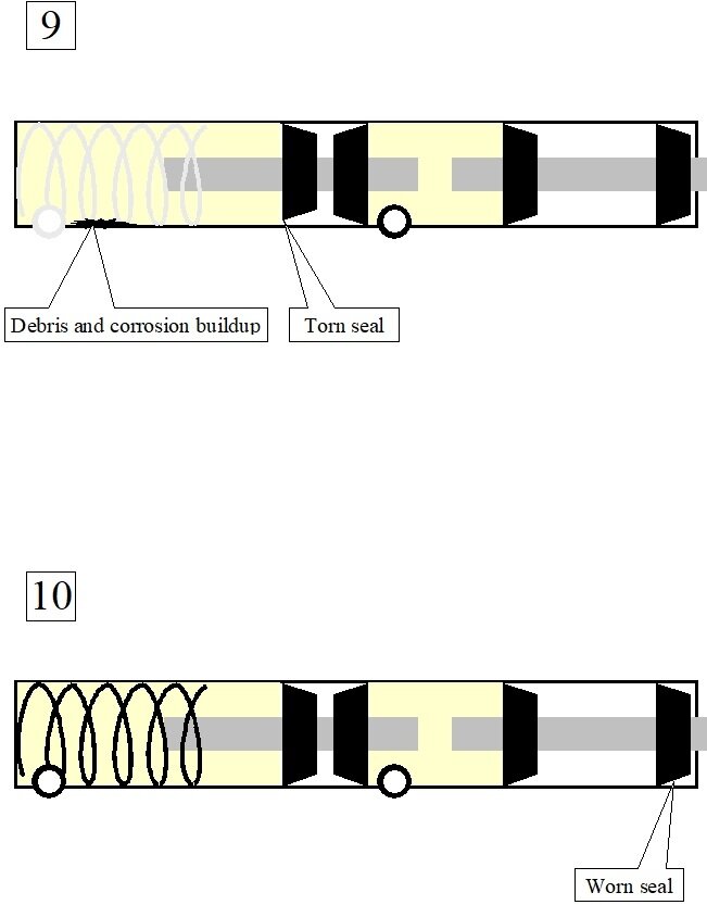

Drawing nine shows a common failure that is easy to prevent. Most brake systems will work fine for many years before a problem develops. In that time, the brake pedal never travels more than halfway to the floor. The pistons and seals in the master cylinder travel back and forth in the upper halves of their bores. Thanks in part to the moisture that sneaks in, crud and corrosion develops in those areas where the seals don't normally run. At some point a leak will develop, then the pistons travel further and a seal gets run over that crud. That can rip the seal resulting in a slowly-sinking brake pedal. That often takes two or three days to show up. This is internal leakage inside the master cylinder. No brake fluid is lost, but none gets pushed down to the two wheels in that half of the system.
Kits with new pistons and seals are available for most applications to repair the master cylinders, but they are not a good value. This should only be done when it's the only option. A professionally-rebuilt master cylinder with a warranty commonly costs less than the kit. Also, since the late 1970s, most master cylinders are made of aluminum. That corrodes very quickly except the bores are treated with an anodized coating. That's an electroplating that seals the metal. Metal tools or hones used to remove the debris will remove some of that coating. Another failure will occur very soon.
This same ripped seal is often caused by improper bleeding techniques. Inexperienced mechanics, and even some service manuals will tell you to bleed the brakes with a helper to push the brake pedal to the floor. That's fine with a new master cylinder that's less than about a year old. That corrosion hasn't had time to develop yet. After reading that, most people follow those instructions with older master cylinders that do have that corrosion, and that's when the problem occurs.
The same thing can happen when just replacing the front brake pads. The pistons in the calipers have to be pressed in to make room for those new, thicker pads. The final step is to pump the brake pedal multiple times to run the pistons back out to adjust them. The first couple of pumps can allow the brake pedal to reach the floor, then there's that ripped seal. To prevent that, never push the brake pedal more than halfway to the floor.
A less-common failure in drawing ten has to do with a leaking secondary seal on the primary piston. Brake fluid ahead of it is never under pressure, but if it sneaks out, it causes an elusive loss of fluid that's hard to identify. With a power brake booster, the fluid could run down in front of it, but it's more likely to run inside, then get sucked into the engine and burned. The level will drop in the reservoir very quickly, as in days or weeks. When there's no power booster, brake fluid can run down the firewall under the hood, or inside onto the carpet.

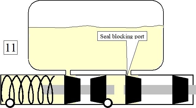

I saved the worst disaster for the last. That's when the brake fluid gets contaminated with a petroleum product. In one case over a dozen vehicles received expensive damage when a pressurizing brake "bleeder ball" was refilled with four gallons of fresh brake fluid using a funnel that was wiped out after being used with engine oil. The light residue in the funnel was enough to cause problems. Brake fluid is a glycol product. Rubber parts compatible with brake fluid are not compatible with petroleum products including engine oil, transmission fluid, penetrating oil, axle grease, and power steering fluid. Those products will make the seals grow and become mushy and slimy.
The first symptom takes about a week to show up. That will be dragging brakes that won't release. That can get bad enough that the vehicle won't move, or the brakes will get really hot. Often the brakes will gradually release after a few hours, but they'll lock up again right away on the next drive cycle.
What happens when the seals expand is they grow past the fluid return ports to the reservoir. That's in the 11th drawing. Brake fluid is trapped ahead of the seals the same as when the brake pedal was pressed that first inch. Pressing the pedal may push a little more fluid down the lines, but then it can't release back into the reservoir. That keeps the brakes applied while driving. They heat up very quickly, then that heat migrates through the calipers and into the brake fluid. The fluid expands, and since it can't expand into the reservoir, it applies those brakes even harder.
