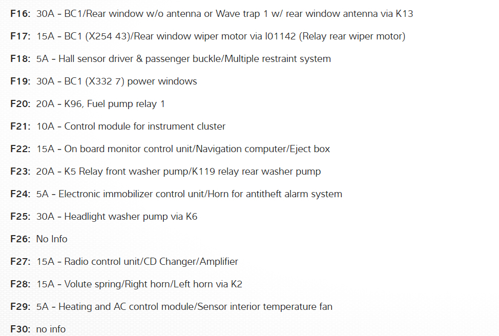

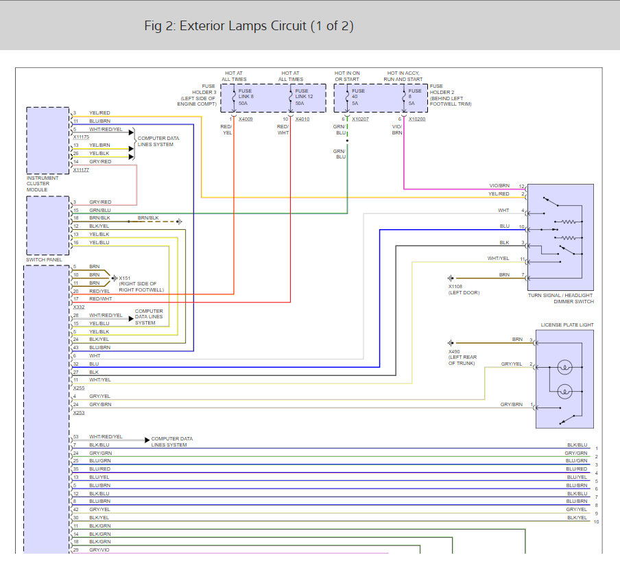

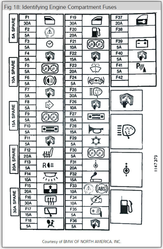

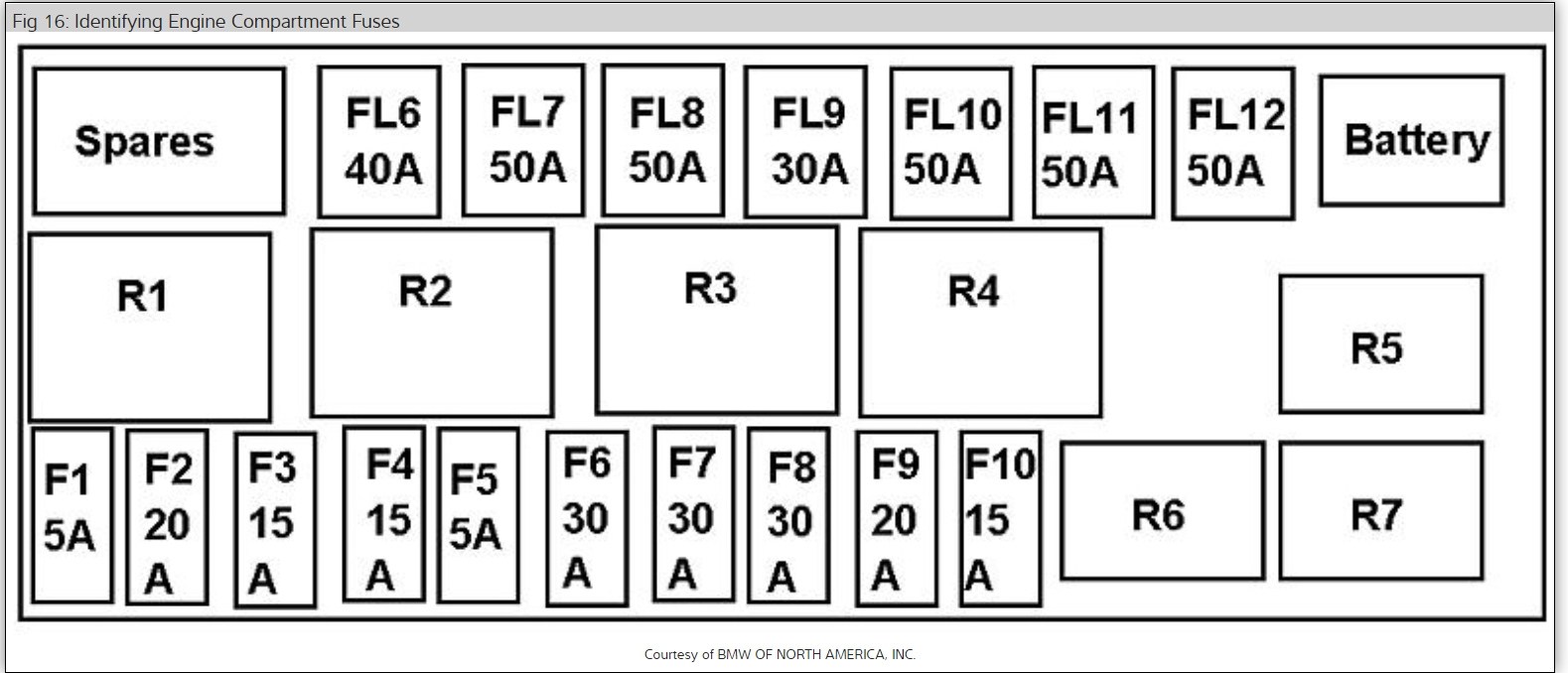

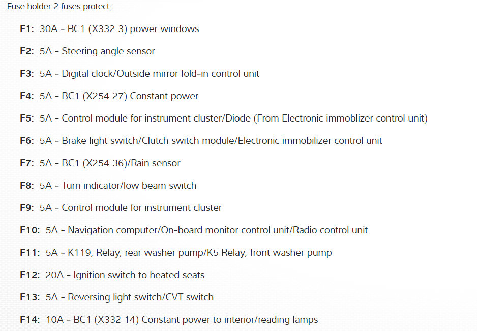

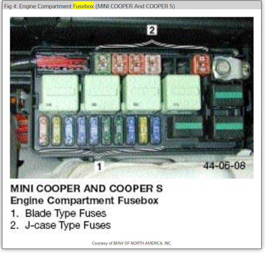

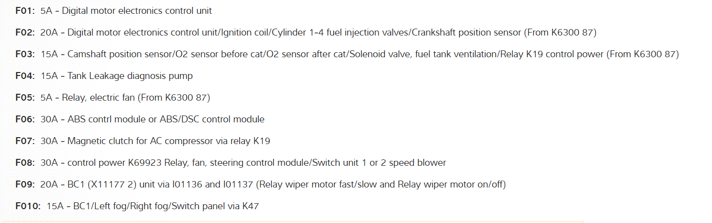

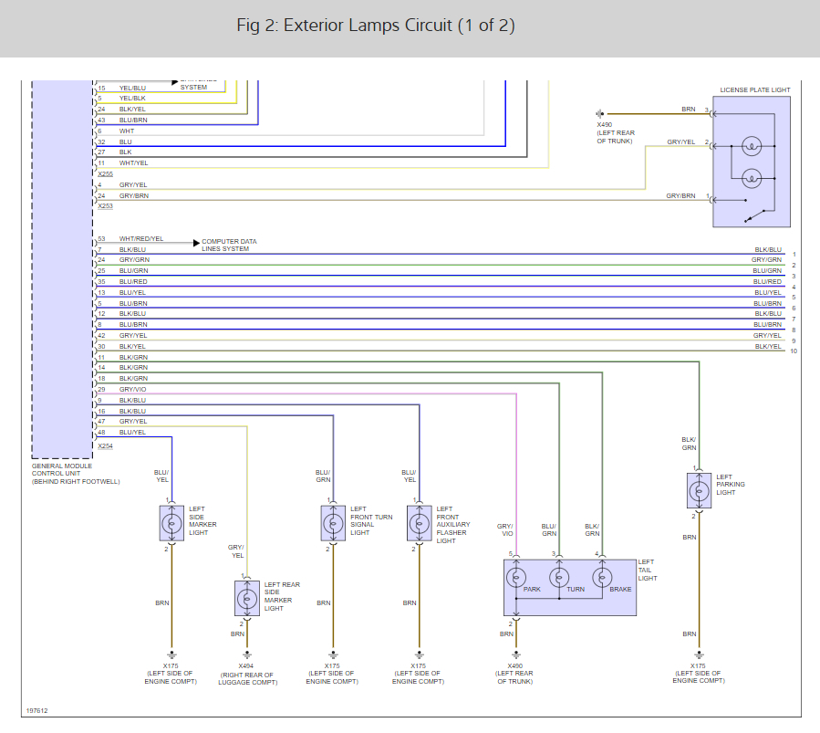

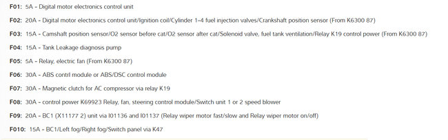

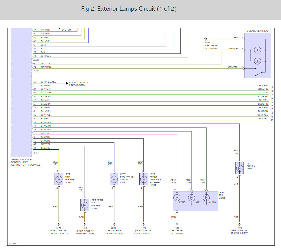

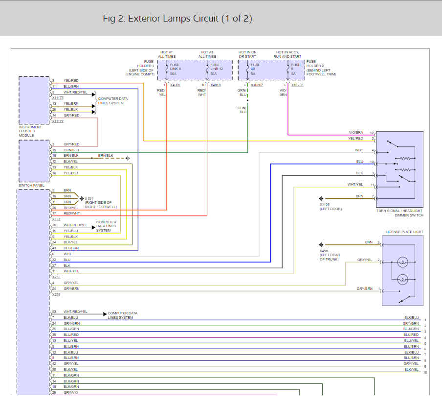

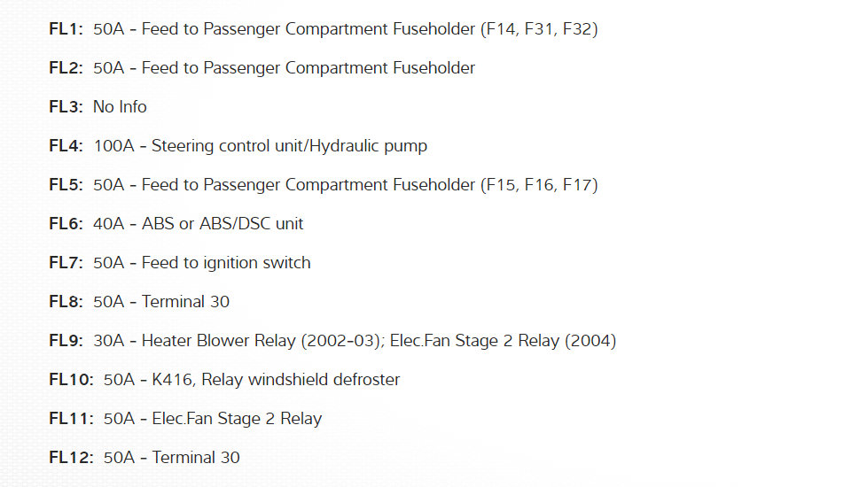

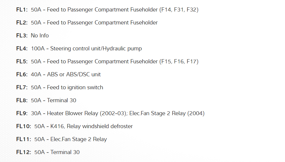

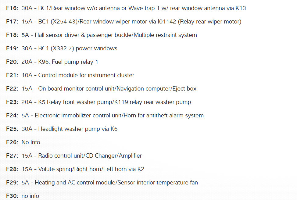

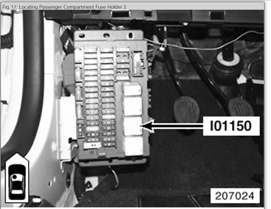

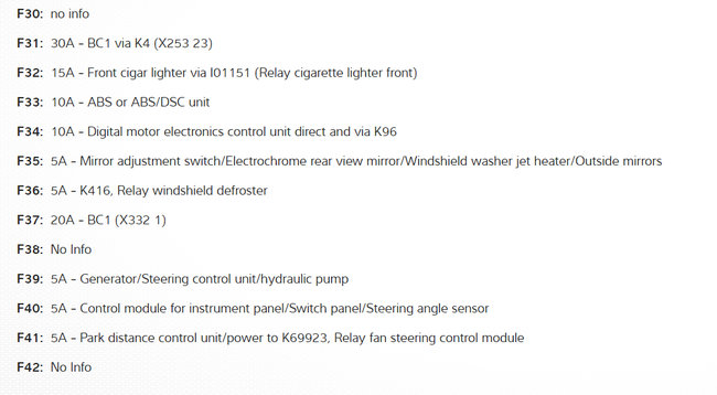

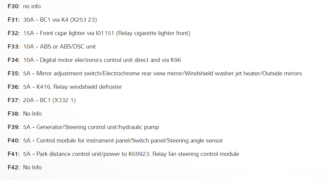

I would check fuse #40 and #5 which control the switch and general lighting module. Next I would unplug the headlight switch to see if they go out. Here is a guide to help you test the fuses and the fuse location as well as the running light wiring diagrams so you can see how the system works:
Check out the diagrams (below). Please let us know what you find.
