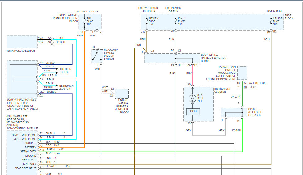

What causes these dash lights to pop up from time to time? Seems like everytime I hit a dip in the road, it triggers. I happened on my 2001 Yukon too. Loose ground? If so, where . I don't know alot about this topic

Hello again.
Yes, it is possible you may have a loose or faulty ground connection causing this issue. Here is a wire testing tutorial for you to view:

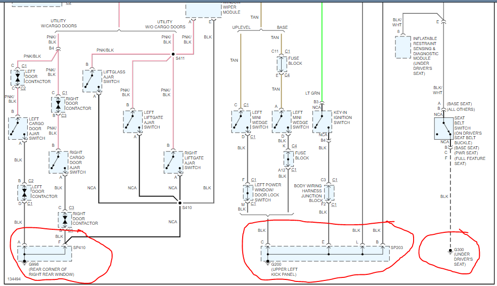

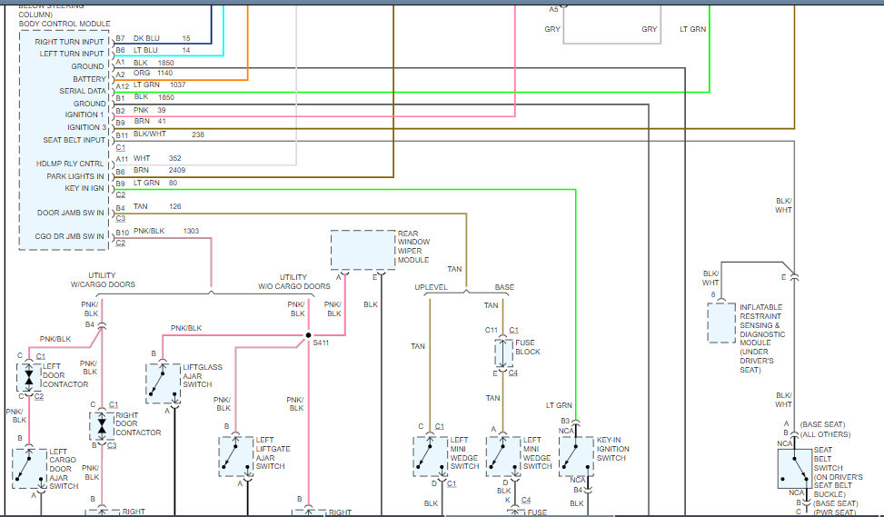

I've attached a warning light-instrument cluster wiring diagram below for your GMC. I've cut the picture into 3 pieces so you can view larger. I've also circled in red the 3 major grounds you should inspect. Keep us updated and let us know what you find. Hope this helps and thanks again for using 2CarPros.

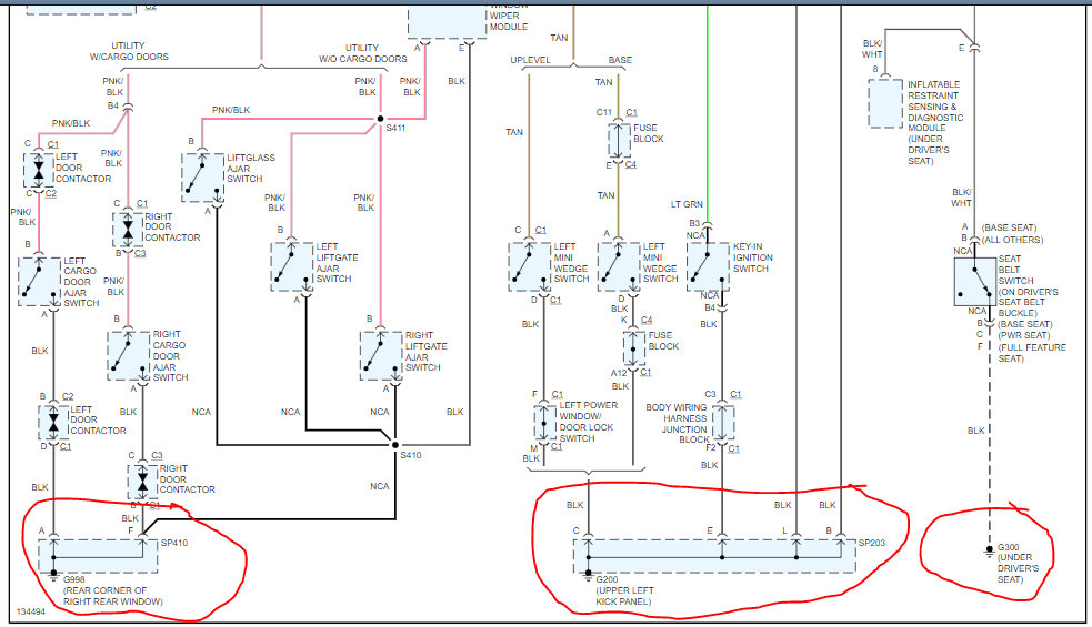

DANNY L
  • 5,648 POSTS
Hello again.
Sorry about that. Here are the 3 pictures of the warning light-instrument cluster. I've circled the 3 main grounds you should check first in red. Make sure they are secure, have proper contact, and are not defective in any way. Let us know what you find and keep us updated if you have ant further issues on this question or you need any other diagrams. Hope this helps and thanks again for using 2CarPros.

Talking about the rear corner of right rear window. Is it behind the paneling above the window or under the trim of the foot trim?

DANNY L
  • 5,648 POSTS
Hello again.
Yes, the ground will be located under the interior trim panel and will be located close to the floor area. Hope this helps and let us know if you have any further questions on this issue. Thanks again for using 2CarPros.
