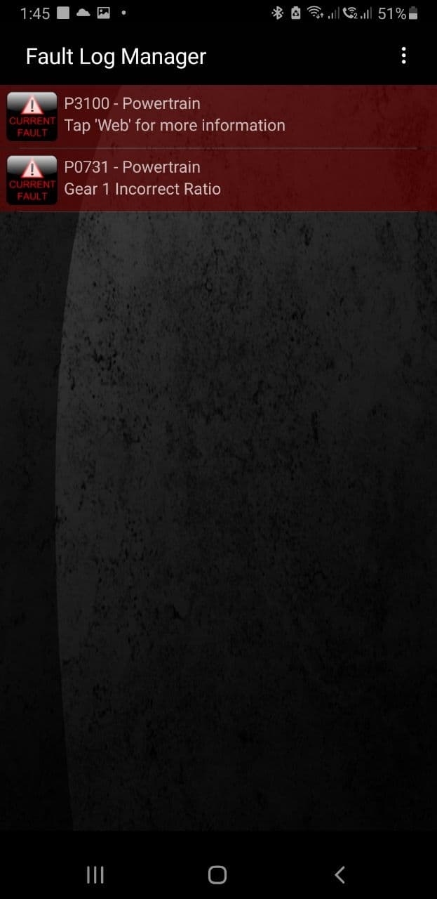

Yes, I have recheck via my wifi ELM327 v1.5 scanner using torque app on my android phone it show P3100 and another one is the old code that not yet been fixed properly.

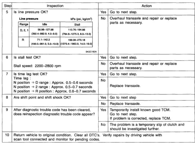

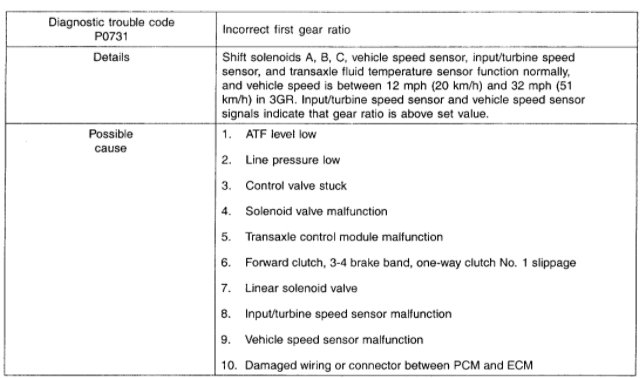

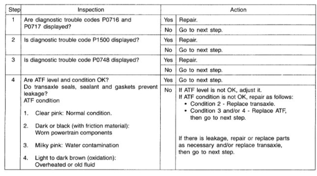

Okay, it shows on your code reader for the code P3100 you can tap for more information. If you can do that and provide a code description I might be able to match it with something I can find. I've attached diagnostic picture step below for your code P0731. Get back to us about the code P3100 information and we'll go from there. Hope this helps and thanks again for using 2CarPros.
Danny-

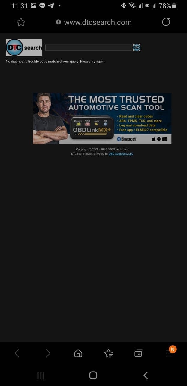

Thank you and sorry that i was not reply since than, because i got very busy to prepare thing for my customer. Today i have sometime, so i have check the P3100 link in the app it said "No diagnostic trouble code match found". kind of weird. so do you have any idea for that?
Thank you and sorry for taking very long to reply back.

For whatever reason that code doesn't exist on your car. I did send you repair guides for the other code P0731 that would affect your cars performance. Has anyone been able to check for you? Keep us updated what you find out. Hope this helps and thanks again for using 2CarPros.
