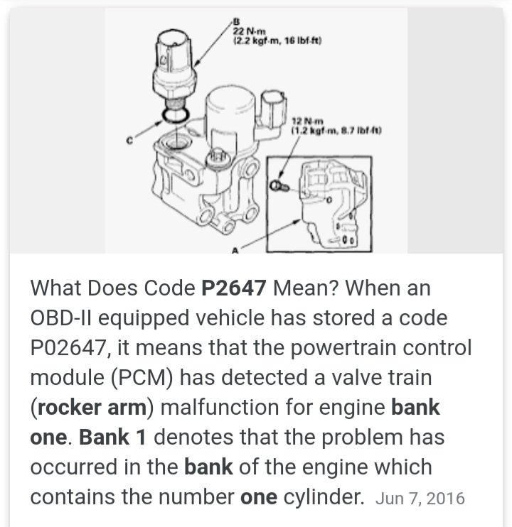

I got a code on my van p2647 rocker arm actuator stuck on bank 1.
I had changed the solenoid, gasket with the screen and switch as shown on the photo.
I changed oil and oil filter. Oil level is good where it needs to be. I then turned on the vehicle and drove for a good 2 to 3 hours. No engine light no VSA light. Then the next day both engine, VSA and oil light started blinking again. Oil level is still good. I reset and cleared codes and shut off the engine light. But came back again . Is there something else I can do? Is there another switch I'm suppose to check for bank 1 rocker arm or is the photo on I've attached the correct one?
Thanks in advance.

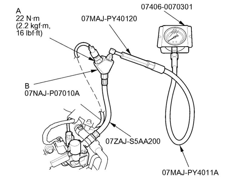

Good evening,

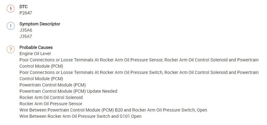

I attached the possibilities below and th flow chart as well.
What concerns me is the oil light. Your oil pressure may be too low for the system t work. You need to test the actual pressure with the engine at idle and at 3,000 RPM's.

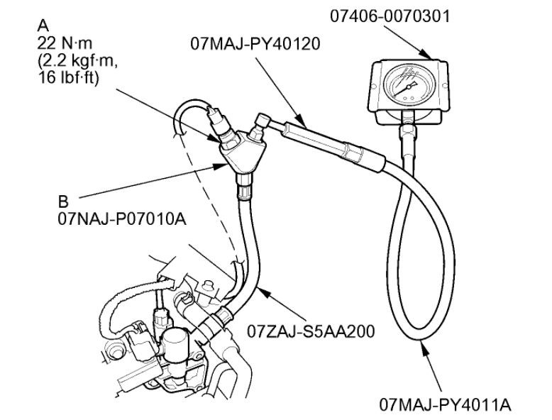

6. Remove the rocker arm oil pressure sensor (A), attach the special tools as shown, then attach the rocker arm oil pressure sensor to the oil pressure gauge adapter (B).
7. Start the engine. Hold the engine speed at 3,000 rpm without load (in P or N) until the radiator fan comes on, then let it idle for 2 minutes.
8. Check the oil pressure.
Does the oil pressure increase to 392 kPa (4.0 kgf/cm2, 56.9 psi)?
YES -
Replace the rocker arm oil pressure sensor , then go to step 9.
NO -
Replace the rocker arm oil control solenoid , then go to step 9.
