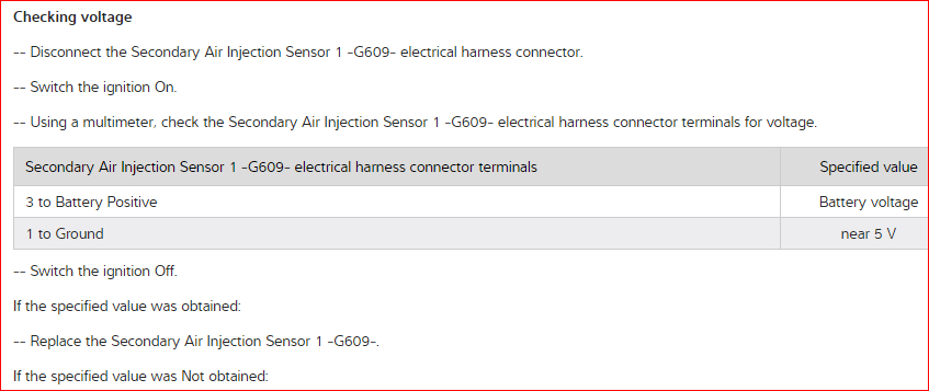

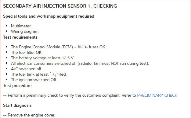

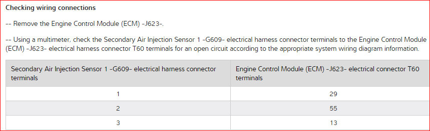

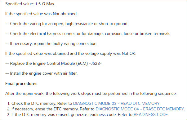

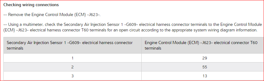

My CEL came on and is showing a p2431 code ( via Autozone) which they say is a secondary air injection sensor. The car idles at 1,400 rpm's at start up for sixty seconds, but runs fine. I have had issues with the secondary air system for several months. Eleven months ago I replaced the combi valve and no CEL. A couple of months later the CEL returns and I replace the PCV and no CEL. The CEL is on again. Is the P2431 a generic code or when it specifically mentions the secondary air injection sensor. does that mean it should be replaced?
Dec 27, 2018 at 8:28 AM
DANNY L
  • 5,648 POSTS
Hello, I'm Danny.
I've attached a few picture below showing a few things to check for you cars code P2431. Here is a link for a tutorial showing how to test wiring.
Hope this helps and thanks for using 2CarPros.
Danny-
