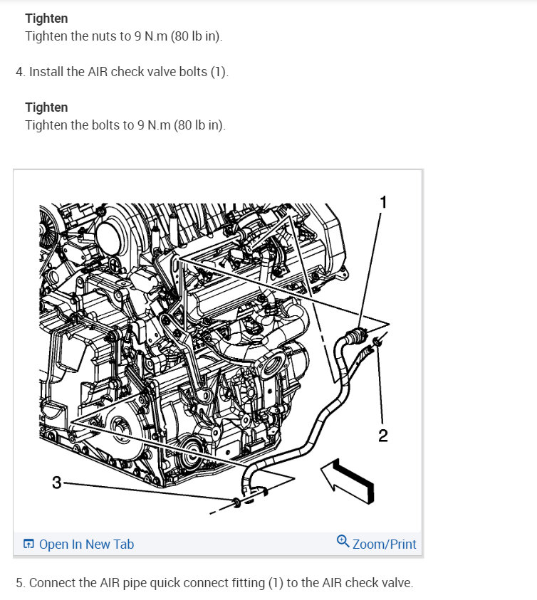

My question is regarding Replacement of a Secondary Air System Check Valve and Gasket
Part: GM #12619111 AC/Delco #214-2301 Secondary AIR System Check Valve
AC/Delco 219-600 Secondary Air Injection Pump Check Valve Gasket

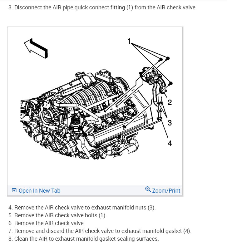

After removal of gasket - Factory Manual "Clean the AIR to exhaust manifold gasket sealing surfaces"
How should it be cleaned? Wire brush?
Should the old gasket be used or a new one?
(In post above, old gasket reused.)

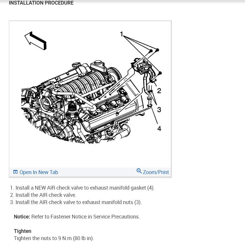

Exhaust seal epoxy:
When seating the gasket - "thin bead of exhaust seal epoxy on the gasket"
Should some type of exhaust seal epoxy be used?
If yes, what type should be used?
GM Sealant from Cadillac dealer parts?
Over the counter, there are so many brands and types.
While researching on the internet I ran across a YouTube video specifying that it important to use the right type suggesting damage if wrong type used.
Should the gasket be re-seated with a "thin bead of exhaust seal epoxy on the gasket"?
Any other suggestions are also welcome.

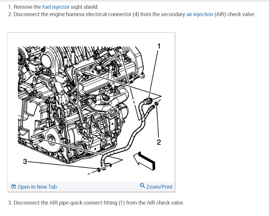

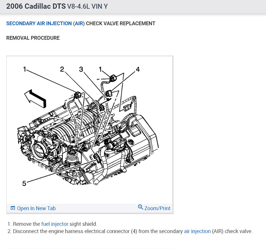

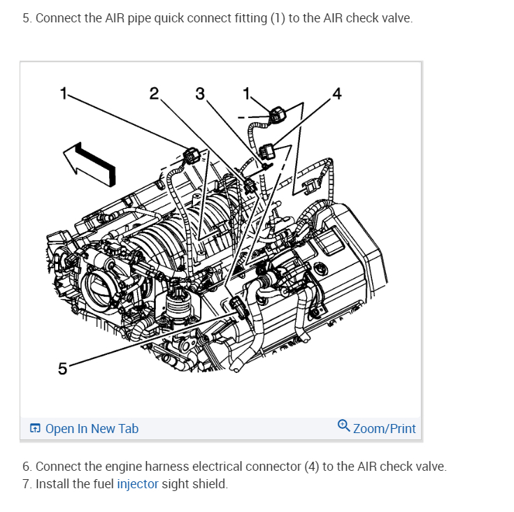

P2431 - Secondary Air Injection System Air Flow/Pressure Sensor Circuit. So, in the repair instructions it does not say anything about the sealer, but I would say use the GM brand it tends to be better, here are the instructions on how to replace the valve in the images below. Check out the images (below). Let us know what happens and please upload pictures or videos of the problem.
