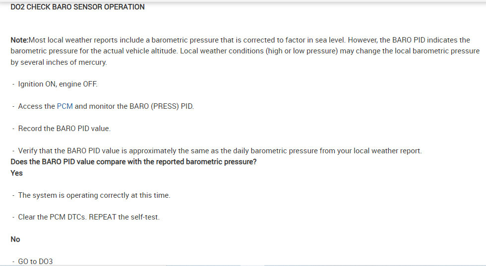

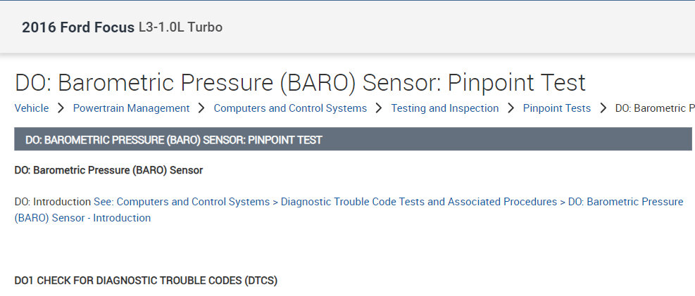

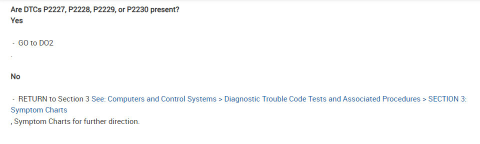

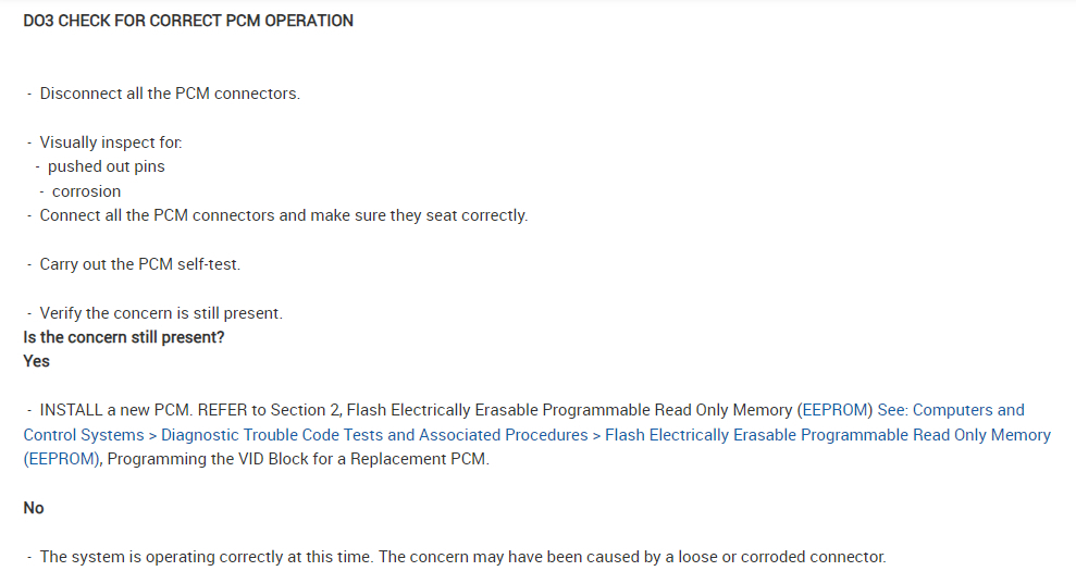

They hid this one. The barometric pressure sensor isn't serviceable. It is integral to the powertrain control module (PCM). For vehicles without a BARO sensor and with a MAP sensor, the BARO value is inferred by the PCM based on the MAP value under certain operating conditions.
Is this the only code that is present? If so, take a look through the diagnostics I included below. Let me know if you are comfortable performing them. They do require a scan tool that can communicate with the PCM.
