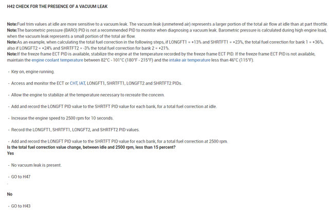

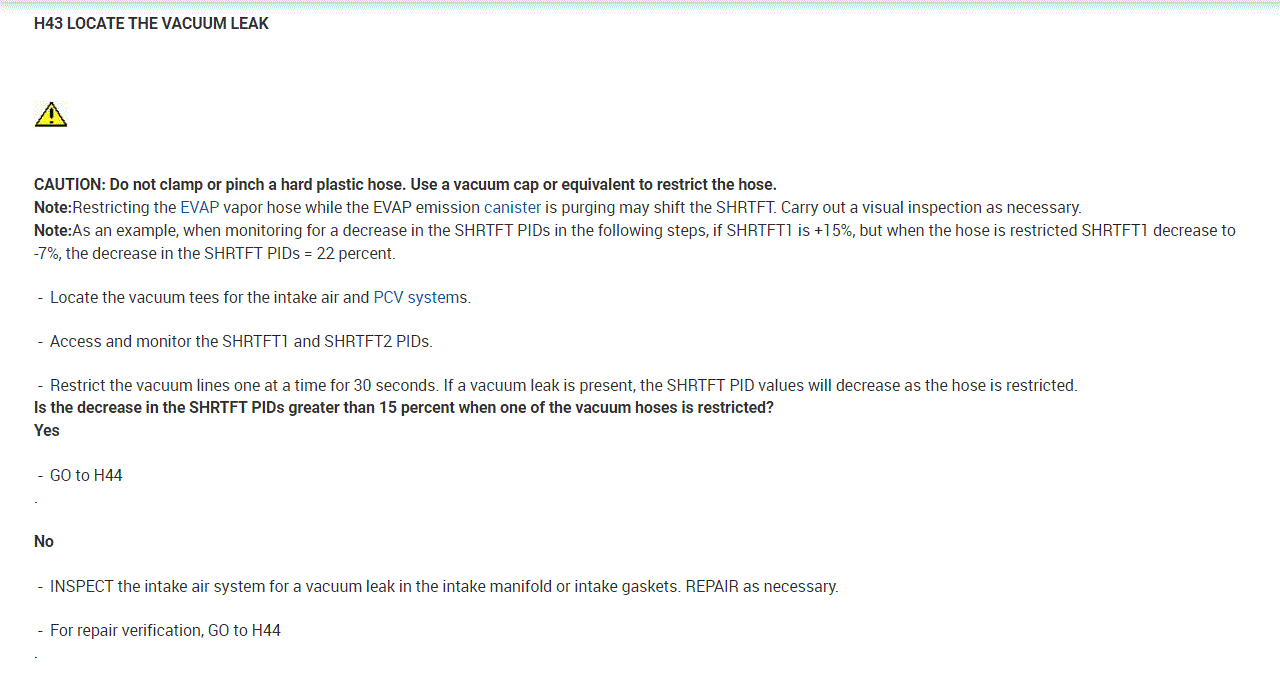

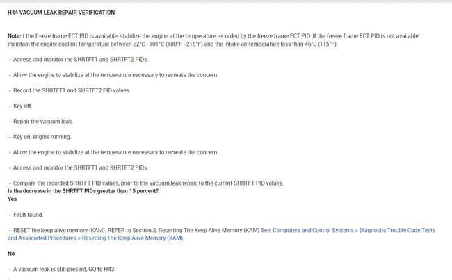

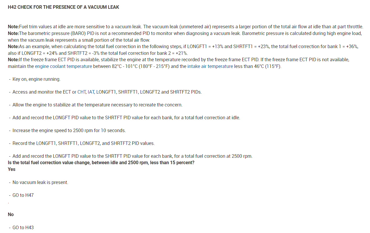

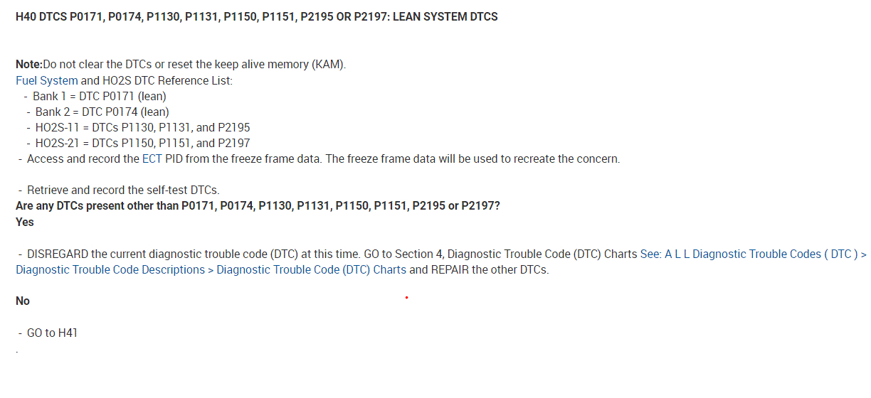

Is the P2197 the only code that is set at this time? It indicates a lean fuel mixture. I realize you checked for vacuum leaks, but I need you to try checking for leaks using carb cleaner. Follow the directions in this link:

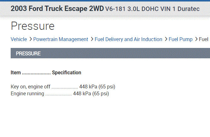

If there are no leaks, then check the fuel pressure to confirm it is within the manufacturer's specs. Here is a link that shows in general how it is done:

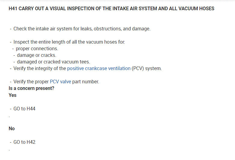

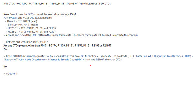

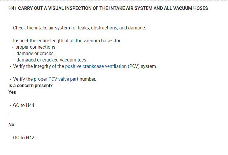

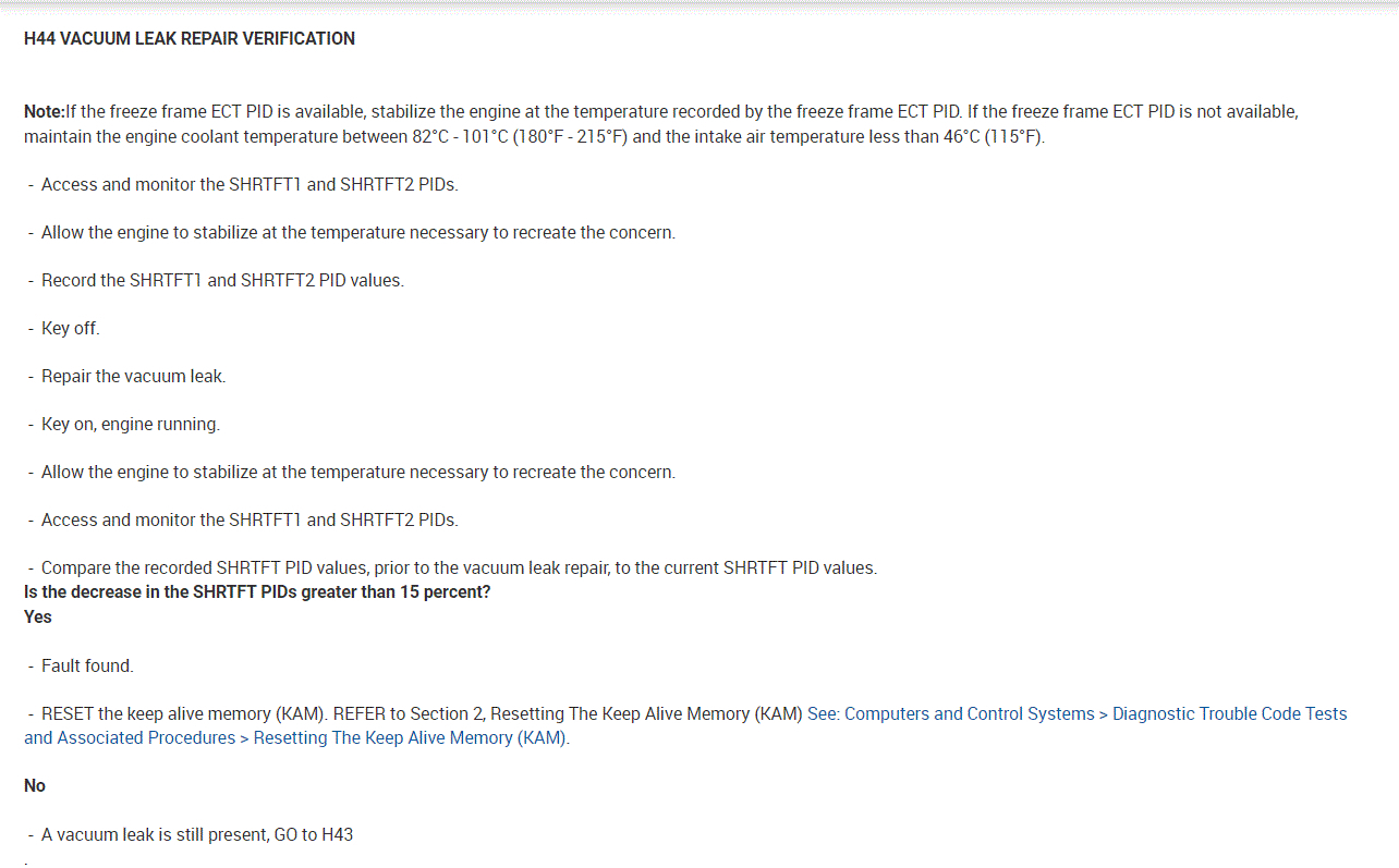

Take a look through the attachments below, They are the diagnostics specific to the code you indicated. You'll note much of it is what I suggested above and what you have done.
The last pic below provided the manufacturer's fuel pressure specifications. Confirm your vehicle is within the specs.
I hope this helps. Let me know what you find or if you have other questions.
Apr 16, 2021 at 8:32 PM
SMOKINGJOKER405
  • 9 POSTS
So I did all the above that you had recommended. There were no vacuum leaks at all. I also checked the fuel pressure it was within specs of the manufacturer.
