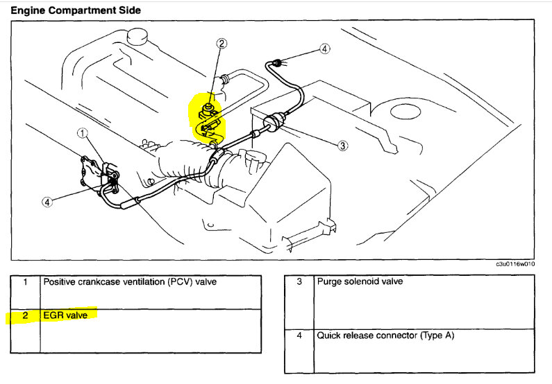

Based on the codes, it sounds like you have a vacuum leak. Have you checked around the EGR to check if the gasket is in good condition? If there is a leak, it could be causing a lean fuel mixture and limiting the amount of flow to the system.
I attached a pic below showing the EGR valve location. Confirm there are no leaks. Additionally, check around the different vacuum hoses for damaged, cracked, or disconnected hoses.
Here is a link that explains how to do it:
Let me know if this helps.
See pic below.

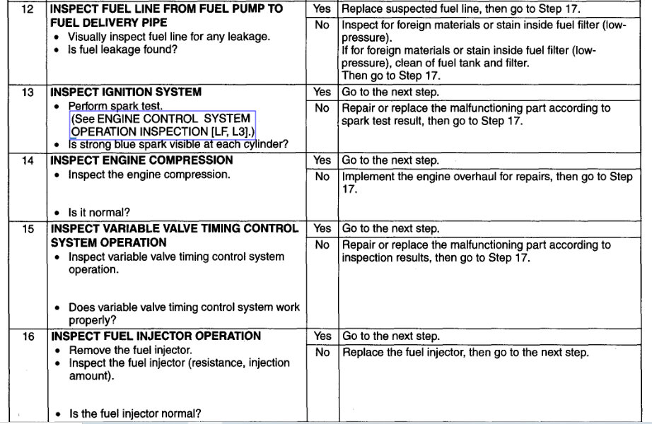

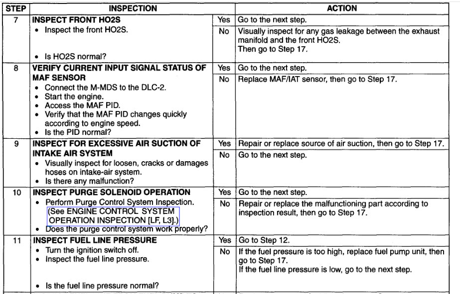

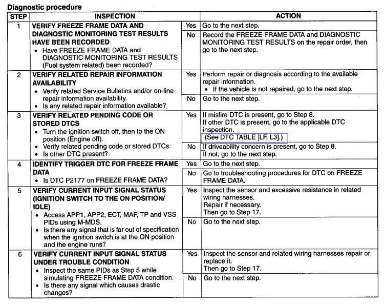

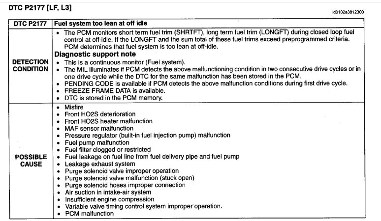

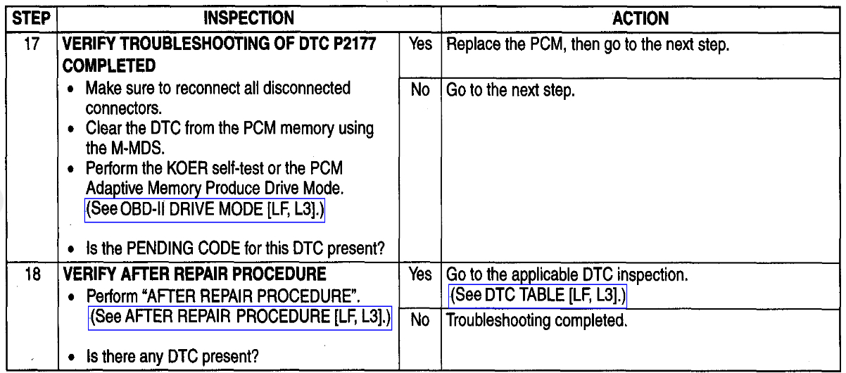

Since that was the first code to return, that is where we need to start. If you look below, I attached the diagnostics specific to the code. Take a look through them and let me know if this is something you are comfortable performing.
Sep 2, 2024 at 12:40 PM
